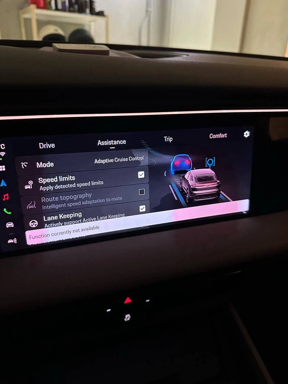

Innodrive - Route topography unavailable

Tried restarting and leaving the car and putting back in Drive but no luck.
Electric Macan EV Innodrive - Route topography unavailable tempImagermf4YR

Never tried with the car in park but I think that he has to get the gps signal to enable this option
True! Getting it out of the garage fixed it. Porsche needs to work on the error messages... It also gets disabled if no connectivity.

Yes it should be a better explanation of the error. But this is something software related and cable be fixed with an OTA update. I fear the hardware (sensors) hardware.
