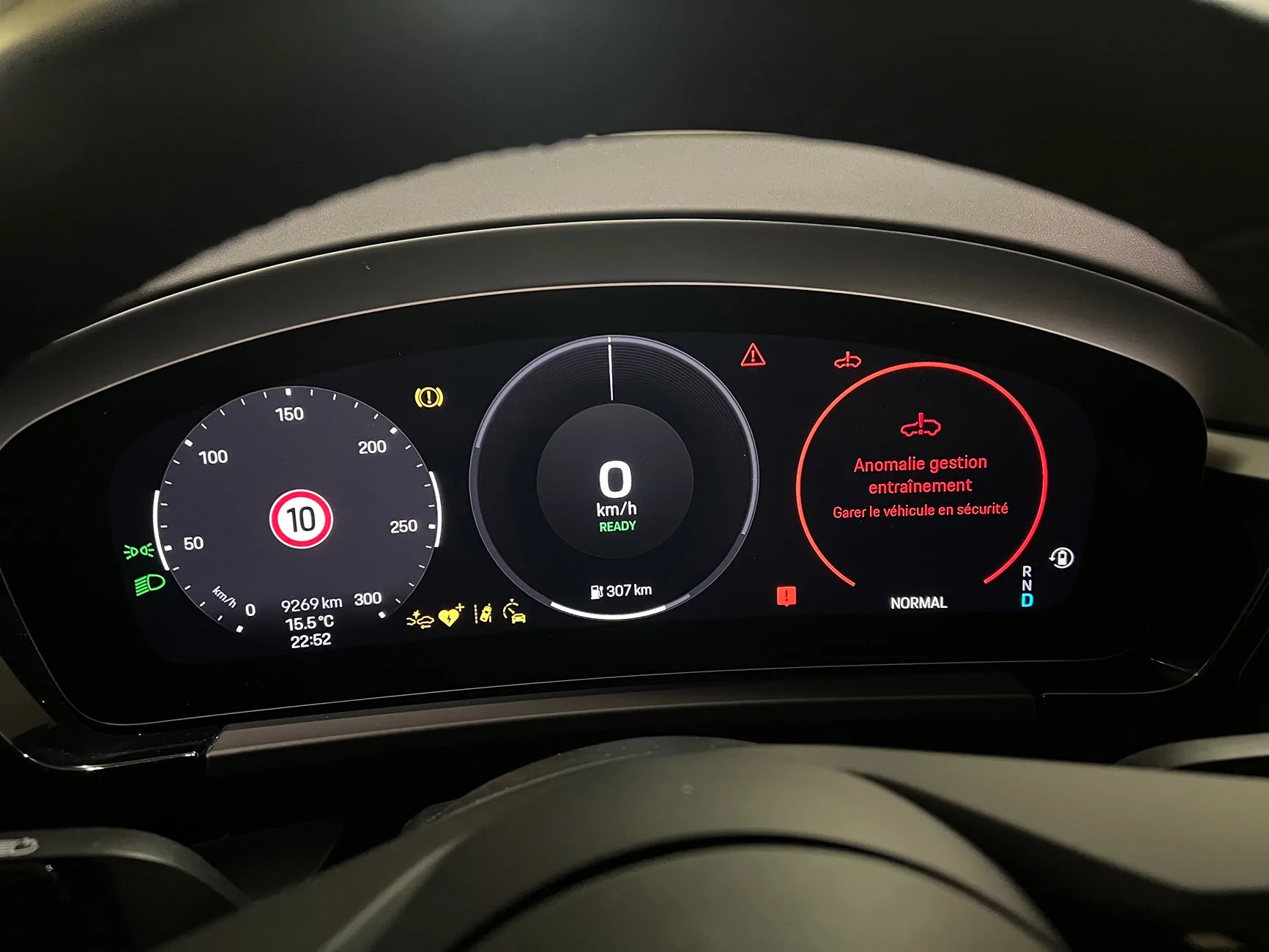

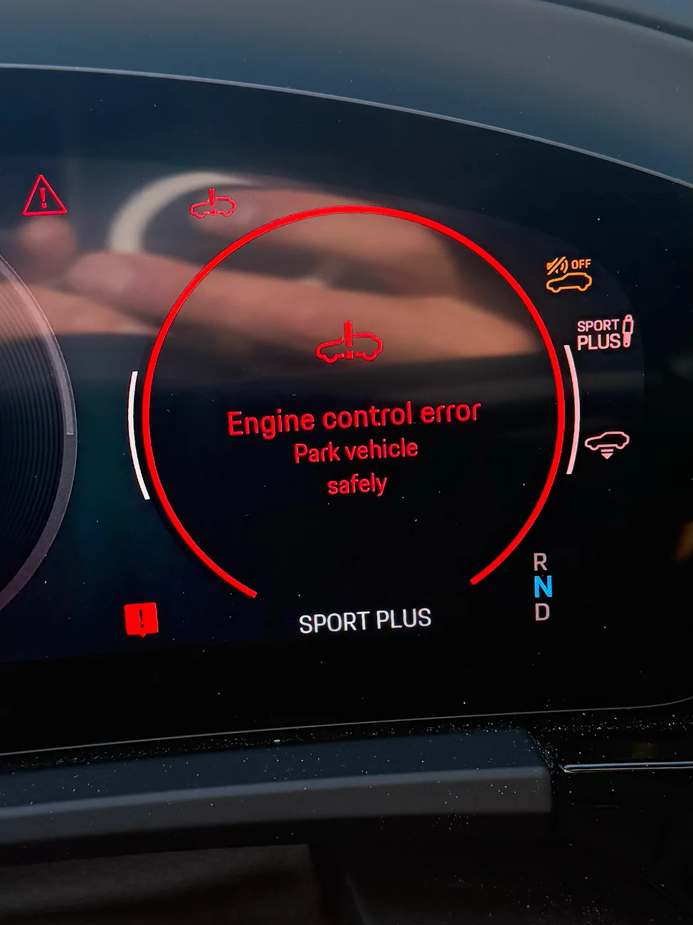

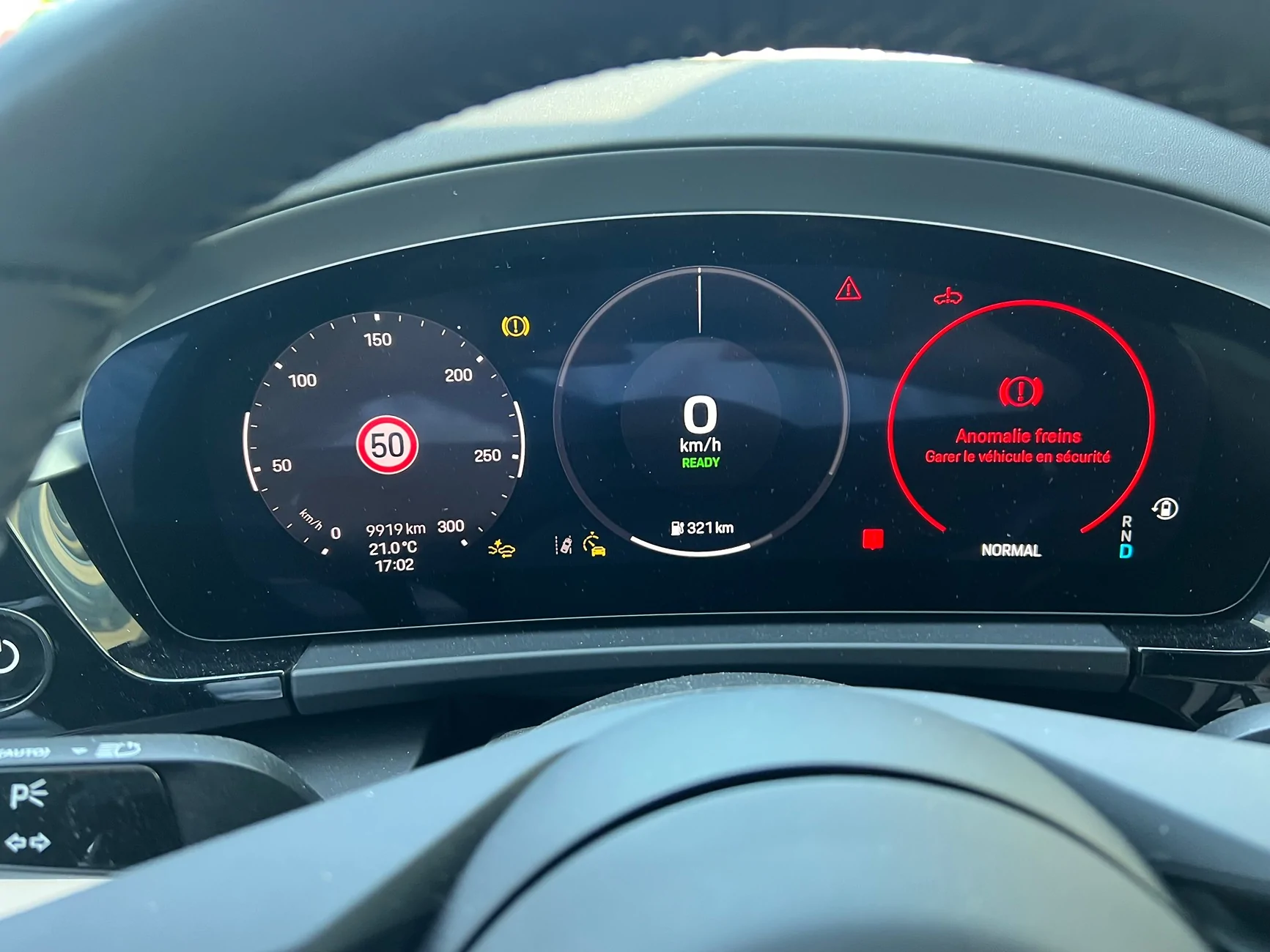

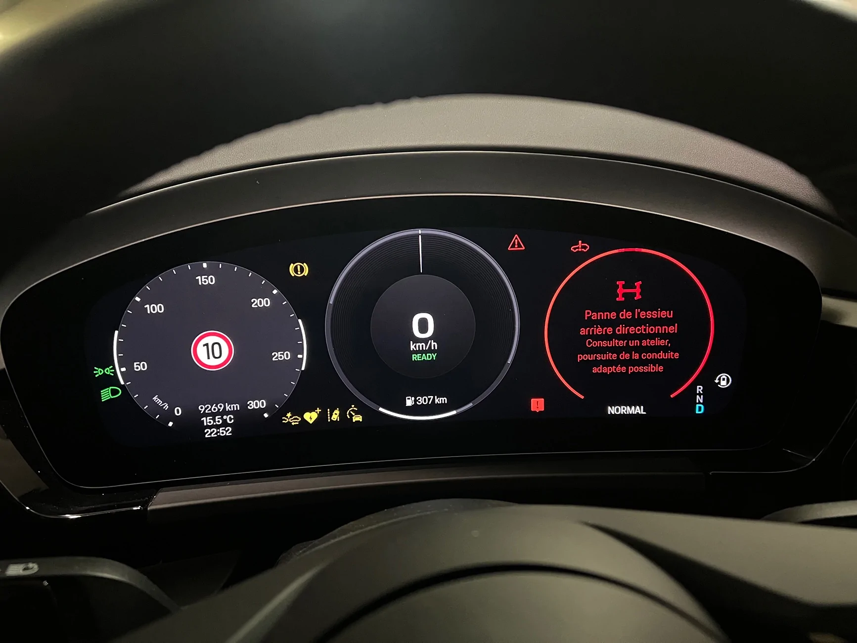

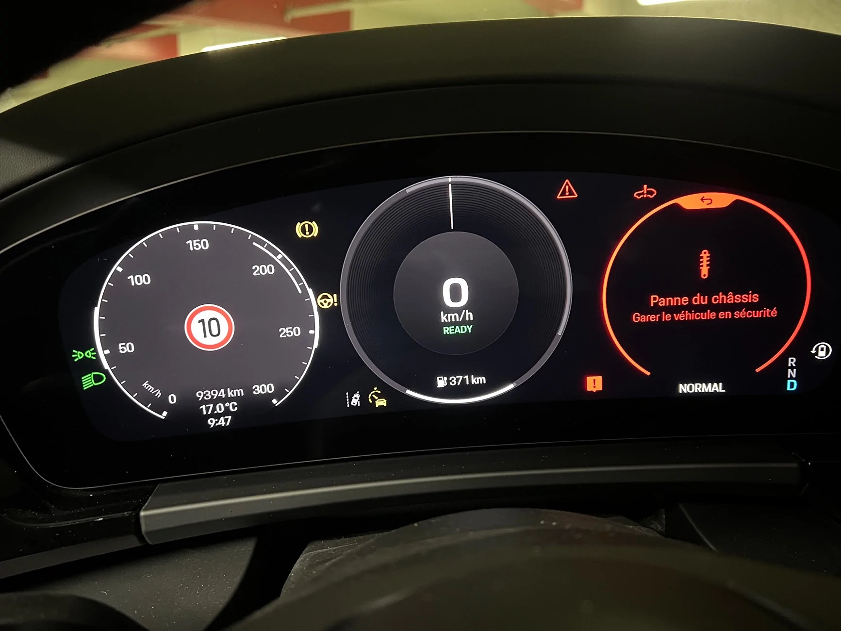

You likely have a 12v battery issue (or the electronics that provide the 12v to the modules). As the voltage drops, all the sensors start to enter undefined territory and emit random errors. 12v issues are the Achilles heel of cars these days, particularly EVs.
I had a similar issue and my Macan 4 EV, 2024 completely went black, locked up and died. Had to be towed to dealer. Became a Central Box CJ26 that runs the 12V batter to the electrical main battery issue. Would have cost approximately $7,000 (AI estimate) with labor. Had my car one week. Dealer would not give me a straight answer on actual cost, but good thing it's still under warranty and I'll trade in before the warranty runs out that's for sure.. I'm sorry this happened, I would have been frightened especially in remote areas where I live.
