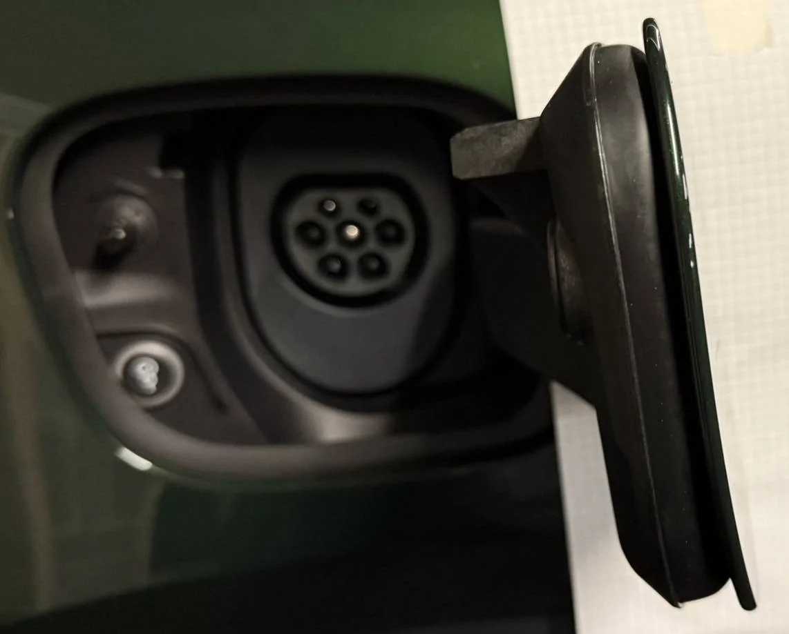

Well, I'm fairly sure that my door is concave - and that will be tricky to "tweak" onto the convex body panel.

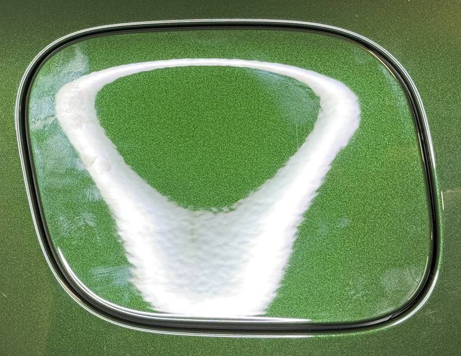

No.
There is no amount of enthusiastic screwdrivering (30 seconds or otherwise) that will fix this.
Because it is not an "alignment" problem. It is a "this part is the wrong shape" problem.
In fact, in two axes the fitment is quite good. It is the profile of the metal part of the component that is incorrect.

That image looks horrifying...is that white shape real or an optical illusion? I recognize that shape from X files.....Has your car been sideswiped by an Alien by chance? ;0
Electric Macan EV On the issue of charge port doors being misaligned… alien
Karl
Jan 11, 2025
Thames Valley
Macan 4S, previous Taycan RWD
Agree part is wrong shape. Looked at others in the opc car park, all the same. So either bad batch of flaps, or someone got it wrong

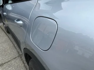

It’s delivery day and I’m at the dealer awaiting a final wash on my 4S. I did an initial inspection and, thanks to this forum helping me know what to look for, noticed that one of the charge port doors (manual, not electric) did not align well with the body. I drew this to the attention of my SA, and he had the techs take a look at it.
At this point, they think it’s due to the plastic clips to which the metal panel attaches. In support of this conjecture, they noticed that the panel is loose on the side that’s misaligned and not on the other (which is fine). To address this, they are ordering a replacement door assembly. I’ll have to come back to get that work done, but it’s nice to know there’s a good solution to a problem that others have experienced.

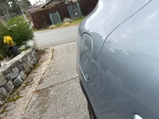

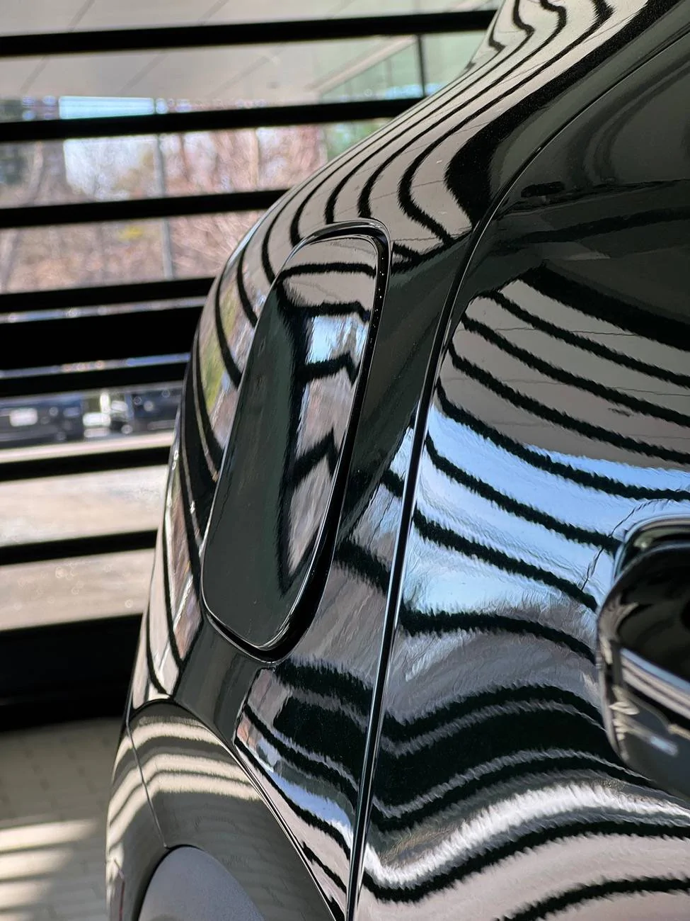

I paid a visit to my dealer today and they looked Into my flap door alignment...which basically looked like yours. Porsche has come out with a TI which entails removing the boot on the inside of the flap and adjusting 3 torque screws and a star wheel adjustment and bam...fixed. Took them about 1 hour. See pictures below as they are now perfectly flush!! Very happy.
This should be done at the factory
