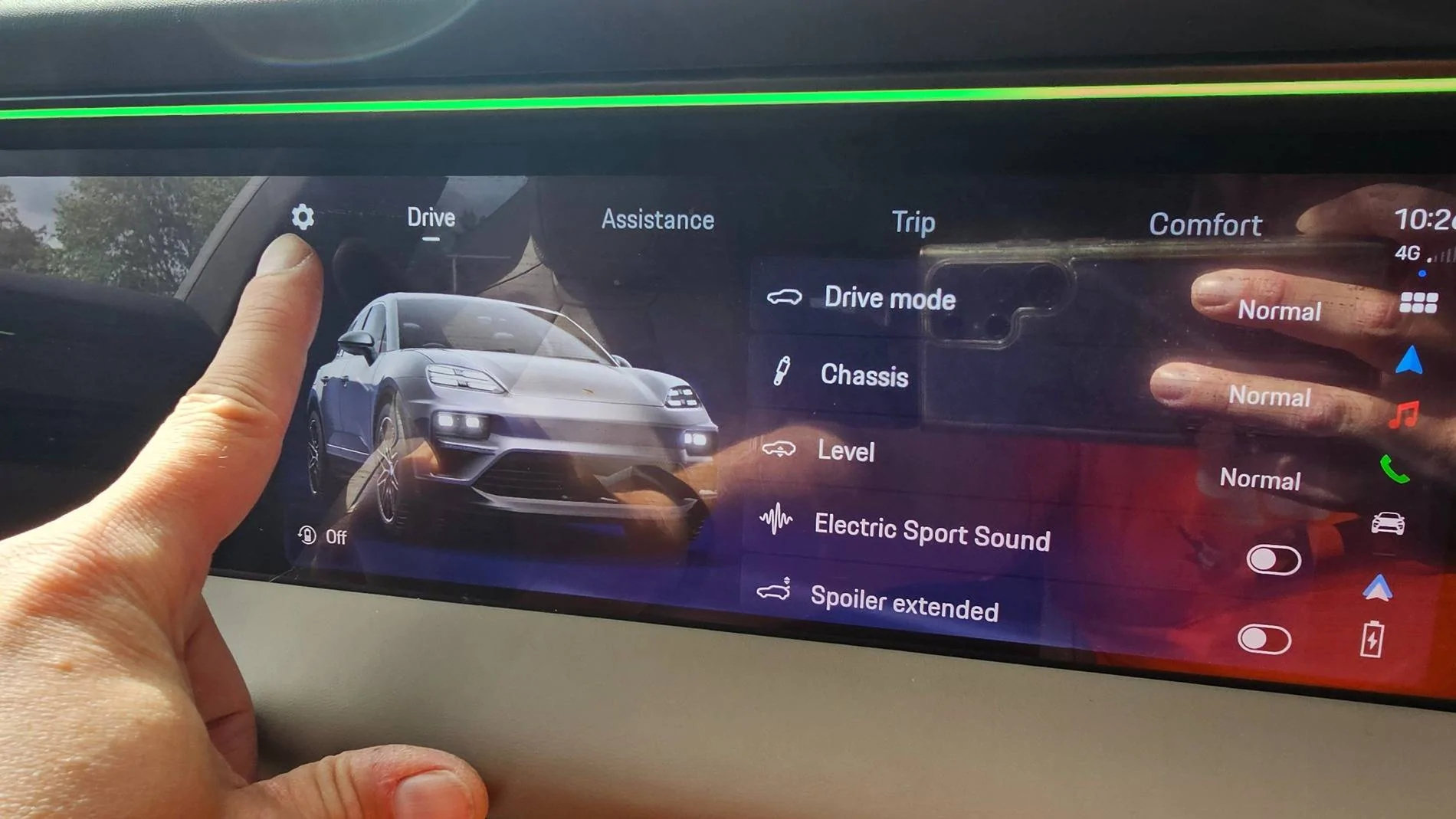

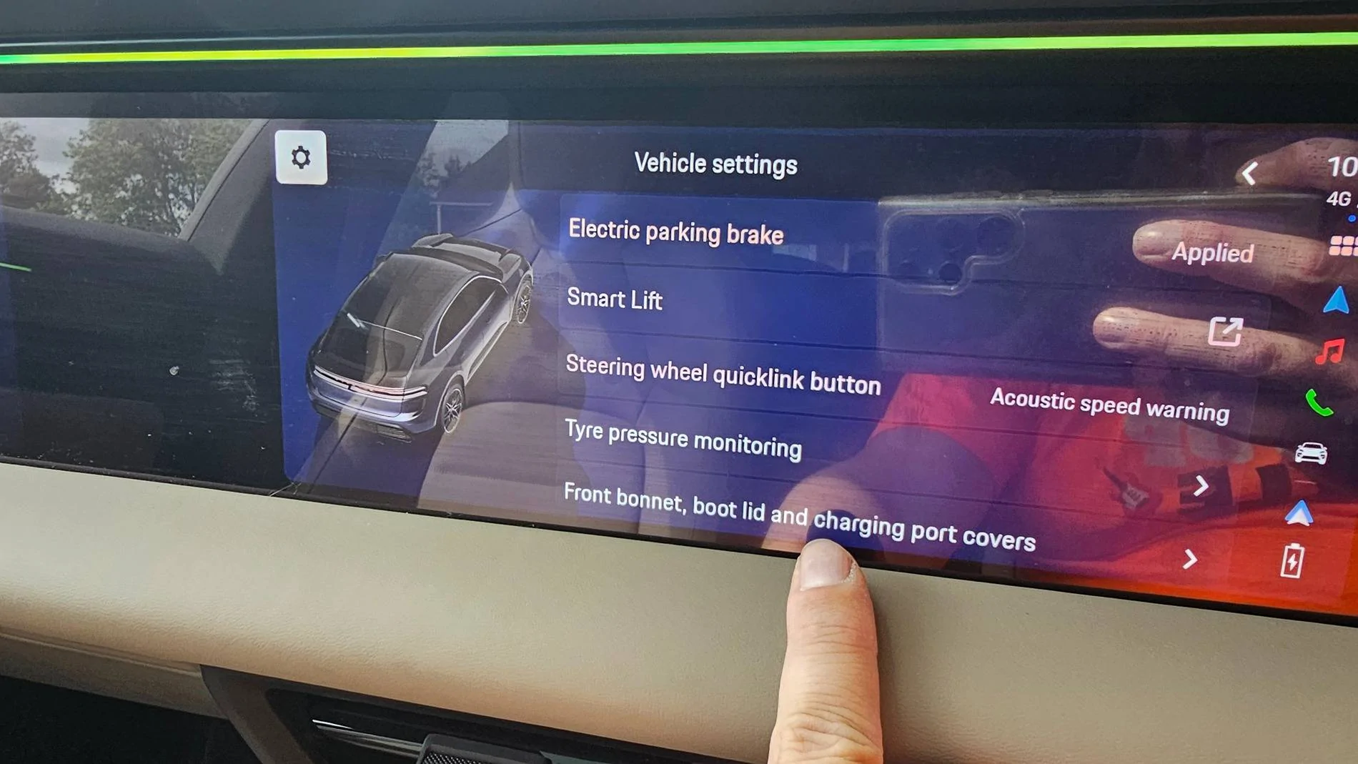

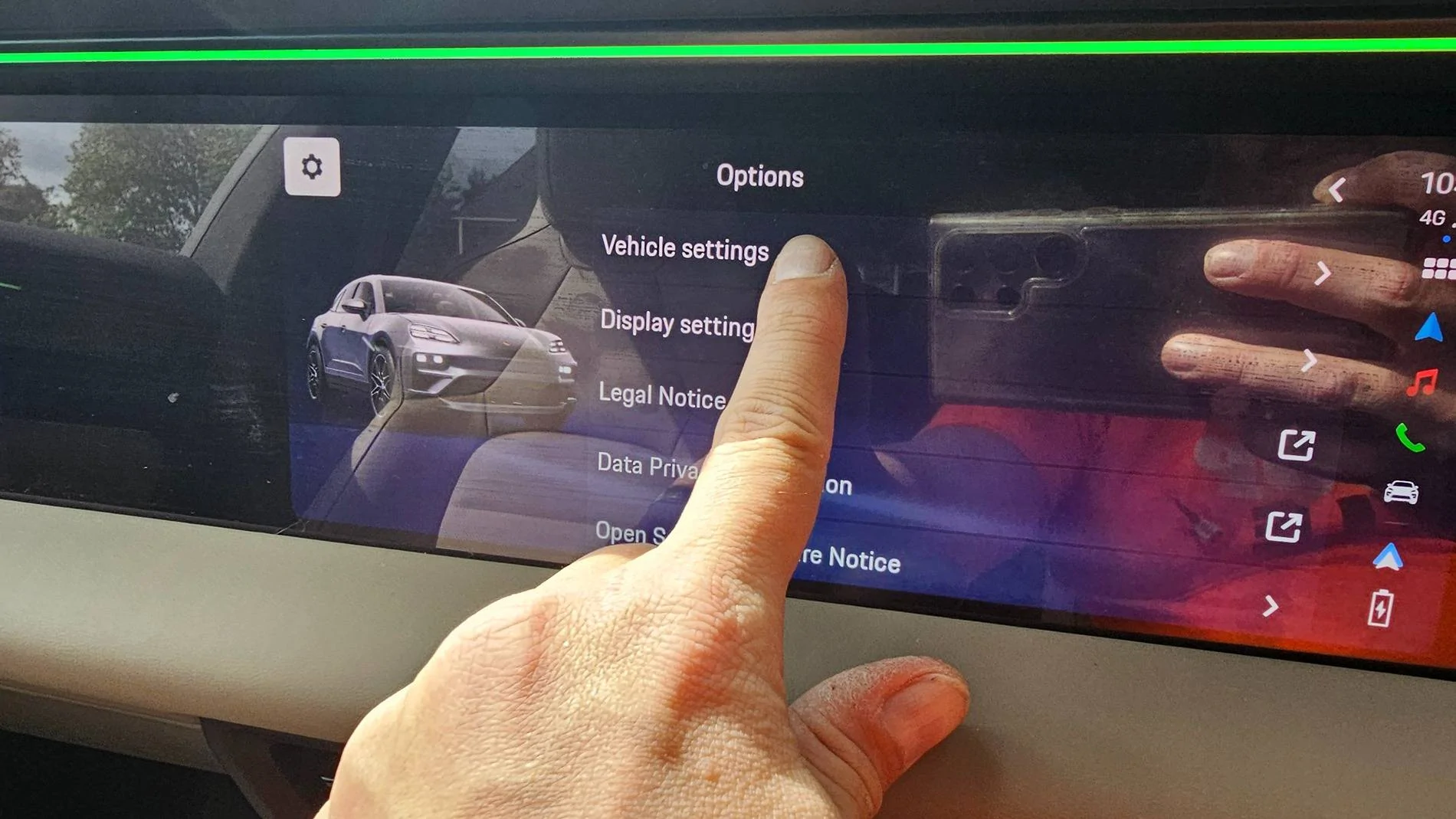

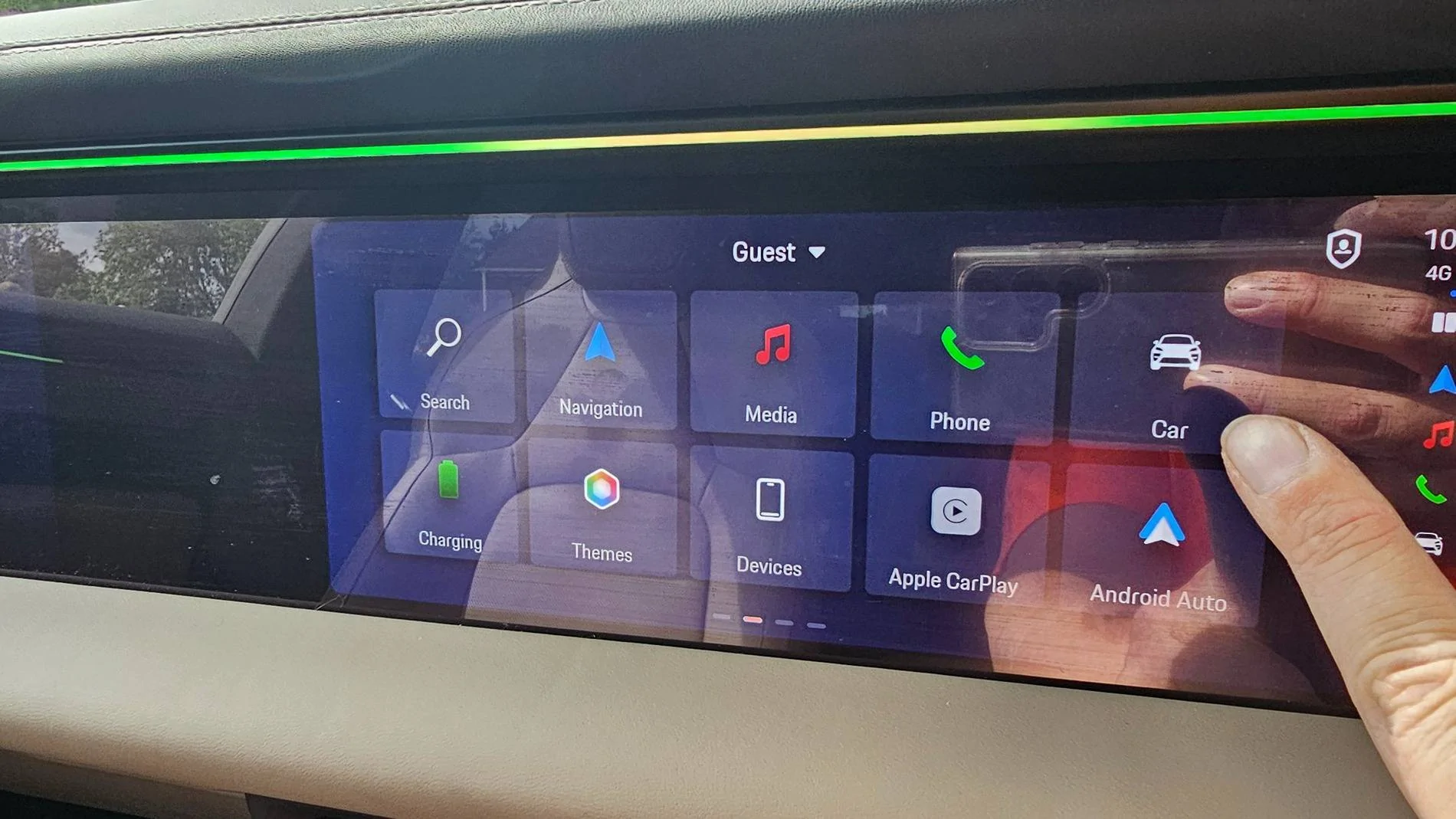

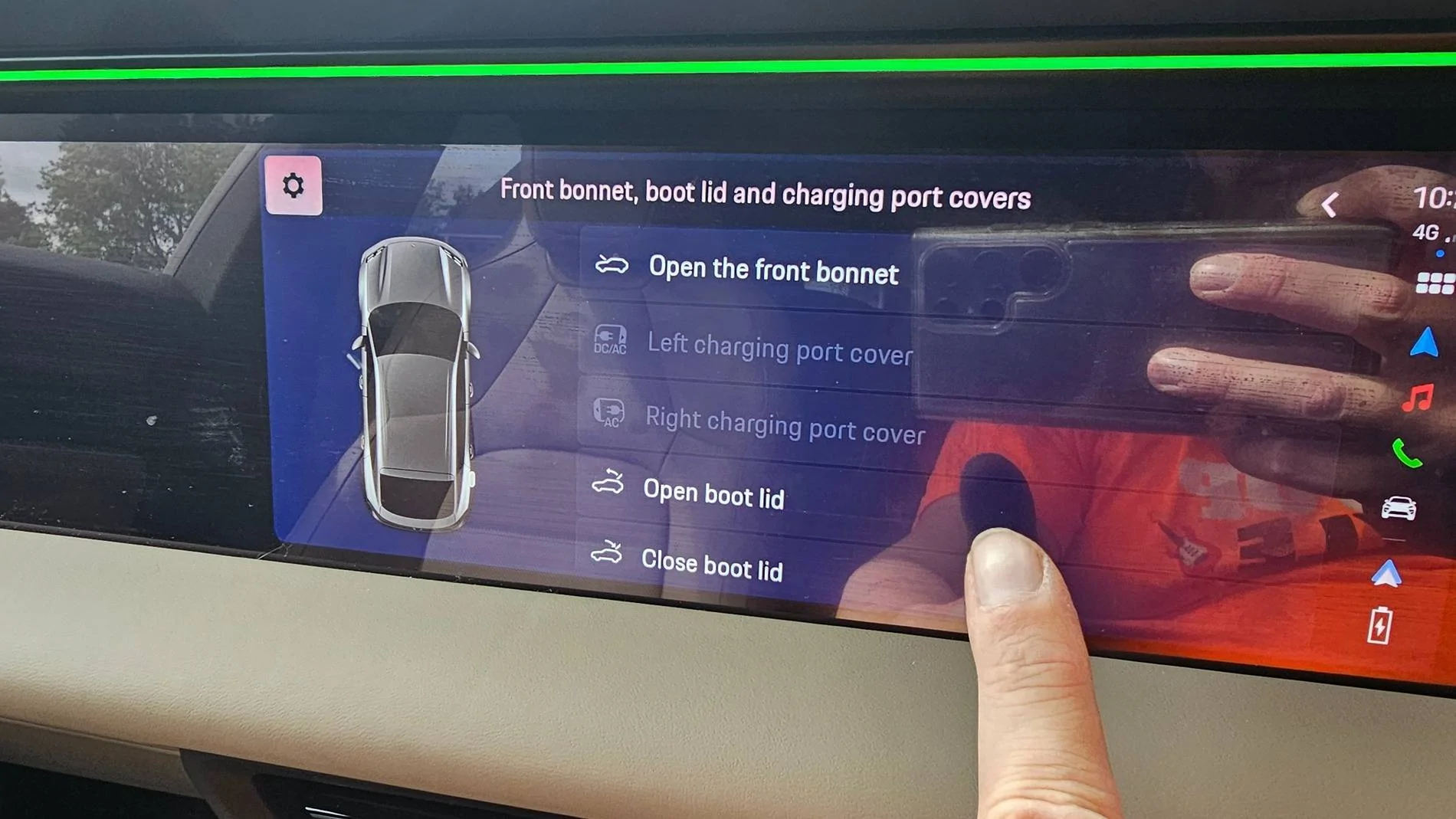

Please excuse the crude photos! But this is how to access charging covers...
Electric Macan EV Powered Charge Port Door - Be Careful 20250526_102635
Electric Macan EV Powered Charge Port Door - Be Careful 20250526_102645
Electric Macan EV Powered Charge Port Door - Be Careful 20250526_102651
Electric Macan EV Powered Charge Port Door - Be Careful 20250526_102655
Electric Macan EV Powered Charge Port Door - Be Careful 20250526_102703

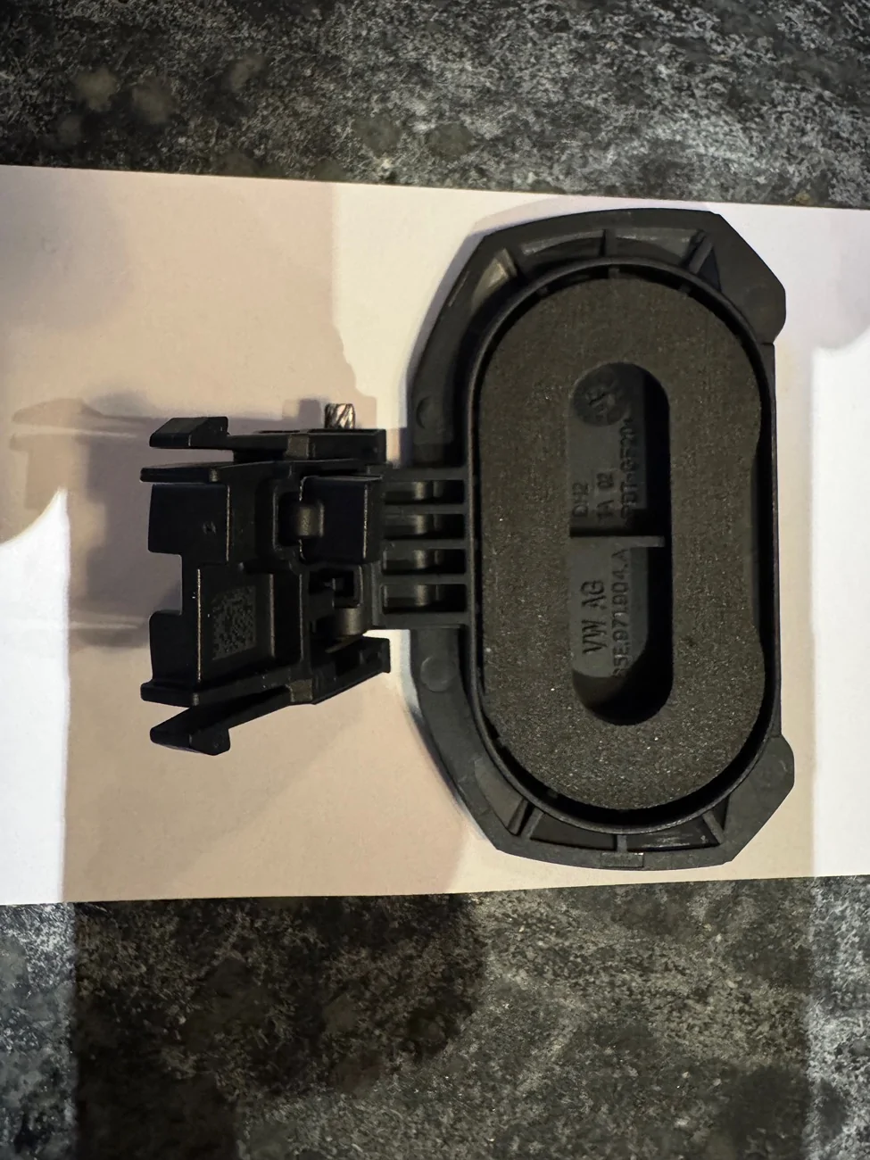

I finally got what I believe is the correct part. Photo attached. Any idea how to get the broken part out? It looks as if there are two tabs, one on each side, and a large upright movable structure/tab on the top. (By the way, part number is: PAD-971-904),
