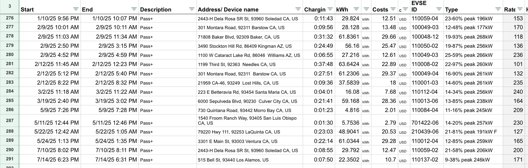

I realize this is a Macan forum, but to address one of my friend @daveo4EV criticisms on getting good speeds on 800v charging sessions especially EA I ask if I may use data collected from my Taycan ownership.
During my 5.5 years with the car and 105k miles I had recorded every charging session L2 (788 sessions) and DCFC (640 sessions). Filtering to only DCFC on EA I have 602 total sessions. Further filtering to sessions starting at 25% SoC or less (and removing sessions where starting SoC was not recorded) I have 276 sessions.
I recorded peak power only once my Taycan Inclusive plan ran out and the EA app showed Peak charging rate within the app in session history. That was a mere 16 sessions from 2025 and of those, 13 peaked at 200kW or better and 15 peaked at 190kW or better. Realize that this is on a 5 year old Taycan. Session details attached.
Electric Macan EV Plug & Charge now available for Tesla Superchargers via Porsche Charging Service IMG_0195
Now of the remaining 260 sessions I do not have a recorded peak but only a percentage range and kWh and duration to the minute. Excluding sessions where ending SoC was over 70% so that looking at average charging speed is relevant this yields 127 sessions and of those 76 sessions averaged over 150kW and 40 sessions averaged over 175kW. Note that the 40 sessions were across 18 different EA locations in 6 different States.
I am sorry that Dave has such consistently poor success getting good charging sessions. I have had many derated sessions and some cold batteries but at least 75% of the time I did well charging at 1000V capable EA chargers.
I will happily use other CPO’s thousand volt chargers now that there are so many options. I will use Tesla SCs if I’m stuck.

@ron_b knows I love me some data!!! good job Ron - wow you've had much much much better luck with 800V sessions than I have…but you also have more detailed data…maybe it knows you're watching!!!!
I'll dig into the data in a bit - I don't think it's the compelling case you think it is…
this Taycan data is impressive
77
1,579
2,499
hmmm trying to get to a summary
TLDR; out of 602 EA 800V sessions across more than 5 years - less than 3% of the session were 800V "optimal" (200 kW and above) - and only 7% were 800V "beneficial" (175 kW and above) - a whopping 93% (559) of EA sessions were not statistically/significantly faster than a run of the mill 150 kW charging session…​
93% of the time 800V did not matter - 559 out of 602 charging sessions.​
I show my work below from the data set…
the facts from the data…
  • 640 FastDC charging session (impressive)
  • 602 session on EA
  • once you filter for sessions that are less than 25% SOC (the ideal candidate sessions) - we arrive at 276 session that "could be ideal candidates" for 800V charging advantages - that means already 326 sessions or 54% of the total charging sessions 800V doesn't matter or the potential "win" is inconsequential because of the high SOC and impact on the charging taper curve…
initial conclusion from the data presented:
276 (possible fast charging sessions) / 640 FastDC sessions is 43% of your potential FastDC charging sessions would benefit from > 150 kw (if available) - less than 1/2 of the time you charged at a fastDC charging station
across 602 real world charging sessions more than 50% the time 800V charging would not and did not matter in the real world
let's continue…
of the 276 session - 127 sessions were "800V fast" (> 150 kW)…and only 40 sessions were "really fast" > 175 kW
76 of those sessions were greater than 150 kW - so 60% (76/127)
40 of those sessions were greater than 175 kW - so 31% (40/127)
but really we need to evaluate how often for any given FastDC 800V charging mattered…
the experience across 5 years is not just the 127 sessions that were potentially fast - it's how often did 800V charging matter across all the times you FastDC charged - and that number 602 FastDC charging sessions at EA…
so we need to evaluate how often you benefited from 800V charging rates across all your potential FastDC charging sessions…
for that we need to return to the original 602 sessions on EA (or 640'ish total FastDC charging sessions) - so the facts are:
  • 127 / 602 = 21% of the time you plugged into a FastDC charging station it "mattered" - the other 79% of the time any 150 kW fastDc charger would yield similar results
  • of the 127 "800V fast sessions" out of 602 real world trials - 40 were greater than 175 kW…
  • or 40 / 602 = 0.066 or about 7%
so across 602 sessions in 5'ish years - 7% of the time it mattered that you were plugged into an 800V station and achieved more than 175 kW charge rate - of all your sessions (and impressive number BTW) 93% of your charging sessions were less than 175 kW (for various reasons) and therefore barely faster than a normal 150 kW session…
less than 10% of the time did 800V charging achieve any significant benefit over nominal 150 kW/400V charging…if we define signficant as 175 kW charge rate achieved (and I'd argue this is not a bad cutoff) - below 175 kW any "gain" above 150 kW nominal is statistically insignificant and easily overwhelmed by trivial non-charging related delays
this entire analysis is also ignoring EA failure modes/problems which was not represented in the data presented - if we included any EA "issues" encountered across 602 candidate charging sessions I would suggest the data paints a less pleasant picture -it's hard to believe that in 602 sessions there were not some problems in some large number of those 602 trials…
across all 602 charging sessions 800V charging mattered/played-a-role 7% of the time…93% of the time similar charging sessions durations would've been achieved at a run of the mill 400V session…
and in that same data set "optimal" 800V charging was achieved 16 times…
16 / 602 =0.0266 or 2.6% of the time 97.4% of the time the charging sessions were sub-optimal due to the circumstances of the charging session…
93% (559 session out of 602) of the time 800V charging did not matter in 5 years across 602 "trial" charging sessions…
at least that's what the data is telling me…
bottom line across all FastDC charging sessions in 5 years and 602 EA charging sessions:
  • 2.6% (16) of the 602 charging sessions achieved optimal (200 kW or greater)
  • 7% (40) of the 602 sessions were "signficantly" faster or equal to 175 kW charge rate…
  • but a whopping 93% (559 times) of the 602 EA sessions were less than 175 where one could argue (and I am arguing) that a nominal 150 kW charging session would be inconsequentially different…
based on the date presented above 800V does not matter over 92% of the time…
9 of 10 charging session 800V optimal charging doesn't matter…this data also does not reflect "failed attempts' or "EA frustration" with problems, stations out of comission, the retry rate for actually starting a session - an interesting statistics would be:
"did it work" on the first attempt? because if it doesn't work on the 1st plug-in attempt then you've lost the 800V "advantage"…because the charge session retry eats into the 800V advantage time delta…​
the data also does not reflect the hand-shake start up time (which in my experince cant take up to 2 minutes at some EA sites before electrons are actually flowing)
but 93% of the time there was no advantage to 800V charging based on charge rate/speed actually achieved during the charging session…
the numbers get even worse if you include the "real" number of raw FastDC charging sessions (640)
I'll return to my mantra which is charging reliability - I, in my travels will optimize for "works the first time" plug it in - based on my experience EA is not that network - other options are more likely to work the first time you plug in - based on the data presented above from 602 real world EA charging sessions 800V charging did not matter 559 times - any old FastDC charger would have achieved similar charging session results - at that point in time any major time savings is going to be achieved by not having to "re do" the charging session - not the speed that will be achieved during the charging session - but reducing the overhead of getting a charging session started…
my conclusion from the data presented:
800V ideal/optimal charging session were achieved less than 3% of the time out of 602 charging sessions - I don't carry an umbrella with me if there is a 3% or less chance of rain…97% of the time you will not (or can not) achieve an optimal 800V session…I would suggest you plan accordingly and look for other potential characteristics that will elongate your time spent charging…for me that means trying to make sure the charging session will activate on the first attempt - in my experience this is the biggest time savings available to EV road warriors and heaven help you if you have the move the car to another stall…​
this is inline with my previous assertion:​
  • 602 session on EA
  • once you filter for sessions that are less than 25% SOC (the ideal candidate sessions) - we arrive at 276 session that "could be ideal candidates" for 800V charging advantages - that means already 326 sessions or 54% of the total charging sessions 800V doesn't matter…
initial conclusion:
let's continue…
the experience across 5 years is not just the 127 sessions that were fast - it's how often did 800V charfging matter across all the times you FastDC charged - and that number 602 FastDC charging sessions at EA…
800V ideal/optimal charging session were achieved less than 3% of the time out of 602 charging sessions - I don't carry an umbrella with me if there is a 3% or less chance of rain…97% of the time you will not (or can not) achieve an optimal 800V session…I would suggest you plan accordingly and look for other potential characteristics that will elongate your time spent charging…​
the 800V success rate (by way of an actual charging speed advantage delivered) represented by this data (602 actual EA charging sessions) I would suggest backs up my assertions.
all this being said…
it _IS_ enormously satisfying to see/experience 260 kW (or greater) charge rates with both my 2020 Taycan Turbo and my current 2026 Macan EV Turbo - I have achieved these "optimal" 800V charging sessions a handful times (4 times in my initial road trip after PECATL delviery of the Macan Turbo EV)…
that being said in my 5+ years with 800V EV's (Taycan and Macan) I've only achieved these glorious results a handful of times - with the vast majority of charging sessions meandering at 180 kW or below…sometimes significantly below.
but the potential charging speeds of 800V @ 270 kW or greater is simply intoxicating and when achieved makes the EV nerd/engineer in me sooooo happy and giddy…
I understand and sympathize with the aspirations of 800V charging - but OMG it is simply so hard to actually achieve it's almost not worth even trying…
I see the 800V/270kW (or more) charging statistics a bit like I evaluate Porsche's "ring time" benchmarks - these numbes are aspirational and do represent the technical capabilities of the vehicle. They are factual, and represent actual engineering and I have no doubt that the results are achievable and they can be used to evaluate if Porsche's latest offering is "better" than previous vehicles or better than competitive vehicles…
But these numbers are achieved in highly controlled circumstances and with professional drivers and the one successful result is never presented in the context of number the un-successful attempts (hint there are 100's of attempts for any given 1 ring lap time) - they are actual results that can be achieved. But that doesnt' mean I can go to the ring and achieve similar results - there are simply sooooo many variables both in and outside of my control that it's simply not feasible or practical to actual expect that sort of performance for any given trial…it just means it's possible under the right circumstances.​
my sincere hope is that 800V charging continues to improve in both reliability of activating a session but also in actualy delivering on the potential…we'll see how this plays out.
@daveo4EV I realize you are critiquing my filtering of the 602 EA charging sessions and I am open to that; however, I think you are miss reading or misinterpreting my kilowatt ratings.
  • Only the 16 sessions do I have high Fidelity peak speed values that I could share. Also, you can see my typical charing range as far as starting and ending state of charge.
  • For the remainder of the sessions, I had no peak values and for a vast number I did not have starting an ending percentages at all (as I did not record that until the middle of my ownership which I used to project battery capacity), thus I had to filter to 276 sessions. Note: The number of excluded sessions because they started over 25% SoC were a relatively small and I will concede that those sessions could’ve easily buttoned done at a 400 V unit for the Macan with no noticeable penalty in charging time.
  • As for 260 filtering to 127, this is not to imply that the excluded 133 sessions did not have a high peak speed, it is simply too attempt to extrapolate peak speeds by looking at average speeds. The charging rate when charging above 70% becomes highly throttled and thus I felt it non-meaningful to include that data. I can neither confirm nor deny the exploitation of 800 V chargers in those cases. I think it would be reasonable to assume that the percentages seen in other data would be indicative.
  • The 76 sessions (60%) averaging over 150kW is probably enhanced by 800v as realize as I’m sure you do Dave that the charging curve diminishes after 55 to 60% and thus to maintain a 150 kW average for sessions starting below 25% and going up to a maximum of 70% would typically yield peak speeds in the neighborhood of 200 kW.
  • The 40 sessions (31%) averaging over 175 kW is definitely enhanced by 800 V charging.
  • As far as how many minutes are saved on a session, though I can’t imagine doing the analytics necessary for at least the 16 sessions that I have more fidelity. It would be quite time-consuming. I think it would typically be between 5 to 10min. But when you’re doing a road trip and four charging stops in a day, I do want to minimize any delays.
  • I can’t comment on EA handshake time definitively as I do not log that, however my feelings are that it was about a 30sec average.
Reliability of chargers, I agree that I have seen many broken Electrify America chargers. I do not have personal experience with Tesla superchargers yet. However; watching the Out of Spec Studios eastern edge videos I see the number of times they get derated speeds and a few dysfunctional chargers when using Tesla Superchargers. So I don’t know where the grass is necessarily greener.
I am hoping for IONNA, MBHPC, and Walmart. They look to have reasonable pricing, decent amenities, and state of the art equipment.
