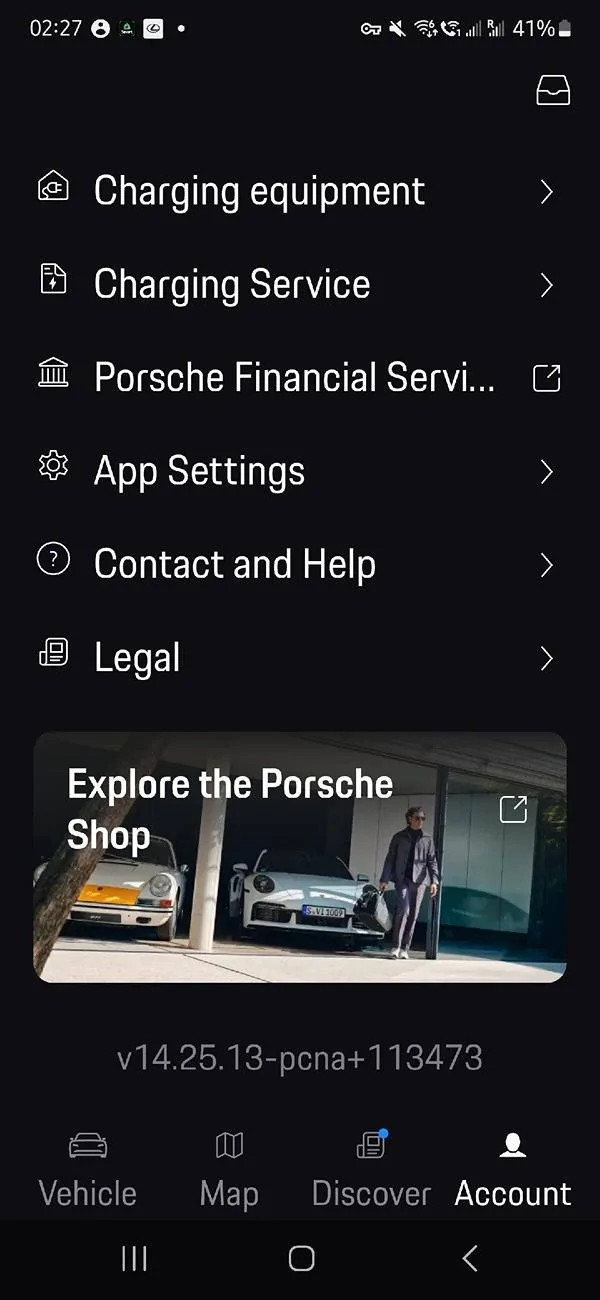

what app version? cuz i just charged yesterday with no issue...and i haven't had an update for maybe a week or two

Just opened up my Porsche app... There is an update. I'm currently headed out of town, but wanted to report the information.
Electric Macan EV Porsche app / Electrify America: Porsche acknowledged there IS A BUG in the latest release 1000017590

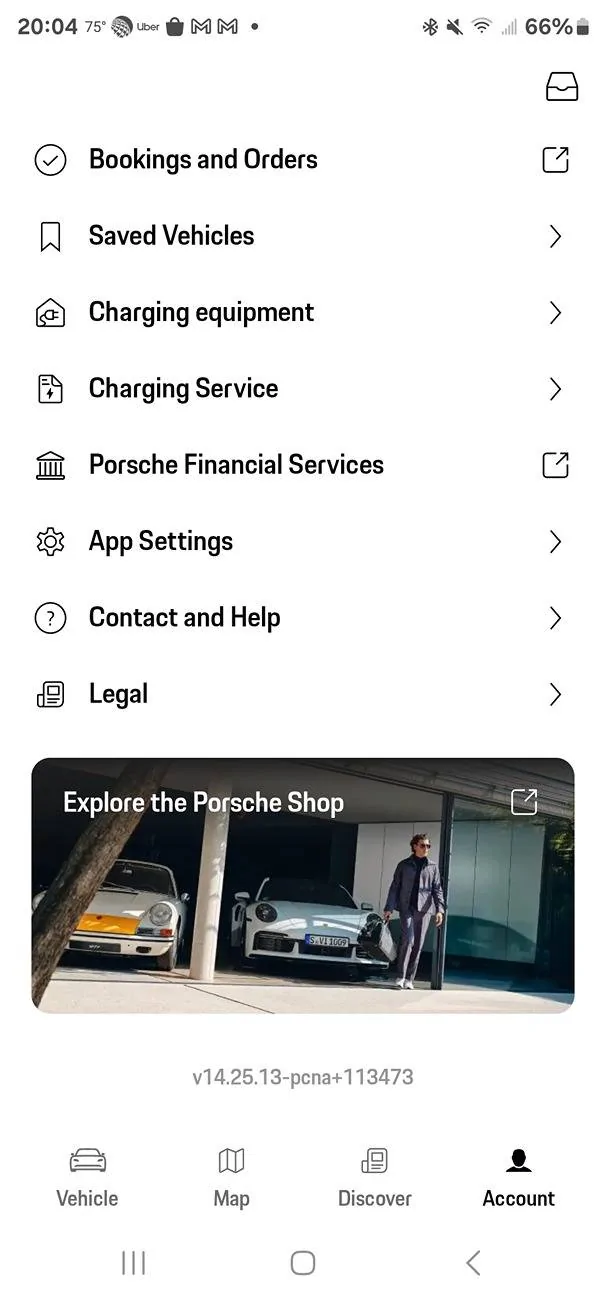

Mine latest update, I think was yesterday, Android.
Electric Macan EV Porsche app / Electrify America: Porsche acknowledged there IS A BUG in the latest release thumbnail
