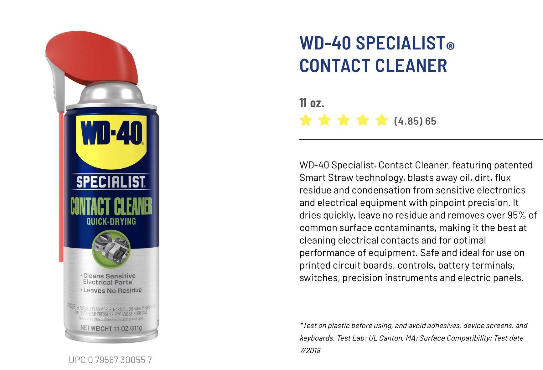

Just an update to this. I had two drives a couple of days ago where the "seat belt unfastened" warning was on the entire journey despite my seat belt being fastened. I bought a can of WD-40 contact cleaner from my local DIY store, and sprayed a generous amount into the female seatbelt buckle, and then fastened and unfastened the seat belt a few times. It immediately solved the problem and it hasn't come on since.
