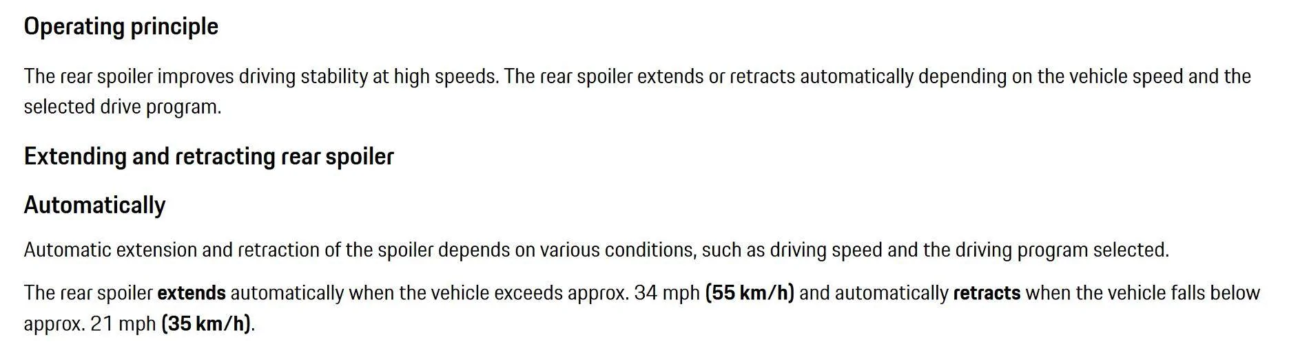

My turbo spoiler is confusing me. According to manual and what I have been reading it should automatically come up and down depending on speed of vehicle. The manual option of having it up is supposedly just to clean under it a guy online once mentioned.
However when I had it up for cleaning I noticed that it went up and down based on speed and stayed up when car is off. I turned it down I noticed it one time going up when I sped suddenly.
However on normal driving on the highway I didn’t realize it going up and down on high speed even though on high speed the car goes to lower height even on normal.
55
54
16 Macan Turbo, 20 Cayenne Turbo, 23 Taycan Turbo

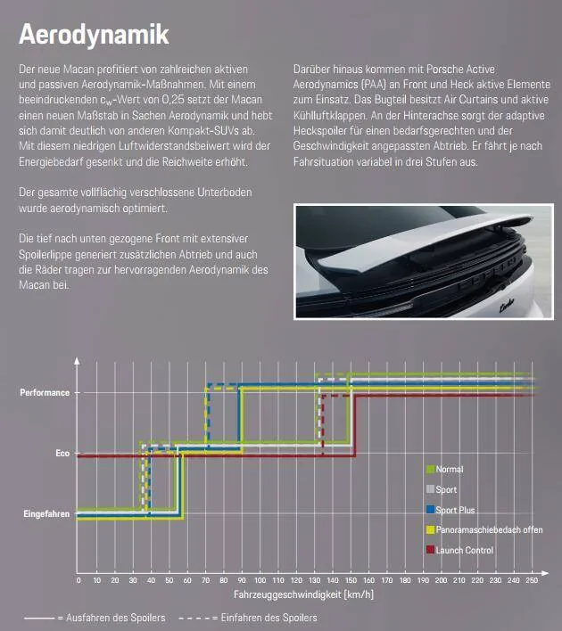

This is what the manual says but does not provide full logic under what speeds it extends or retracts in Range, Sport, Sport+ or Launch Control modes.
Electric Macan EV Spoiler confusing me 1730164163230-4m

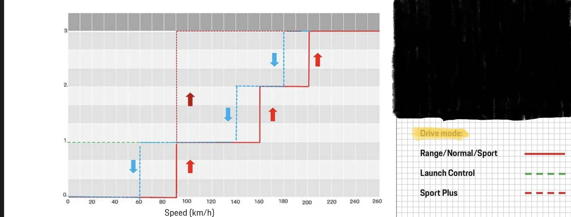

For example, this is spoiler logic for Taycan that is much more complicated since it has 3 height levels when extended.
Electric Macan EV Spoiler confusing me 1730164493209-vy
