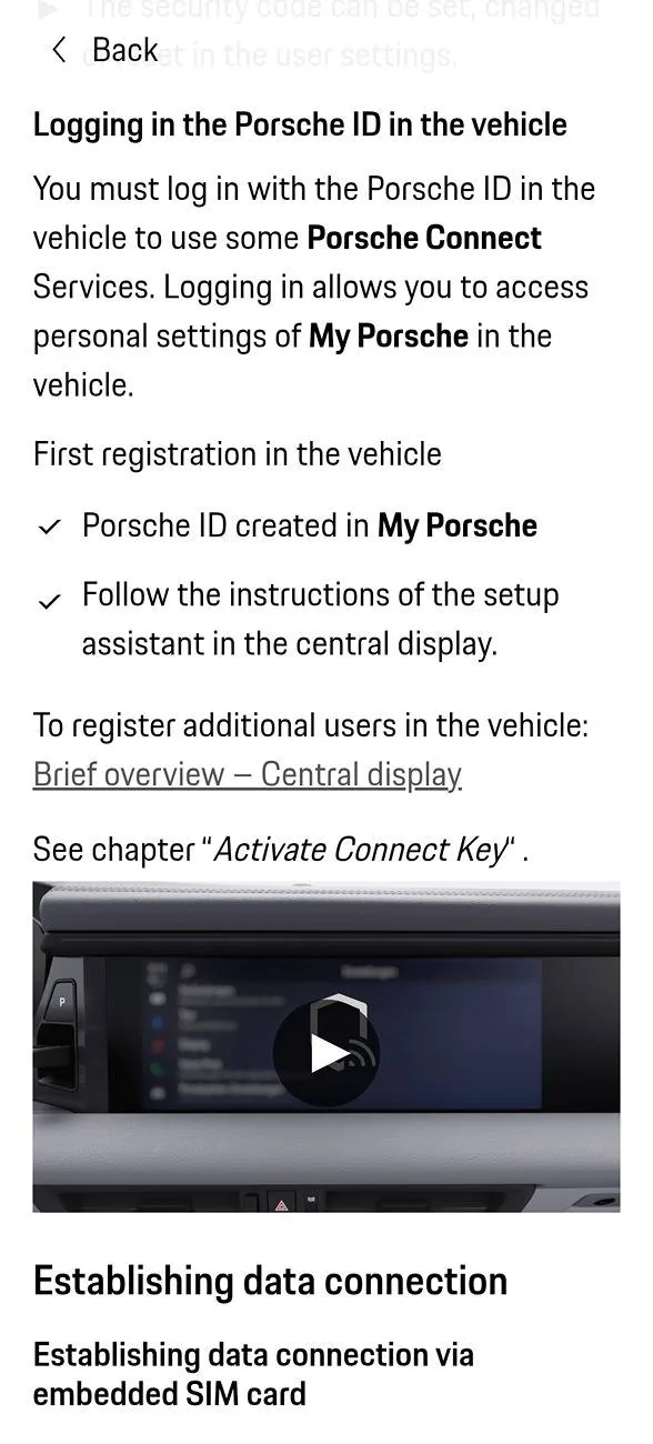

Yep, pretty straightforward to do.
As already mentioned-
Once you have your IDs created, unlock the car with the first fob, select the account you want to log into the PCM with the exit and lock the car with the same fob.
Repeat the process with the other fob using the 2nd ID.
This ought to have been explained during handover.
Dealer knowledge can be woefully poor.
Some guidance in Owner's Manual too.
ICE Macan works similarly and Taycan the same as Macan EV.
