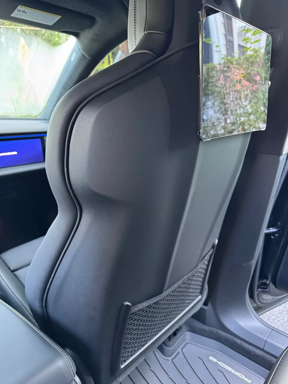

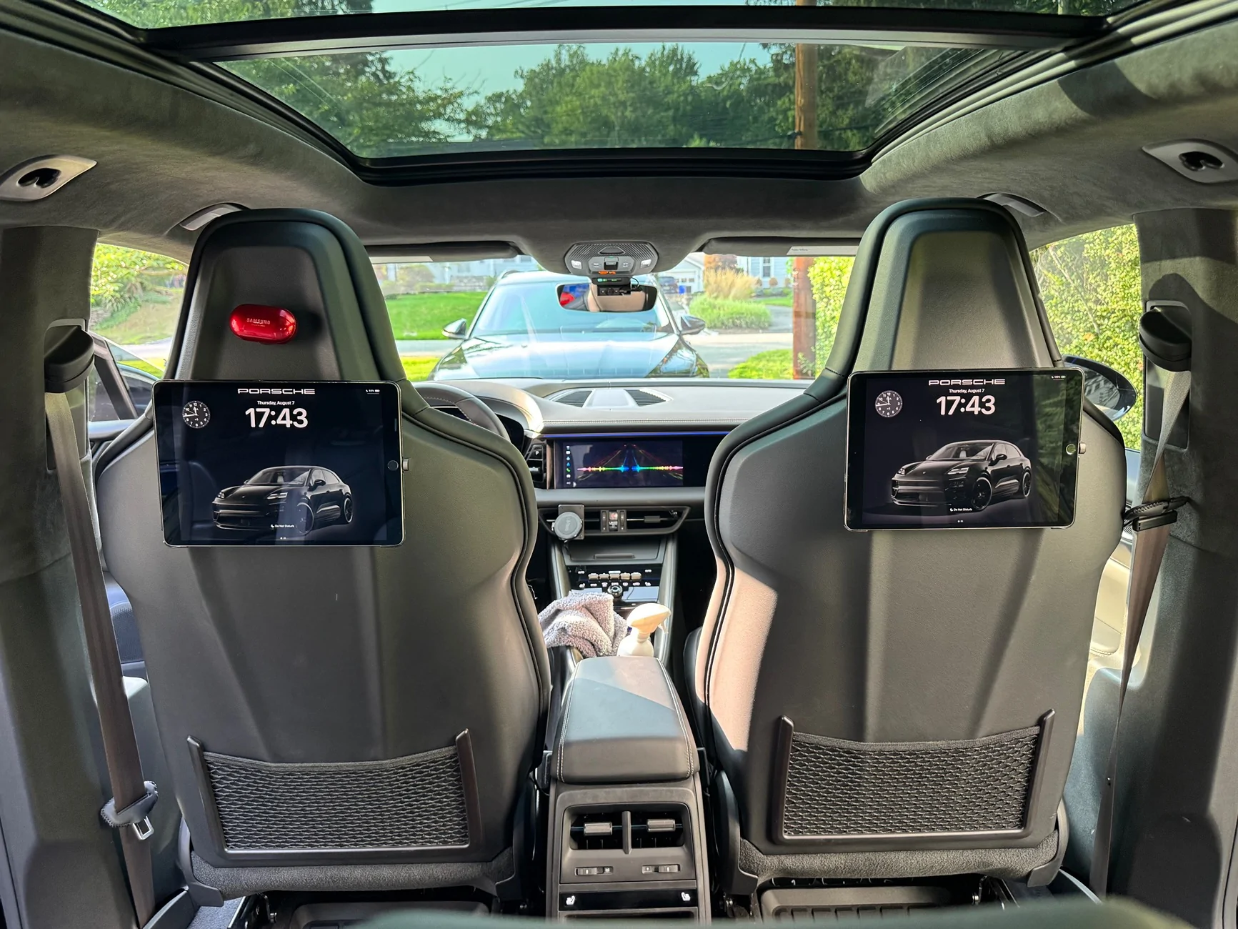

I ran a cable from the usbc port at the center Console a long up towards the outside of the seat. The wiring is done in a way so it is non destructive. In case of warranty reasons. The iPads are on magnets. So they can easily be removed or turned into portrait mode.

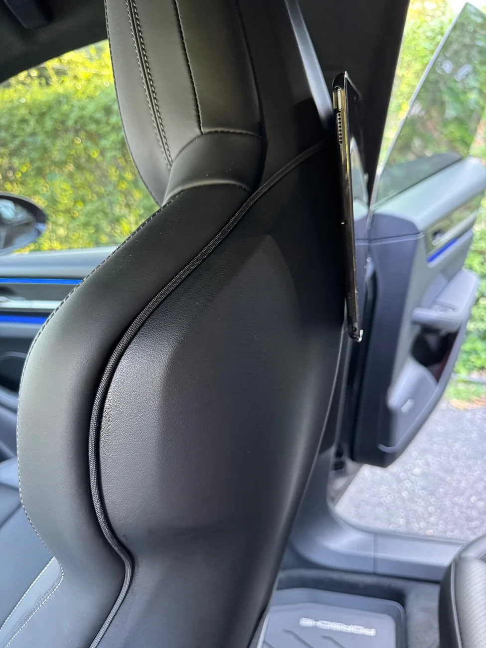

Glued a magnet to the seat. Added a metal plate on the iPad side to create the bond. The cable holder is there to hold the cable in case I unplug the iPad from it
Electric Macan EV Back seat entertainment upgrade: 2 iPads on seat backs IMG_1349

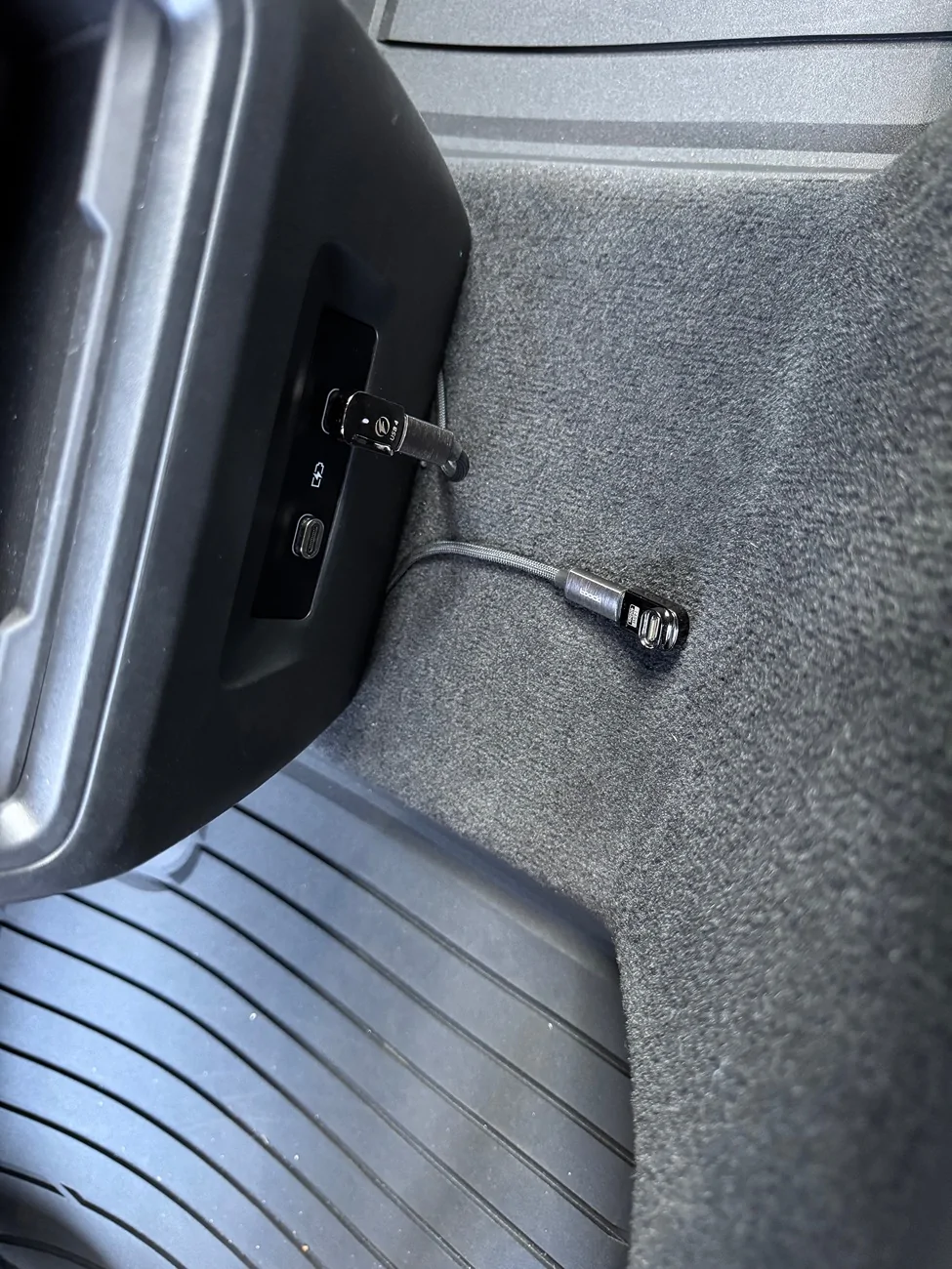

I ran the wire up on the side of the chair. Trying to avoid holes/drilling for warranty reasons. This way I can return it easily to factory look if needed.

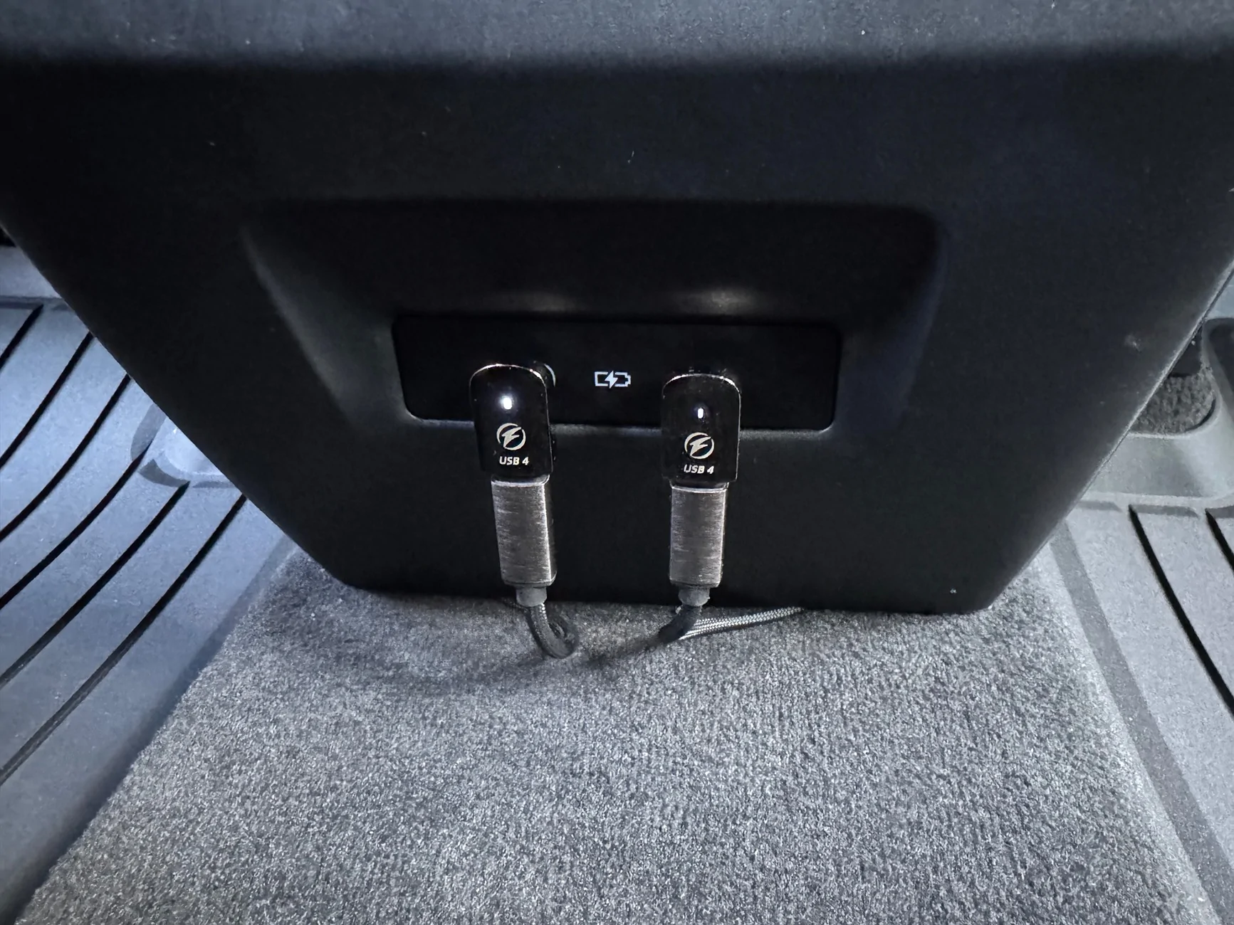

Below I added magnetic usbc plugs to avoid breaking in case they get hit by feet (likely! knowing my kids)

the cable and links vary from the plugs needed for the iPad that is used. I needed lightning plugs for my older 2 iPad airs. Here is the bottom portion
Electric Macan EV Back seat entertainment upgrade: 2 iPads on seat backs IMG_1356
I picked a cable that is not fully black. More grayish. It had to be lightning on one side for me. If you need USB’c you can get plenty on Amazon. I think as I needed lightning and 180 degree I think I got those from Ali express. I will post if I find the link to the order. It’s a while back.
