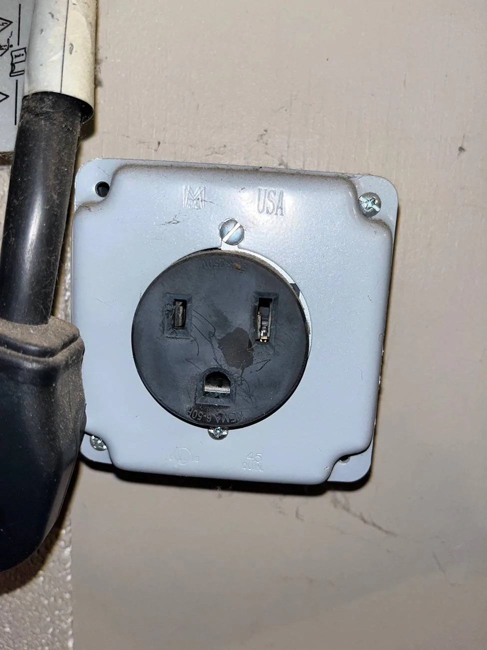

Here's a pic of the outlet
I'll be calling an electrician soon to see if components are up to the task

that is a NEMA 6-50 - and a reasonably beat up one - recommend you swap the plug for a high quality EV rated commerical/industrial rated NEMA 6-50 - don't believe me - then believe Porsche…they recommend/require a Hubble NEMA 6-50 outlet
see their tech bulletin here: hubble part number provided - accept no substitutes…
https://www.taycanforum.com/forum/t...-related-porsche-ntsb-article-analysis.13902/
https://static.nhtsa.gov/odi/tsbs/2022/MC-10222530-0001.pdf
you can see the NEMA 6-50 specification at the 6 o'clock position on the socket face in your picture…
that outlet should be replaced/upgraded to the hubble outlet recommended/required by Porsche - see their tech bulletin.
