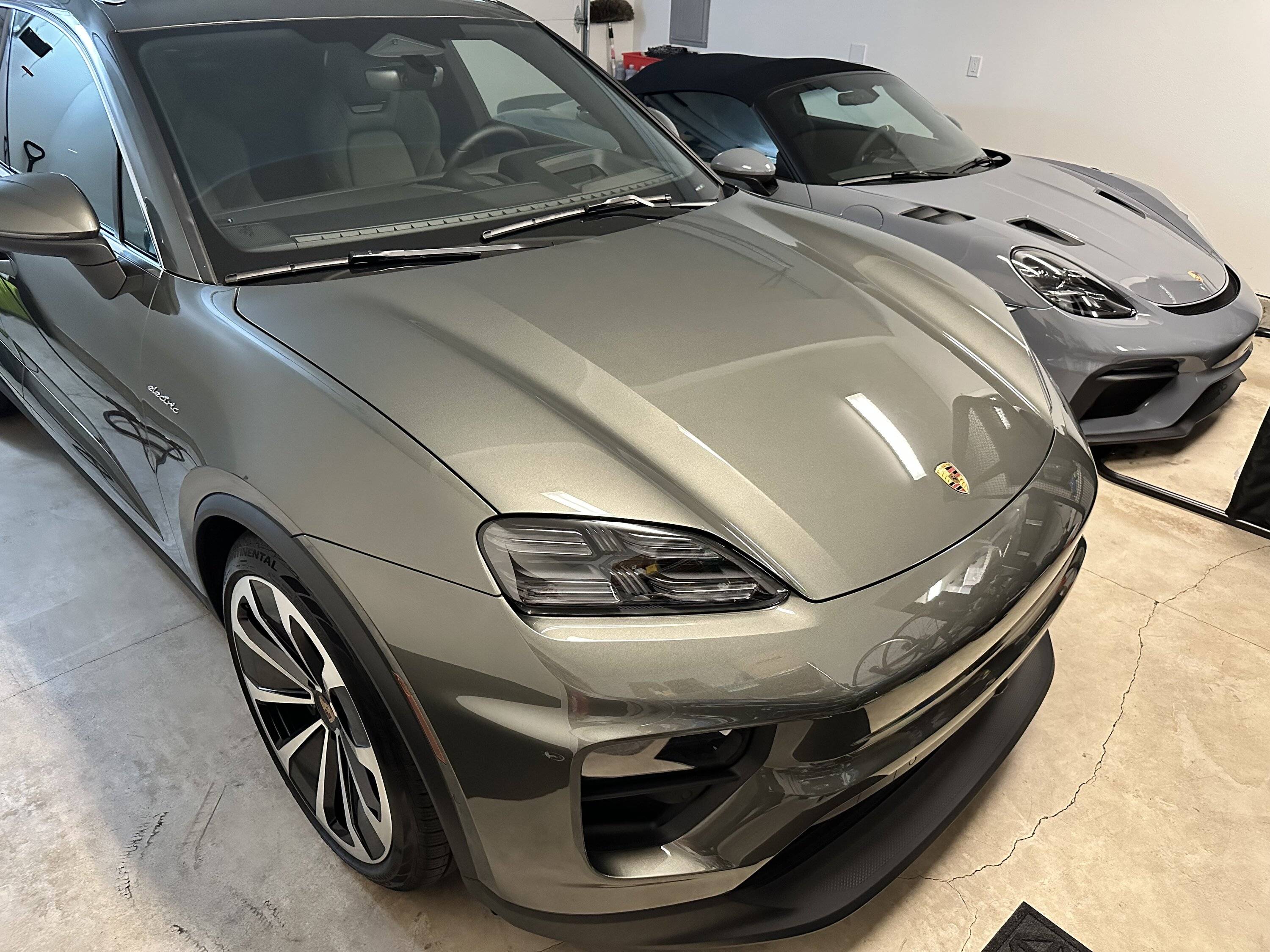

We took delivery of our Macan 4 today. Delivery was perfect as usual. We did the paperwork and went through features in the indoor delivery bay. Due to my crazy schedule they squeezed me in... rushed it for me, in doing so, it was only 45% charged. They said I could leave it there to charge complete while we did a few errands. Upon returning to driving it home, I noticed that the AC was not functioning correctly. I can control the fan speed, turn it off, but no cooling is provided no matter which mode. I tried everything, even the volume control reset. I gave up and returned back to the dealer an hour before they closed. The sales manager was stumped as well. Tomorrow I will being returning back to the dealer for a service center visit. It's no big deal as the dealer is only 5 miles from me. I'm curious if anyone else has or had this issue?

Update: Dealer stated there was never any Freon installed. They filled and checked for leaks and everything is good. Trying to figure out my passenger power port now... Drivers operates as designed... passenger is very random. Hope to get it back tomorrow. They gave me a ICE Macan for loaner.. and it feels so dated compared to the new EV.
