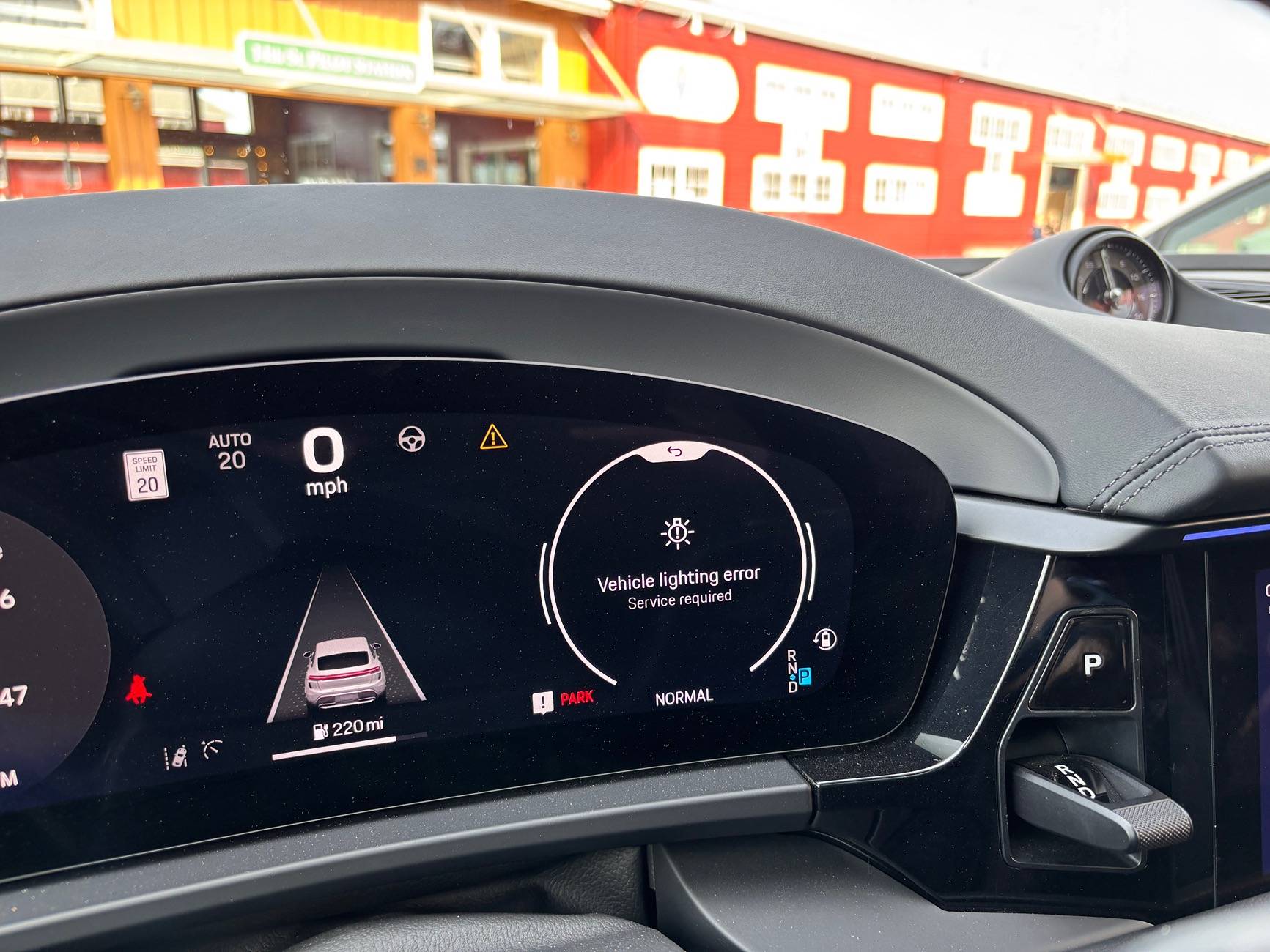

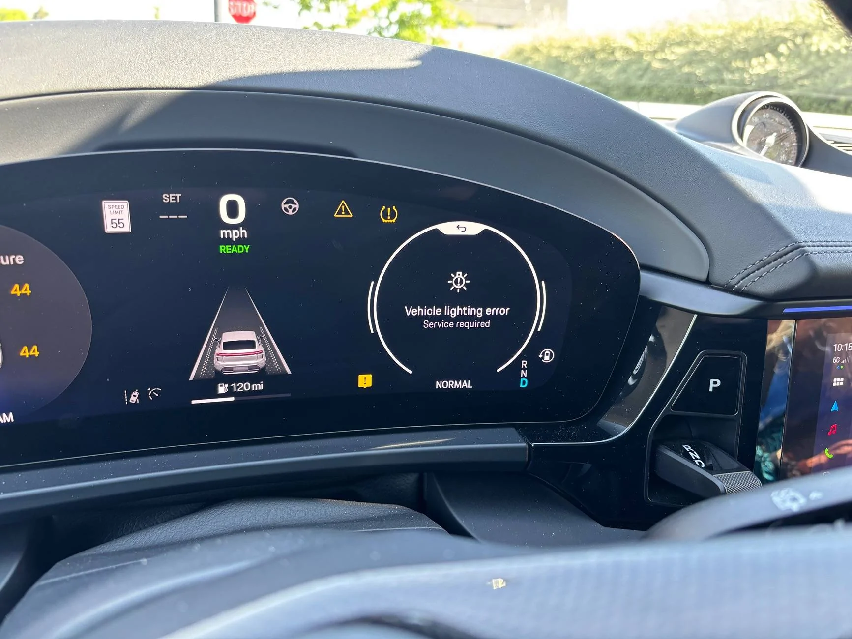

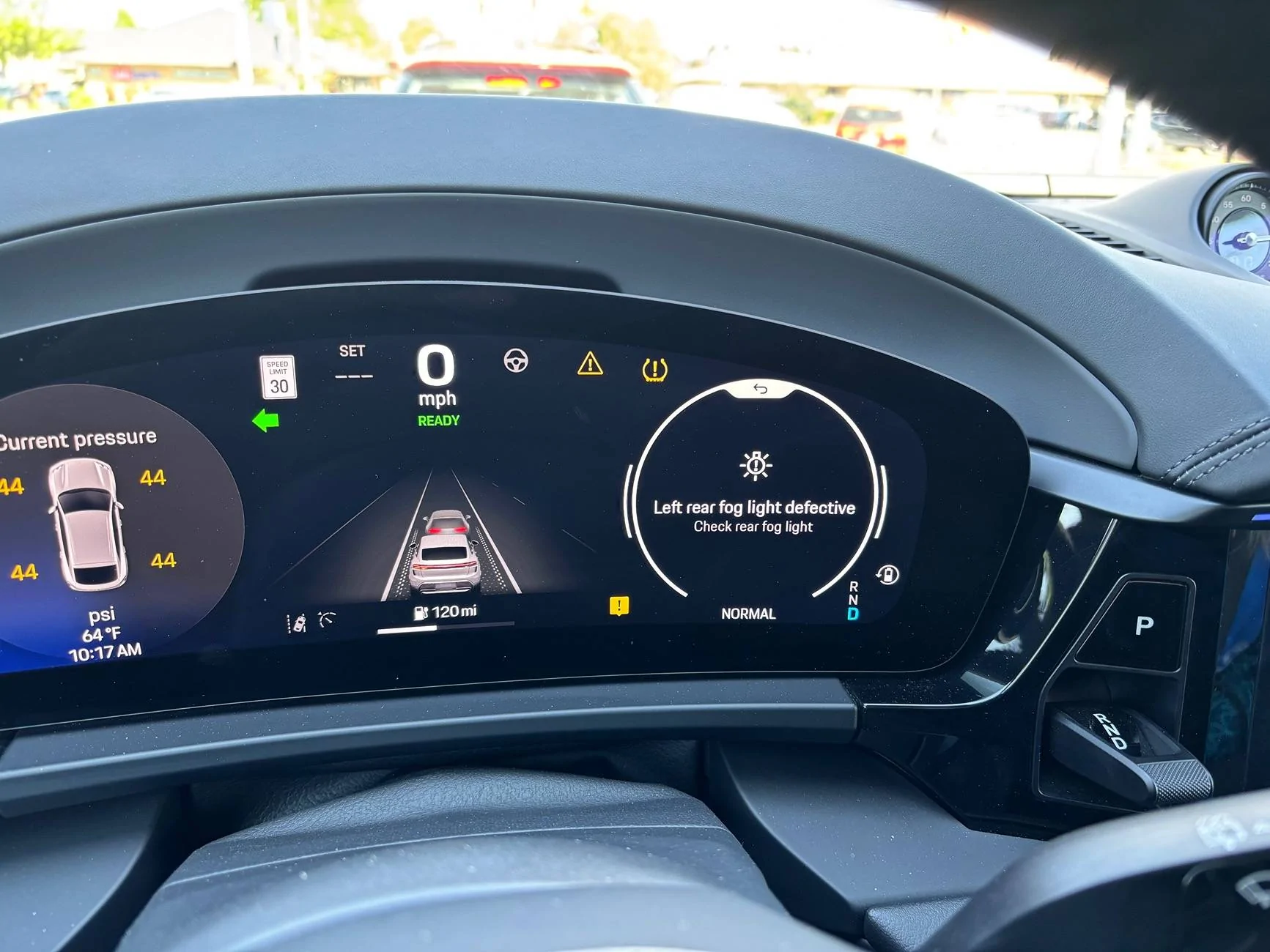

Got the car late last night after its cross country journey. THRILLED with it! Went for a fantastic drive to the Oregon Coast. What a precise FUN-mobile! All went perfectly for the drive over there (70 miles); perfect 60 degree F sunny day. Then did a 15 minutes a DCFC charge there to insure we could — that the Plug and Play Cert wokred as it should. SUCCESS!

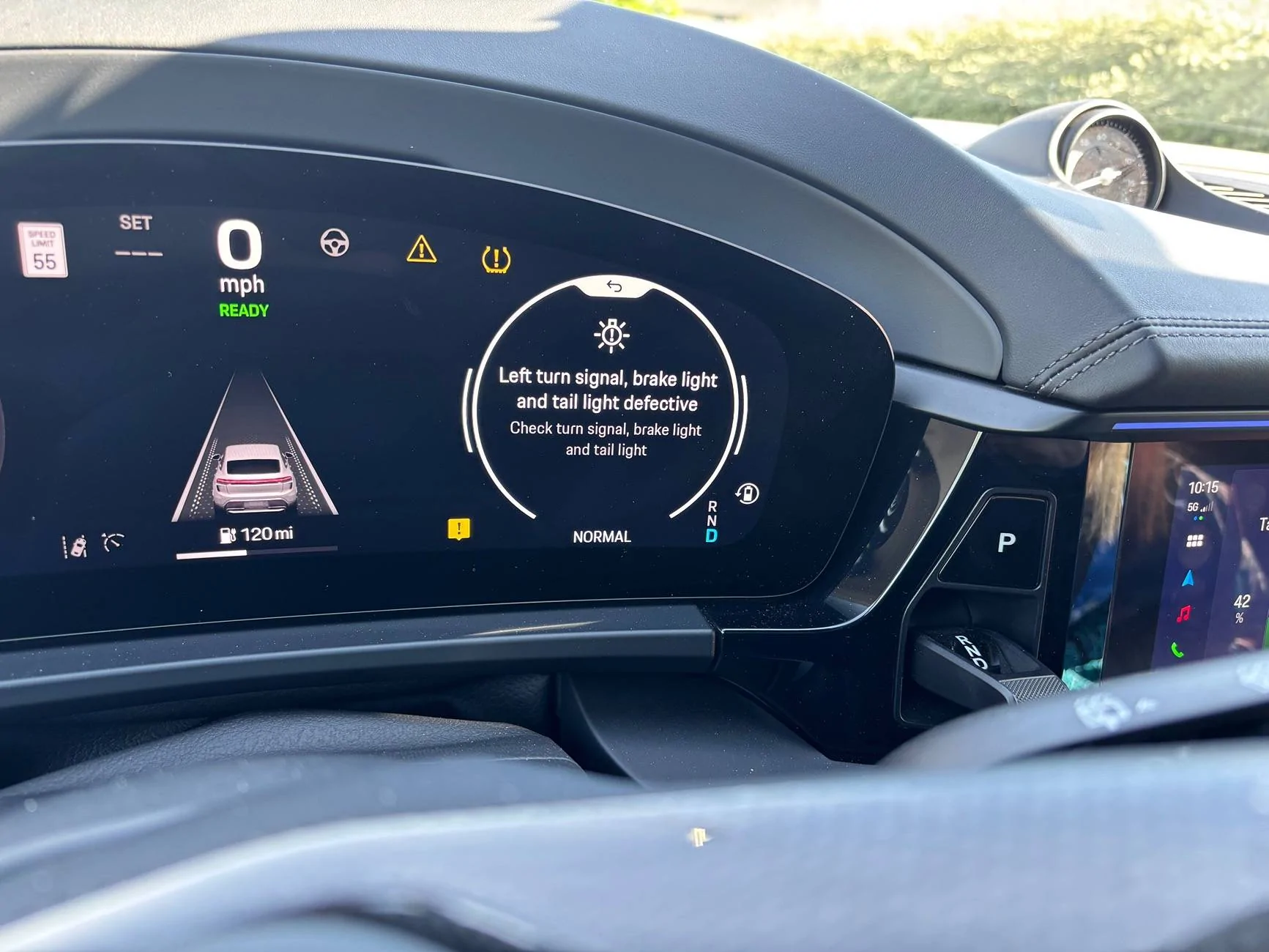

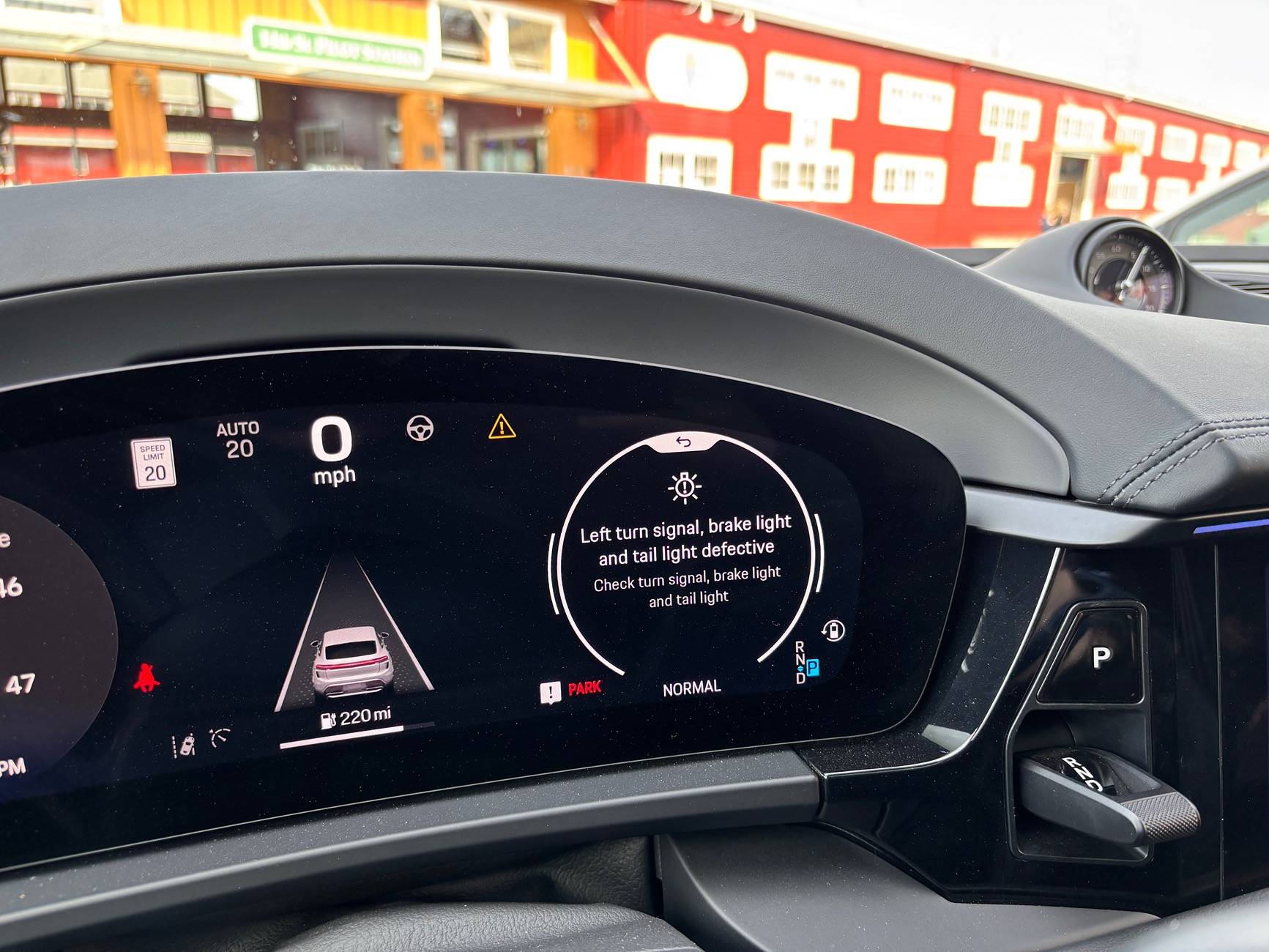

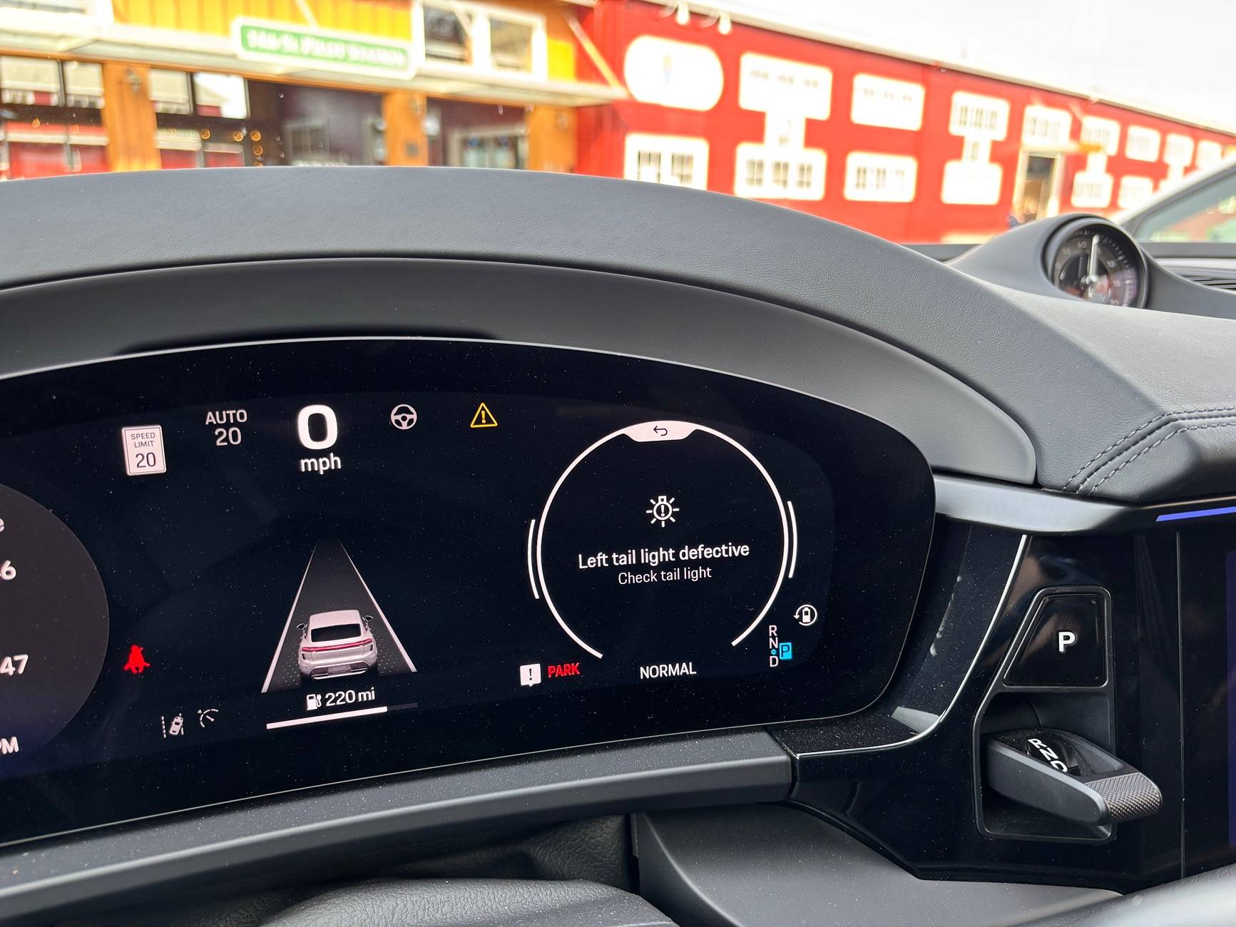

Then after starting out driving home, after ten minutes in the drive, the following warnings came up one after another within 30 seconds. All left side rear lights died. Rest of the car remained a dream.
Electric Macan EV All Left rear Lights Gone MIA: "Left rear fot light defective" message IMG_7240
Electric Macan EV All Left rear Lights Gone MIA: "Left rear fot light defective" message IMG_7239
Electric Macan EV All Left rear Lights Gone MIA: "Left rear fot light defective" message IMG_7238
Electric Macan EV All Left rear Lights Gone MIA: "Left rear fot light defective" message IMG_7237
After a 15 minute break on the way home for handmade ice cream, all the warnings went away and the light functioned perfectly again — well for first 20 minutes and then again all dead with the same warning notices.
Did something cool during the brak, but re-heated and caused them to re-die again? Any ideas as to what part failed to cause them all to die?

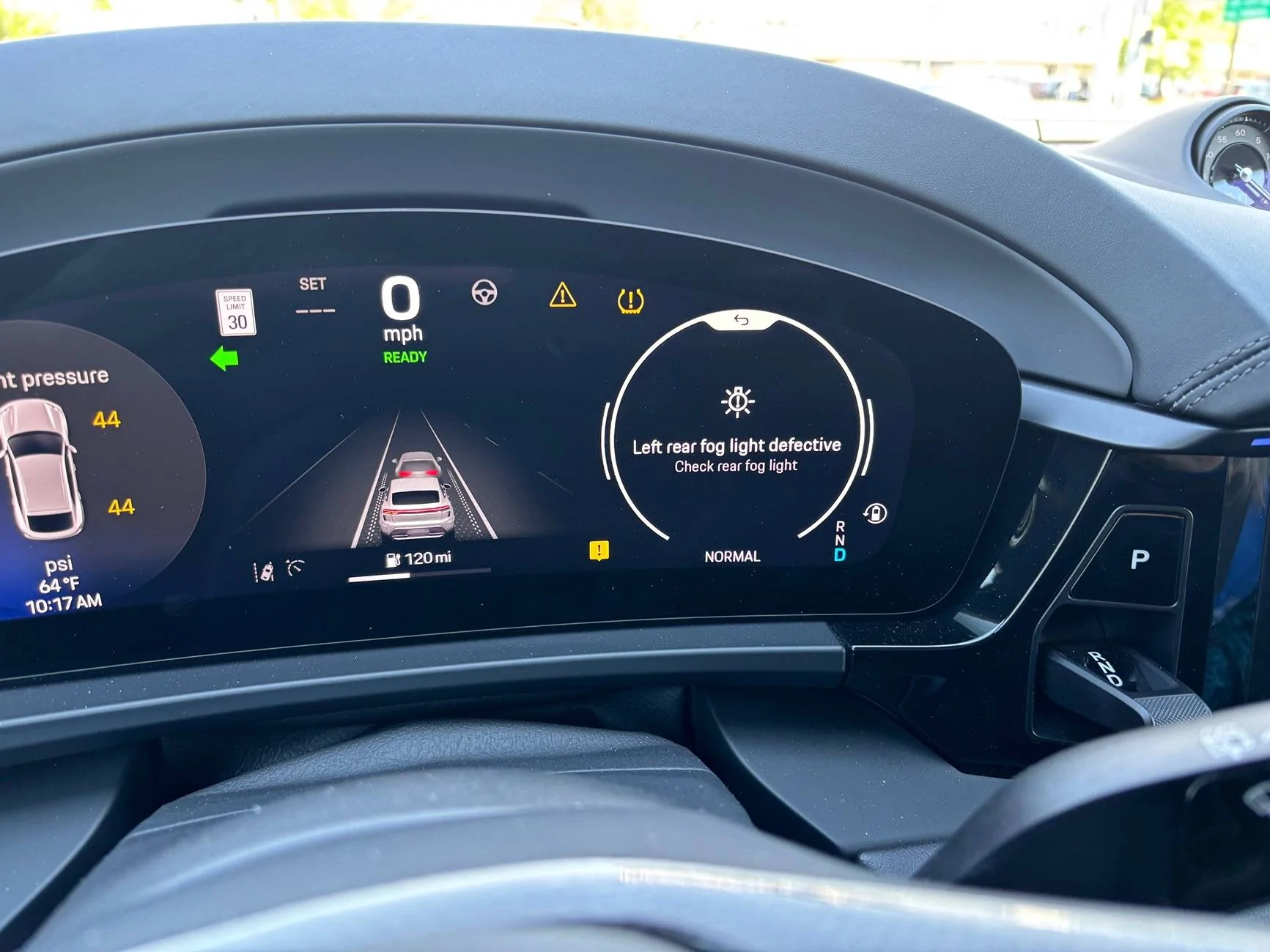

Good point. I have not checked them all but I visually checked and confirmed that the fog light is dead and the left turn signal light is also not working .Also, we remember how when we our turn signals were actual light bulbs years ago, and when one went out the other one on that side of the car then blinked twice as fast. Another confirmation of the dead rear, left-side turn signal light.
Will be checking the brake and the tail lights themselves later tonight, Thanks.

Next chapter of the “lights out driver’s rear quarter:” saga: As above the entire left rear quarter lights failed three times previously but each when we stopped for 20+ minutes, they would back on coincidentally with the 3” diameter right driver’s pod big warning symbols in yellow going away when the lights came back on (and vice-versa)
The dealership and I wondered whether since there were all many sofrtware settings going away the two were software related. However today with the days long VR28.11 software extension download and other software updates finally being completed, there were not lights. Well for a short while, for while the Tech was in the car doing the last testing for the GPS location triggered Auto-lift to highest postion (which was now working before the software installs (but was working well he was testing it), the same light warnings came on — with of course the attendent driver’s side rear lights failing. While a bummer in one way, glad the Tech himself saw it happening.
So instead of coming home with us tonight, our Macan remains at the Porsche hospital. Leading contenders for the light failures includes an intermittent now-needing-to-be-traced wiring short, OR a lighting sensor that when it heats up it cuts out. Just hope it is identified and fixed soon of course; worse case would be horrid, that it is a sensor or equivalent with the closest replacement part not being in country. Oh well, enjoying the almost new, 2,600 mile, 2025 Cayenne loaner so not too bad after all. Though we MISS our Macan EV already!
43
984
1,543
bad wiring harness is most likely root cause here - questionable if Porsche would diagnose that - good news is it's not a wear/tear issue - if that is root cause and the harness gets repaired/replaced it's not something that "degrades" over time…it will solve the problem once and for all.
