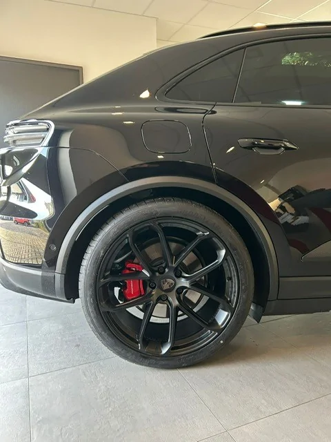

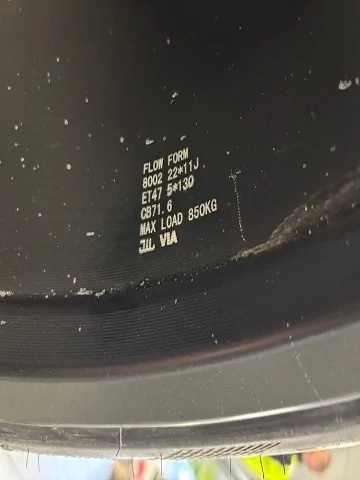

All dimensions are correct for front and back: 22‘ x 9J ET29 in the front, 22’ 11J ET47 in the back.
Bolt pattern 5x130, installed tyre size is correct, except centre bore is not correct.
Center bore of the wheels is 71.6 while Macan EV has 66.5 hence my question are the wheels aftermarket or Porsche, how can I tell?
Electric Macan EV Are these original Porsche (Macan) rims? Afbeelding1
Electric Macan EV Are these original Porsche (Macan) rims? Afbeelding2

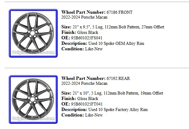

Aftermarket. Macan ICE wheel. Nothing like that was ever offered from the factory for the Macan EV.
Edit: Thanks to krissrock for identifying the actual wheel.
Thank you for your input, unfortunately bolt pattern Macan ICE is 5x112, these are 5x130 and 22"

Porsche Cayenne GT has similar wheels in 22" but different size, 22x10J ET48 front and 22x11.5J ET61 in the back.
