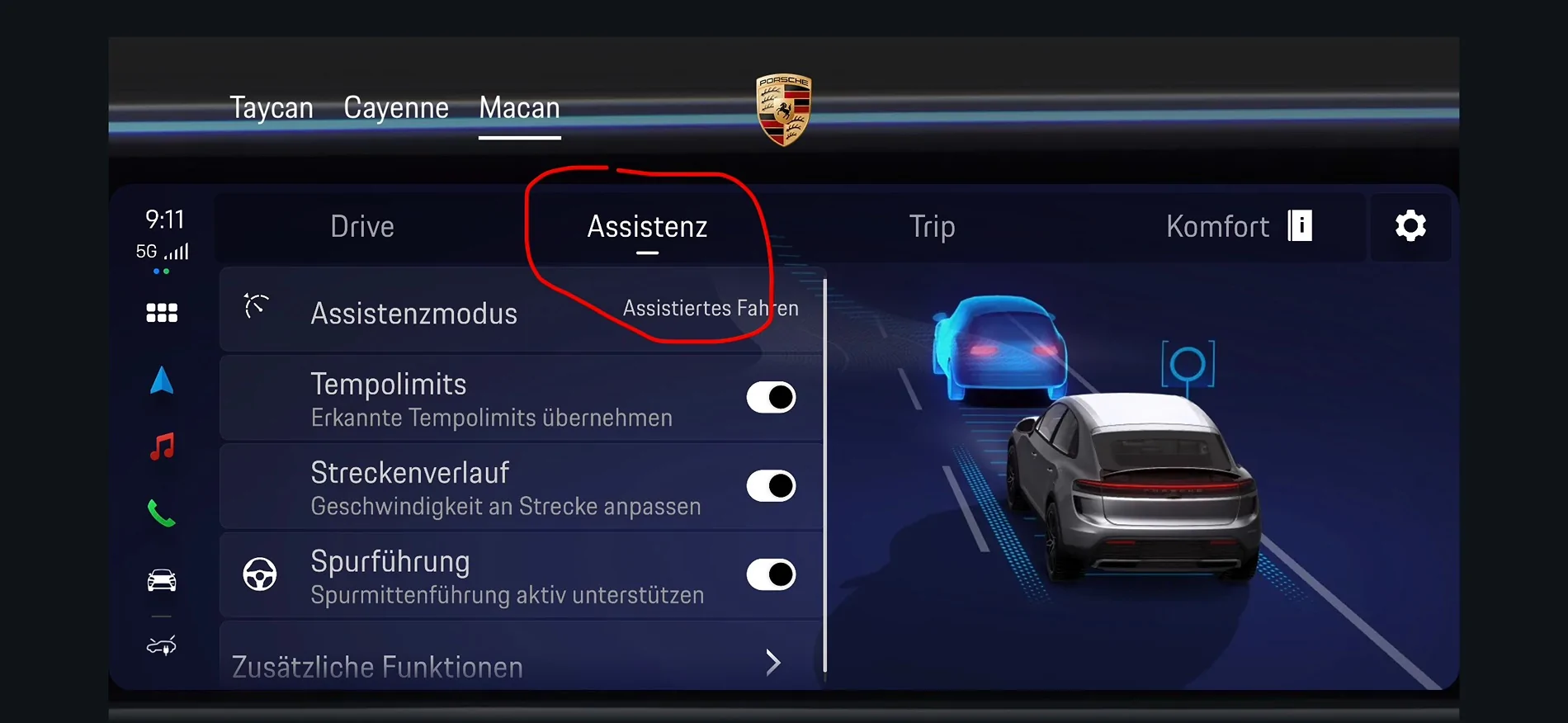

A few days ago I noticed my assistance settings disappeared. I used to disable speed assist as soon as I enter the car using the shortcut on the main screen. Well, it is no longer there.
Then my wife searched the infotainment for 5 minutes and couldn’t find any place to configure the assistance settings.
Also when using Innodrive I no longer receive the 3 settings panels on the main screen.
Funny enough, all systems still operate normally. I do receive lane assist messages and counter steer as well as the chimes when hitting the speed limit - I simply can no longer turn it off.
I attached a screen from the PCM simulator, the red circle is the screen I am missing.
Anyone had something similar? I tried already rebooting the PCM (30 sec volume nob) but don’t dare to reset the full car.
