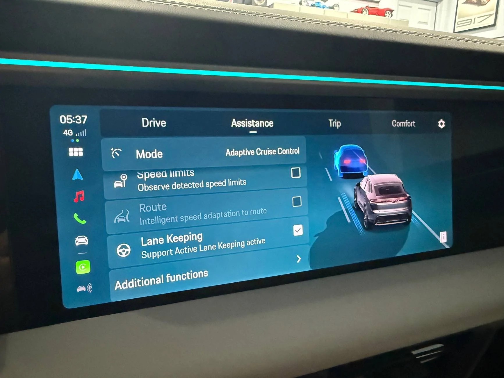

When you press the mode button on the end of the cruise control stalk, you get to turn on or off which of the three features you want via the central display (speed limit, route topography, lane keeping). I tend to keep speed limit adjustment off as it is regularly incorrect in what it think the limit is. I find the lane keeping works pretty well, unless it is dark and the car is dirty, where I disable it for that drive and use it as a regular adaptive cruise
I am in the same camp as you with turning off the speed limit warning with the diamond button and the lane departure with the button on the bottom of the stalk at the start of every drive

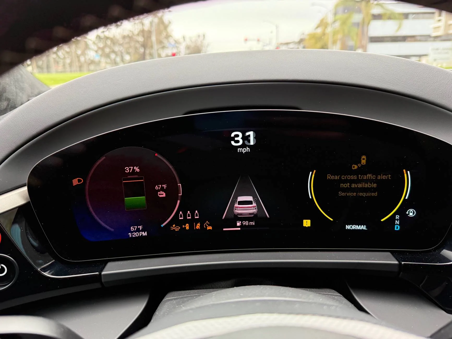

Full set of Christmas lights went up on my dash. Guess I’ve joined the club on these sensor issues.. happened on a Sunday after a short stop at a store. Got back in and all the lights and warning started up. First time. Haven’t checked back after getting home and shutting down the car.

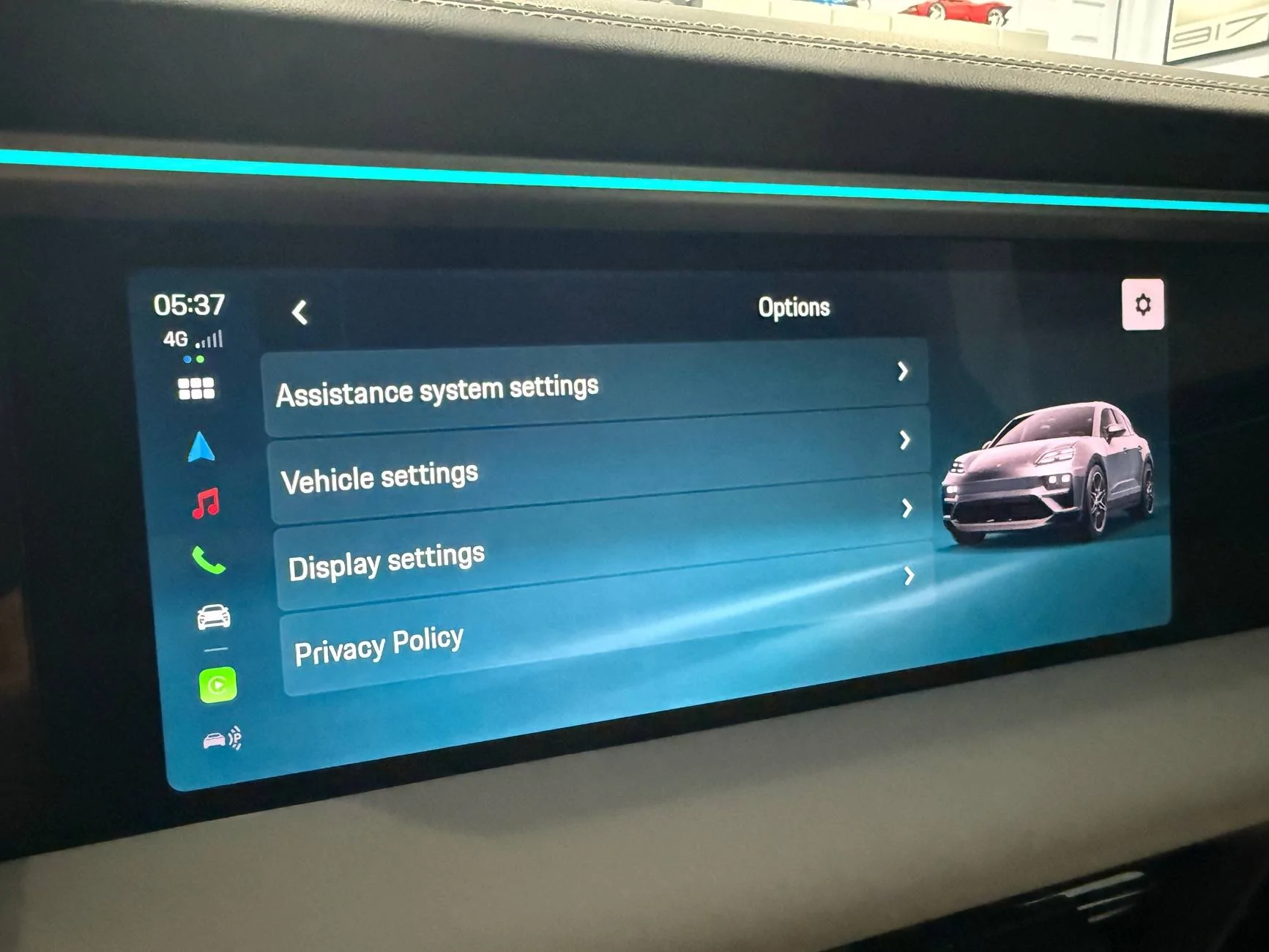

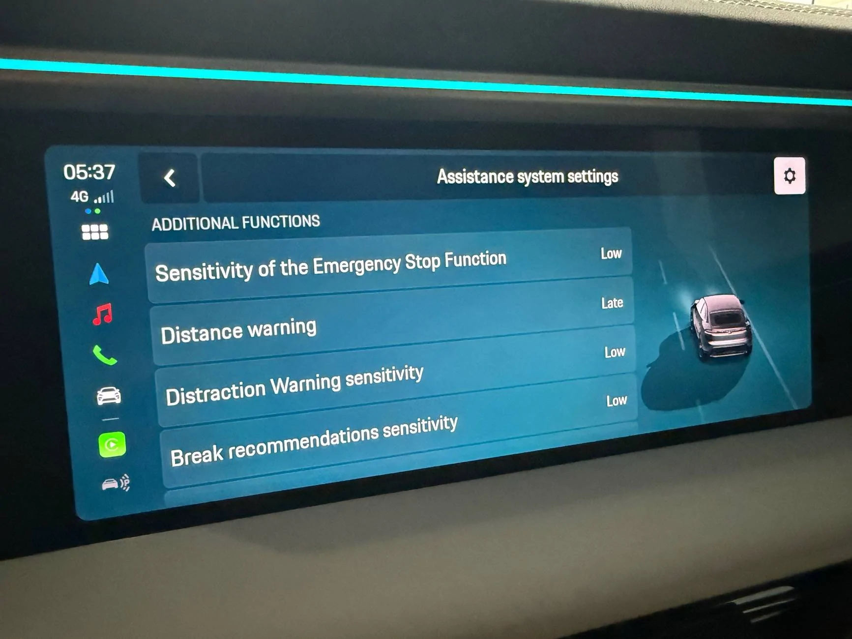

You have options in the assistance menu for setting the sensitivy of many of these functions. I found my Macan EV to be way more sensitive then my 911 so I went hunting for setup options.
Assistance/Gear icon far right/Assistance system Settings. Choose your preference: Low, Normal and High. I set many of mine to low or late and the driving experience is much improved.
