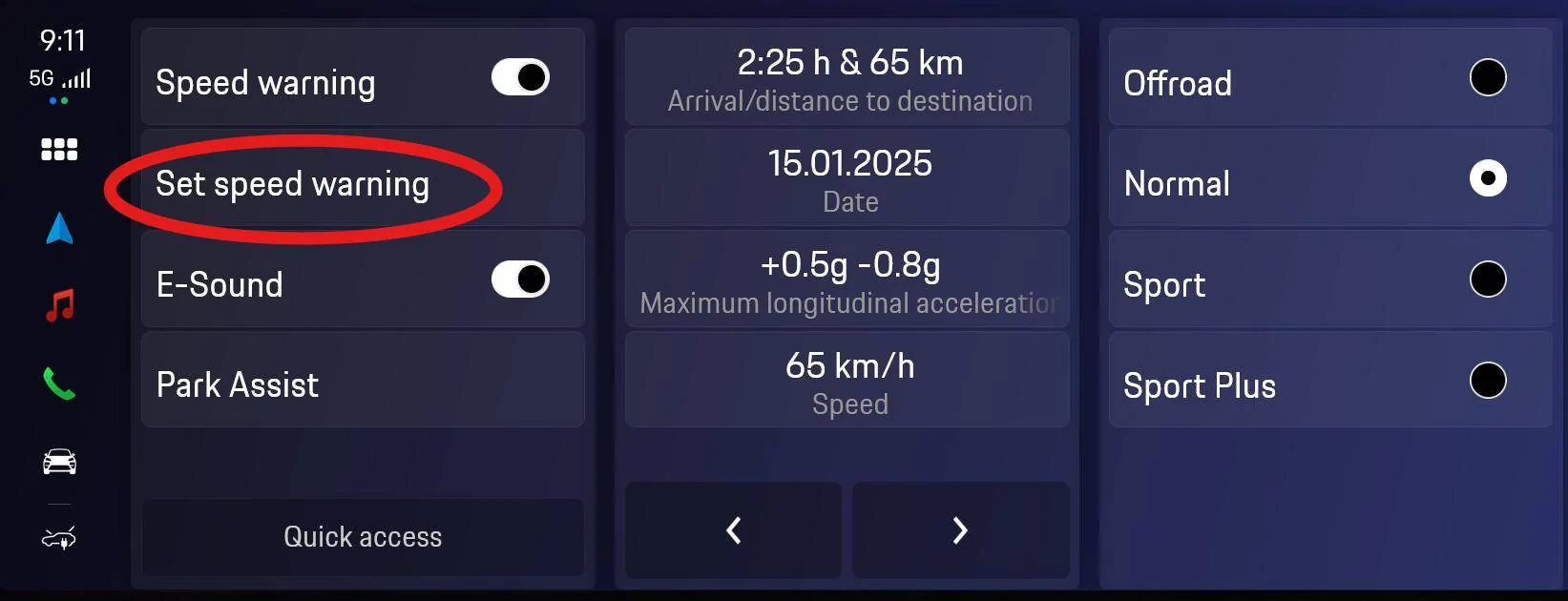

You have options in the assistance menu for setting the sensitivy of many of these functions. I found my Macan EV to be way more sensitive then my 911 so I went hunting for setup options.
Assistance/Gear icon far right/Assistance system Settings. Choose your preference: Low, Normal and High. I set many of mine to low or late and the driving experience is much improved.
