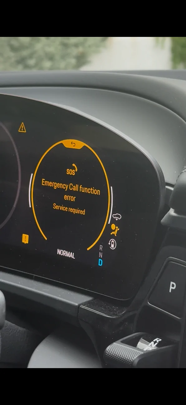

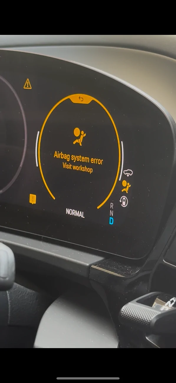

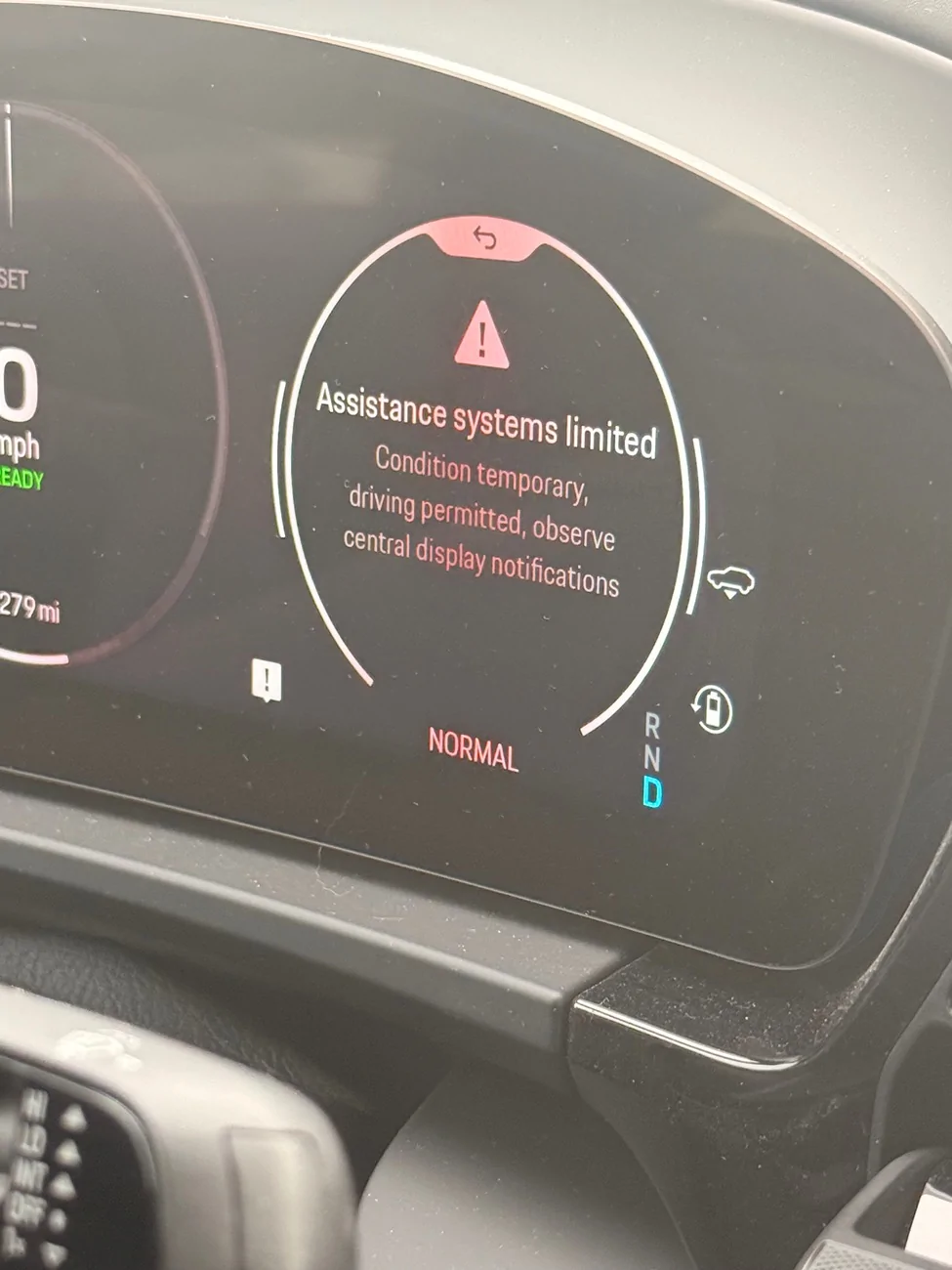

I’ve had my macan EV for a month. In addition to the driver assist warning I also today had a warning about the SOS system and a warning about the airbag. The airbag warning says to take it to the dealer. It was raining cats and dogs today here in Los Angeles. Has anyone else had the airbag warning?
