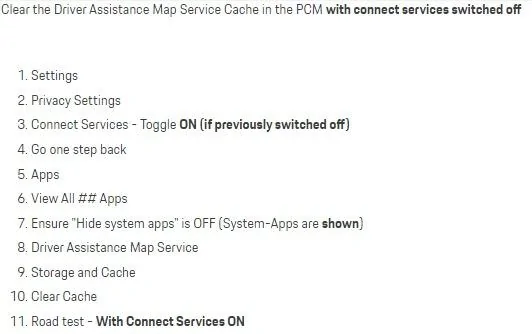

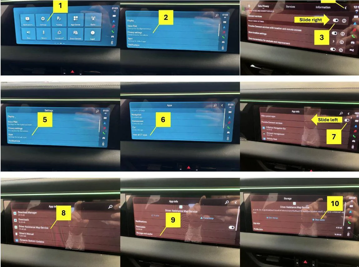

You should all hear from your dealership. Mine just sent through details of how to clear the cache from the "Driver Assistance Map Service" to speed up the OTA update (otherwise cache clear happens automatically every 24-48 hours). Its all to do with a software bug in the regional country coding of the predictive map data. Will let you know if / when my update happens and if the issues are resolved.

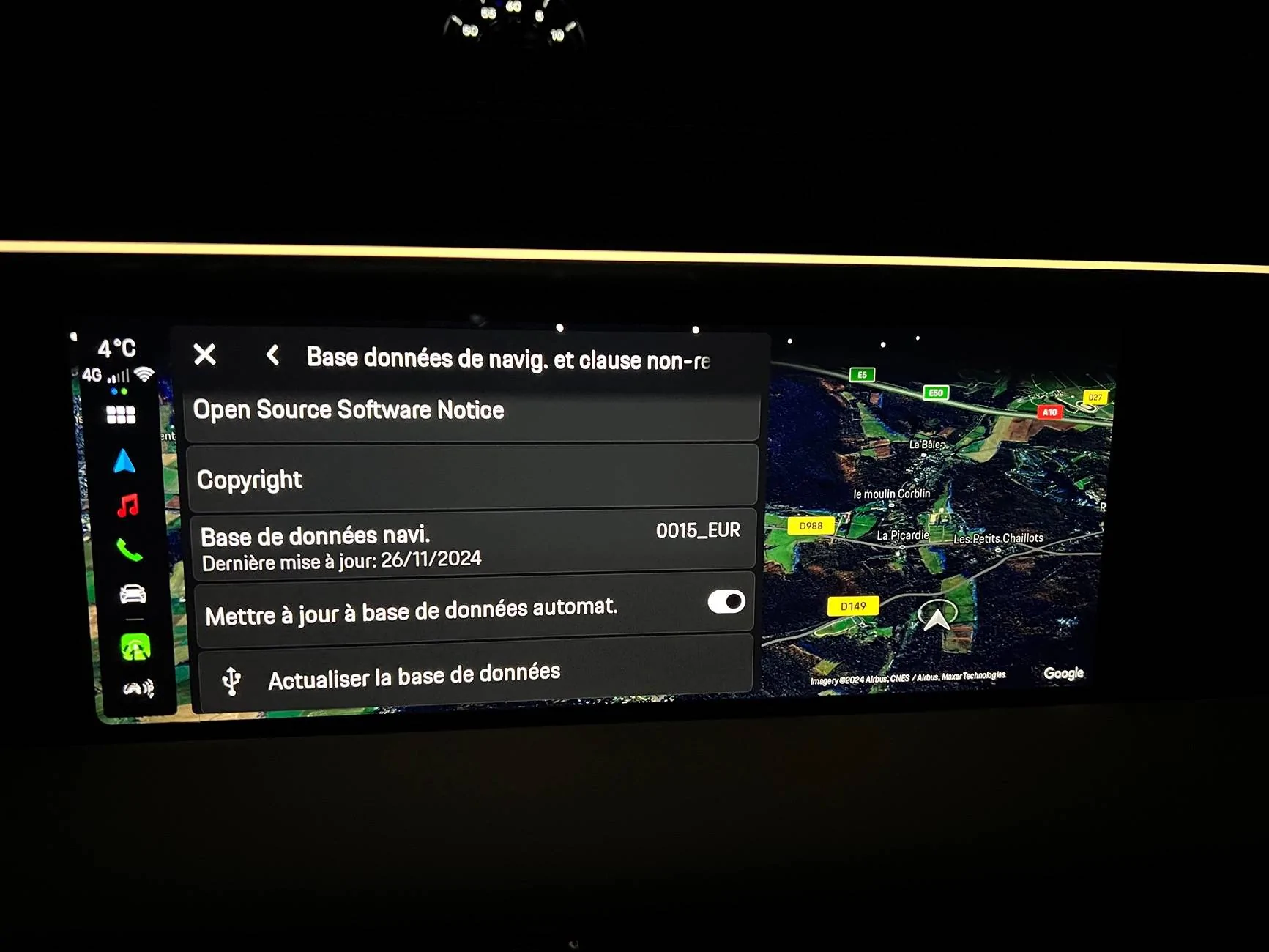

Nop, not a software update, just a data map update that solves this sort of problem.
In Europe, it‘s 0015_Eur
Could you post the details of how to clear the cache, please KR45, in case if we need it? Many thanks.

Dear KR45, you are an absolute super star. I really appreciate for your time not only just posting instructions but to take pictures and adding pointers. Let me check and get back. Have a great day.
Sales guy at Dealership was the star but happy to share 😁

We would appreciate that you provide us with the PCM version if the update is related to it!
