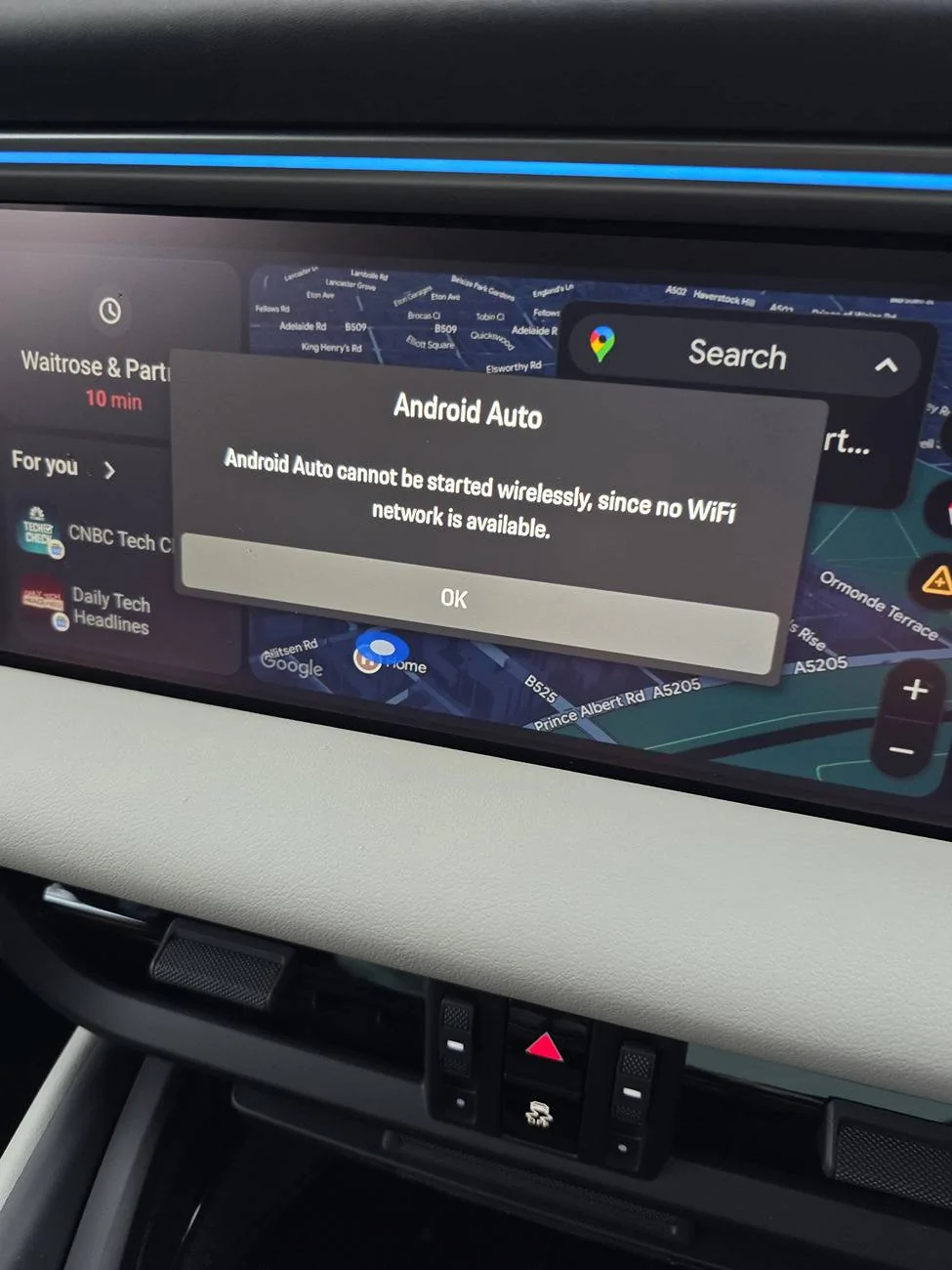

Help!
I'm getting this error. No WiFi network is available.
Electric Macan EV Assistance Systems Error - Speed Limit Display (warning message) no wifi network
