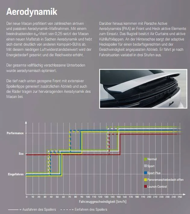

It’s in German but should be readable.
The car is from Germany where there are no speed limits on some roads, that’s where the spoiler is useful :)
Extending it at lower speed would not make sense airodynamically. You can always force it to be extended in the car settings if you really wish to.

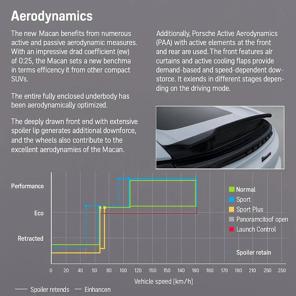

Simply asked ChatGPT to translate the image with the original formatting respected as closely as possible:
Aerodynamics
The new Macan benefits from numerous active and passive aerodynamic measures. With an impressive drag coefficient (cw) of 0.25, the Macan sets a new benchmark in terms of aerodynamics and clearly stands out from other compact SUVs. This low air resistance value reduces energy consumption and increases range.
The entire fully enclosed underbody has been aerodynamically optimized.
The deeply drawn front end with extensive spoiler lip generates additional downforce, and the wheels also contribute to the excellent aerodynamics of the Macan.
Additionally, Porsche Active Aerodynamics (PAA) with active elements at the front and rear are used. The front features air curtains and active cooling flaps. At the rear, the adaptive rear spoiler provides demand-based and speed-dependent downforce. It extends in different stages depending on the driving mode:
Graph Labels (Bottom):
  • x-axis: Vehicle Speed [km/h]
  • Legend:
    • Green: Normal
    • Blue: Sport
    • Yellow: Sport Plus
    • Gray: Panoramic Roof Open
    • Red: Launch Control
Graph Labels (Left Side):
  • Performance
  • Eco
  • Retracted
Graph Lines:
  • Solid Line: Spoiler deployment
  • Dashed Line: Spoiler retraction
I then asked it to update the file by using that translation so I could download it. Not perfect but pretty close… and took all of 30 seconds. ?
Electric Macan EV At What Speed Does Your Spoiler Extend? 8789C57C-AD47-4E13-8811-BB370ADE9984
451
483
The more I stare at that graph, the more errors I find. It might only be the background color that's correct.

That’s why I provided the translation separately for those who really don’t want to be bothered.
Aerodynamics
  • Legend:
    • Green: Normal
    • Blue: Sport
  • Performance
  • Eco
  • Retracted
Graph Lines:
I put ChatGPT through its paces with translating, as well - I was impressed!

To add some detail that is hard to get out of the original graph, my spoiler goes up at 94kmh in Sport Plus.
And using the pop-up mode of the sunroof does not cause the spoiler deployment.
