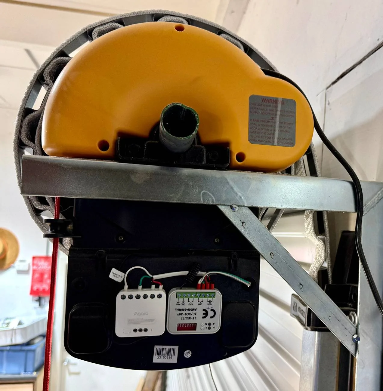

It looks like this when done (ignore the little white box on the left - I've added a matter controller to integrate the door with my smart home as well):

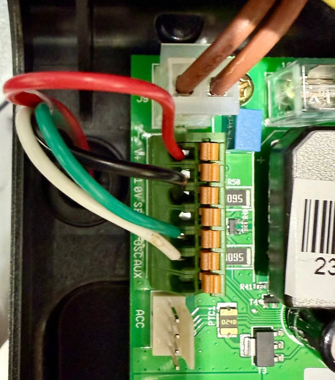

Wire the switch contacts ("CH 1") on the receiver to your door controller's switch terminals, and pressing the remote should open/close the door. On my controller, the switch terminals were labelled OSC and 0v (ground).

Some pics:

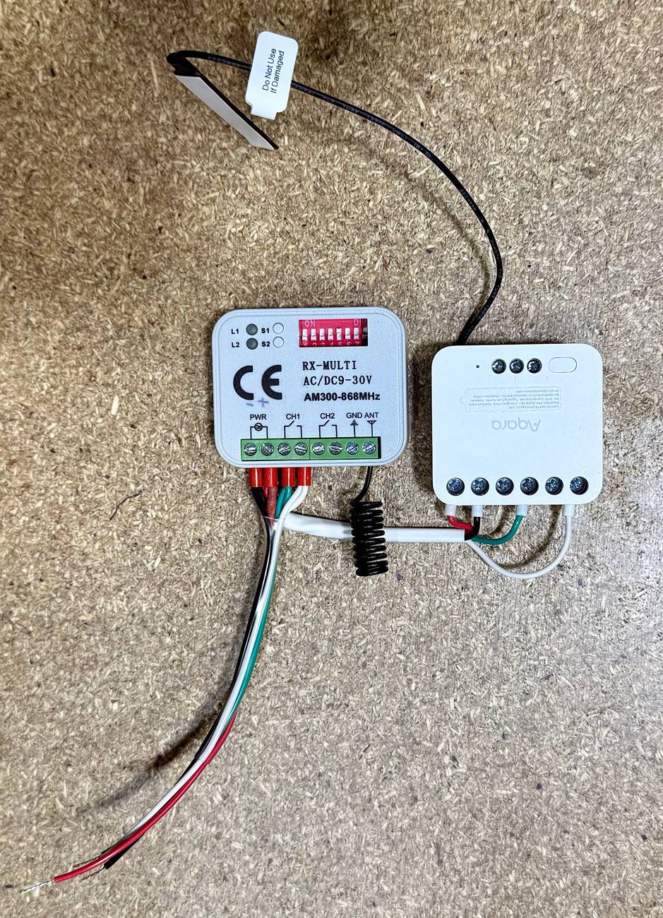

Wiring:
Electric Macan EV [AUS] Homelink conversion for all homelink receiver wirin

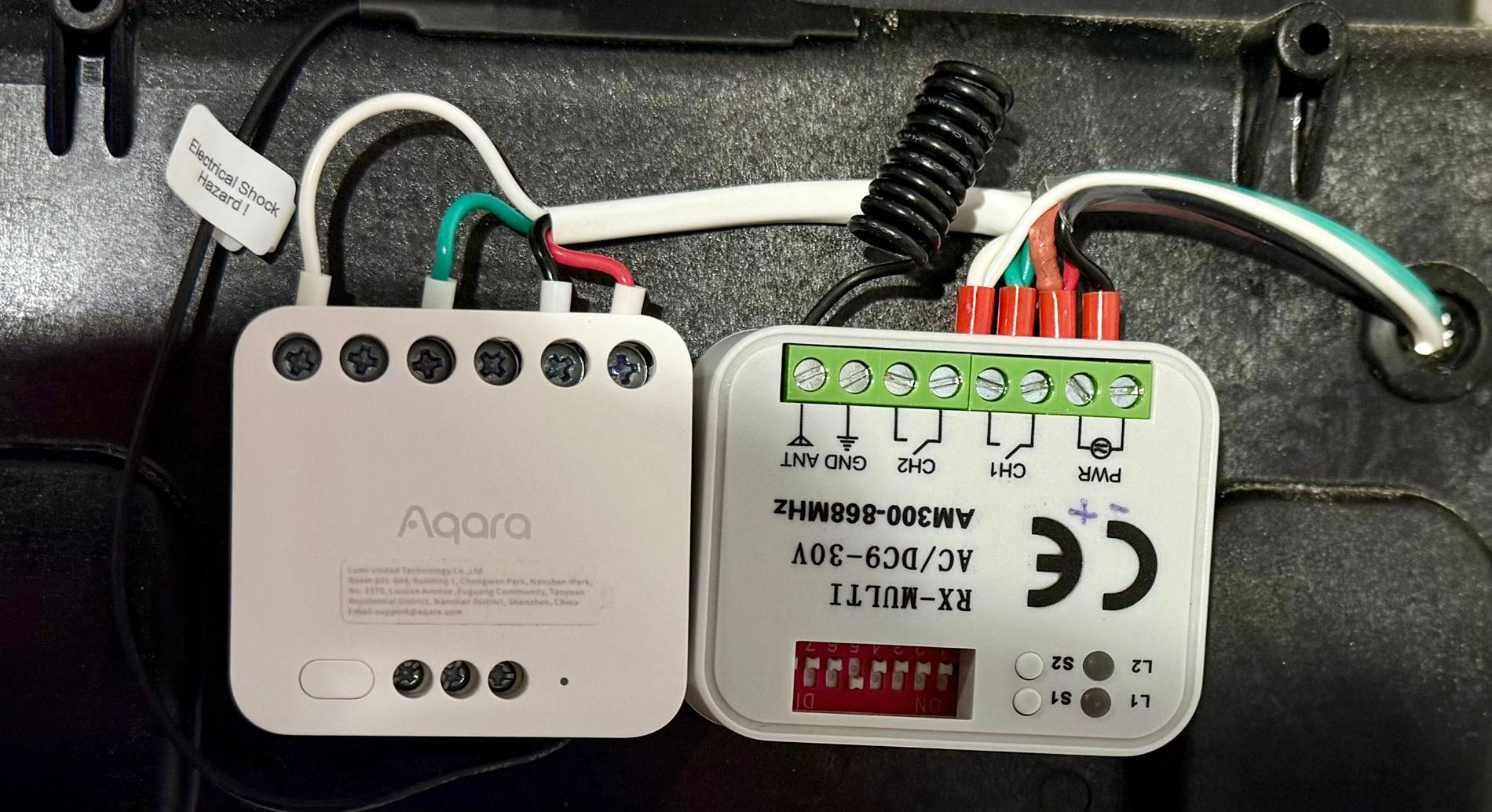

I made a little wiring loom to add the matter control as well:
Electric Macan EV [AUS] Homelink conversion for all homelink and matter controller
Power (+30V, GND) and switch (OSC, 0V) connections on my garage door controller:
Electric Macan EV [AUS] Homelink conversion for all homelink connections
... and stuck to the controller with some double-sided tape.
Electric Macan EV [AUS] Homelink conversion for all homelink and matter controller mounted
