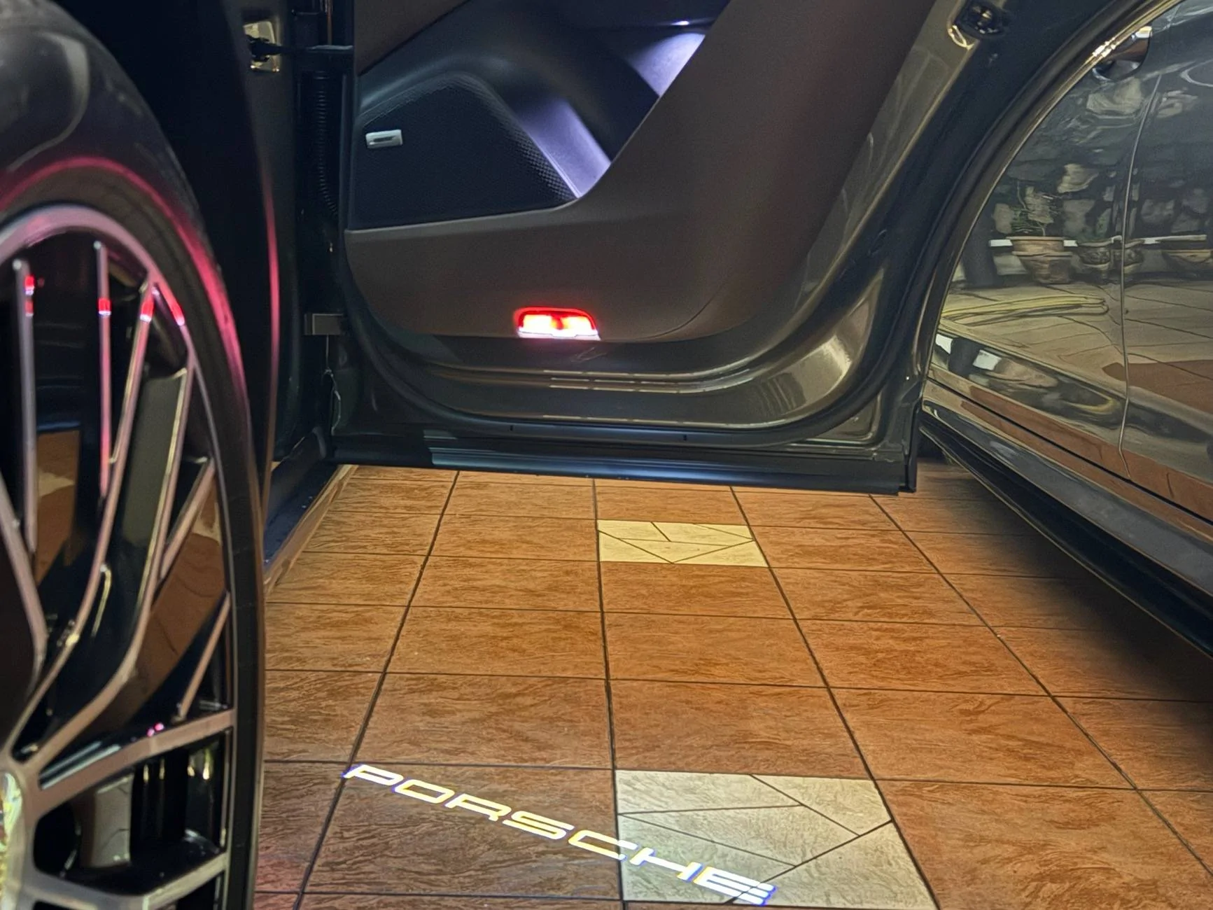

I got the official Porsche ones. I think they’re $160 per pair. I don’t mess with Ali express and electrical components on an electric vehicle. Relatively easy to install takes some force to pull out the original lights from the door panel.

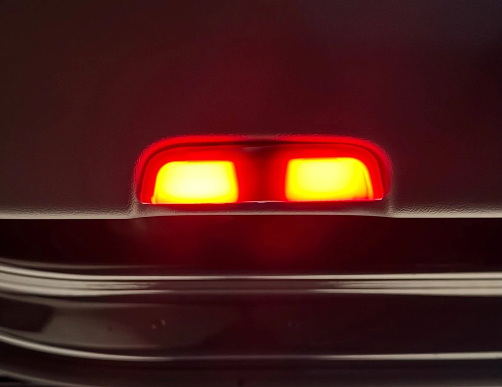

I too ordered my directly from Porsche. More expensive than Aliexpress but still half the cost of including it in my build. Looks great although note the original lights had a solid red bar showing from the side of the door whereas the new puddle lights have two red sections when illuminated (see photo below).
The original puddle lights also had the electric plug in the center whereas the projector lights had the plug offset to one side. Doesn’t really matter since the door panel has a fairly large opening where the light fixture snaps in.
It was easy to pop out the original light with a pry tool although it took a fair amount of force to snap the new ones back into the door panel. I found it worked best to first seat the clips on the long/back side with the electric plug first, then use a lot of pressure to push in the front/red side of the light.

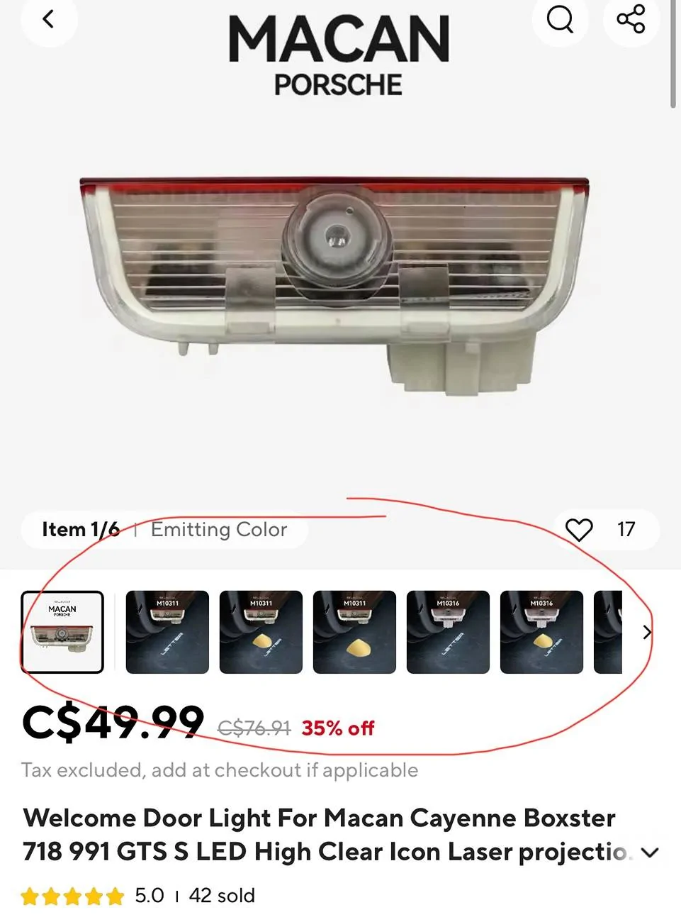

As @Frankie and others (including myself) have found - the connector is purely dependant on which ‘model’ you ordered (10316 vs 10311) with the former (M10316) being like the original puddle light (location of connector being in the middle) - thankfully connectors-types are the same for both models (as many have confirmed).
You had me running out to check the whole ‘bifurcated’ red light situation ? - again I think due to the projector being in the centre. Mine are the same (I had forgotten!) but when I went to check some photos I took of the original puddle light (with text) at my Dealer that I used for my research it turns out they’re also the same (split) - although the projector module seems different.

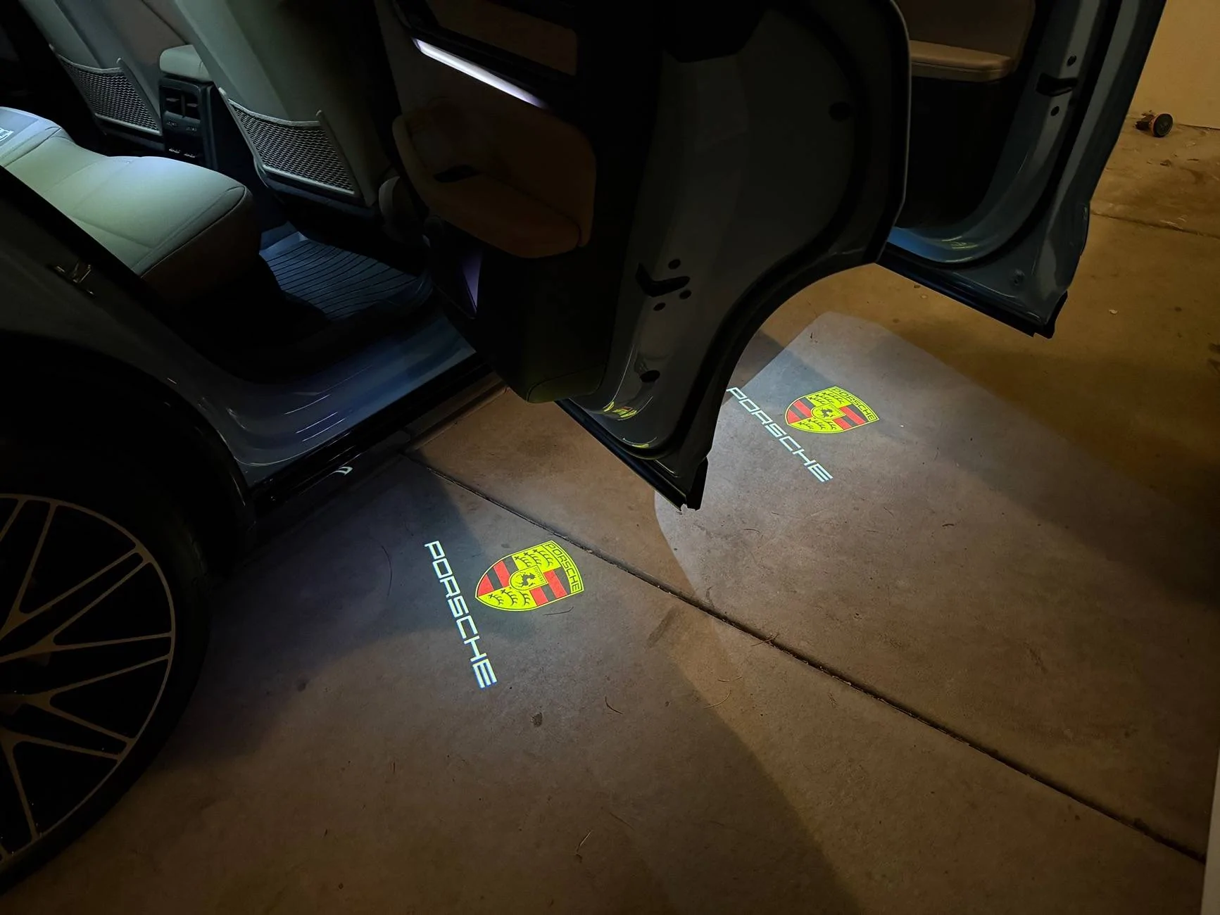

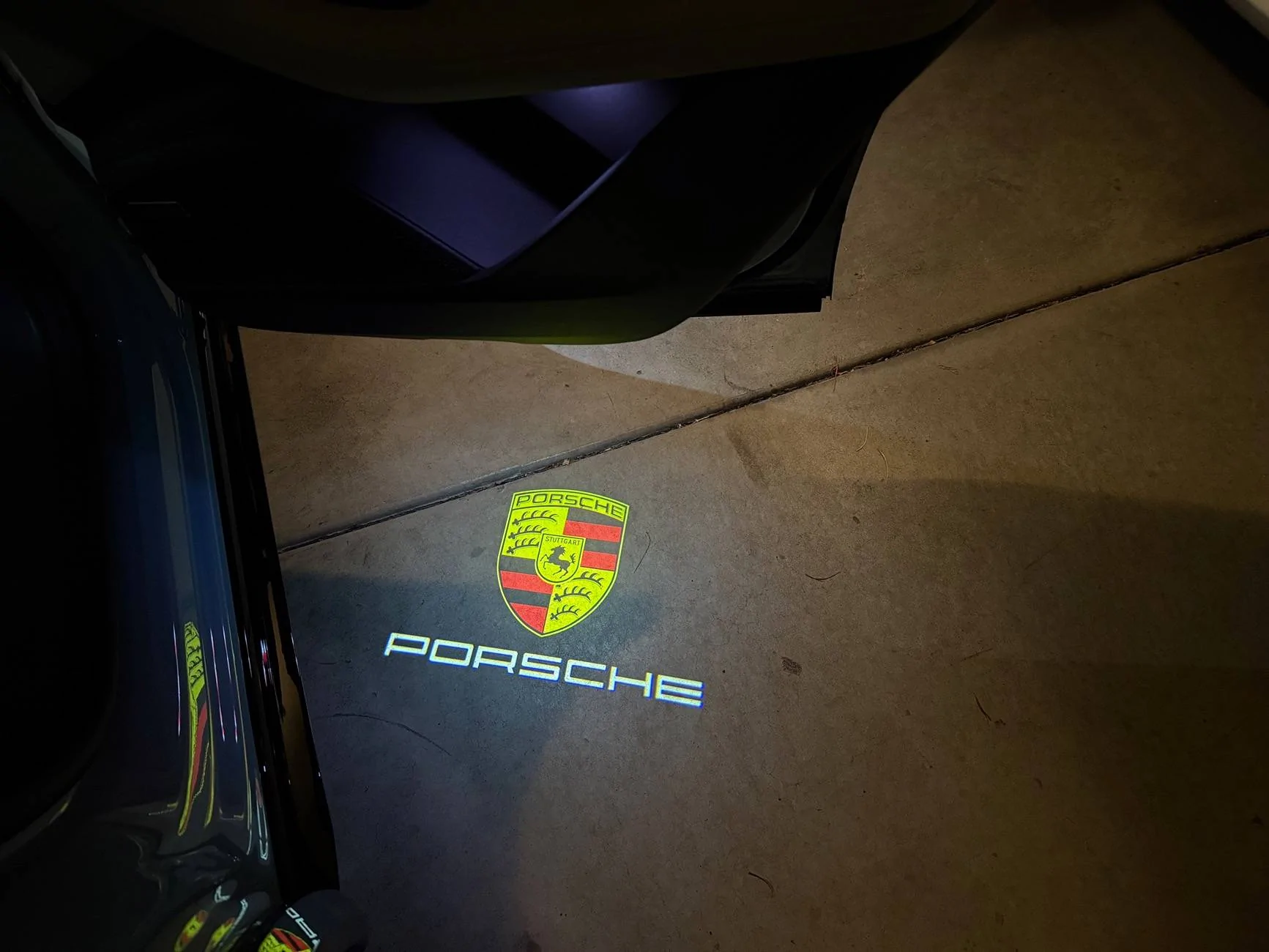

Here a couple of photos of the crest + letters version.
I bought and installed the exact same ones and I can confirm they are exactly as you have them pictured. They look good if you like the logo.
I was not sure about the logo when ordering, but it was low cost, low commitment, since they are easy to swap out. I ordered from the Ali Express LINK listed in this thread.
