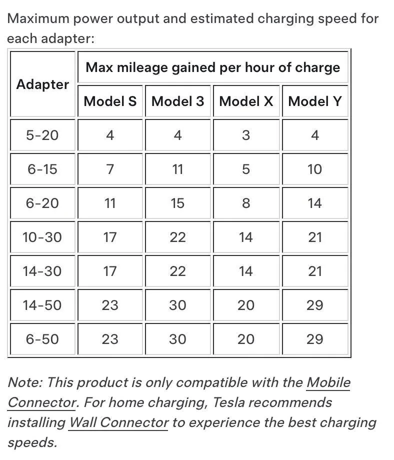

here is a list of adatper types if one want to be "prepared" to charge anywhere - utilization of his full set of adapters will be VERY VERY LOW and I honestly think few if any owners will use _ANY_ of these during their full ownership period - but if one must be prepared this is the set of plug adapters one could choose to travel with so that they could charge _ANYWHERE_ in North America should it be required…
this posting is _NOT_ a recommendation - rather it's a road map for those that wish to understand the full picture what what you'd need to have with you if you wanted to "charge anywhere at any time at any plug'" - this is rarely necessary in 2024 and beyond…but was very very useful in the earlier days of eV ownership.
the EVSE listed below is the best North American mobile EVSE but requires a TeslaTap to use with J-1772 based EV's like Macan/taycan…
https://shop.tesla.com/product/mobile-connector
https://shop.tesla.com/product/nema-adapter-bundle
add a TT-30 and an SS2-50P adapter(s) to the list below and you're fully covered for all your esoteric charging needs!
Electric Macan EV Storage Space Under Luggage Area Screenshot 2024-10-24 at 2.39.28 PM

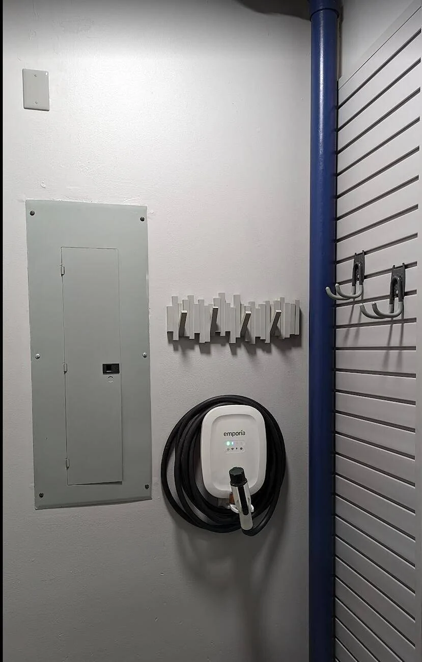

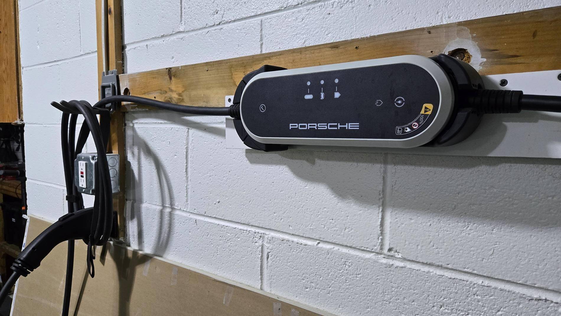

I agree, the post is useful. My point was that the charger is not the best if not the worst for home charging and very clunky for installation and use as a permanent home EVSE.
You can have this mess:
Electric Macan EV Storage Space Under Luggage Area 1729806913499-2l
Or you can have this, with no sockets to overheat, copper wire tubes, or clunky charger holders.
Electric Macan EV Storage Space Under Luggage Area 1729806825343-gk
You can have this clunk:
Or you this is what I have with no sockets, copper wire tubes, or clunky charger holders.
those that know my history know I'm no fan of Porsche EVSE's - but that's kinda irrelevant to this discussion - I also prefer non-porsche EVSE's…
https://www.taycanforum.com/forum/t...uide-to-the-porsche-evse-pmc-pmcc-pwcc.13886/
there are far far better options vs. the PUC included with Macan - but since it's included most owners will choose to use it and not endure the cost/hassle of obtaining an alternative one…although that is my perference and the preference of many Taycan owners.
