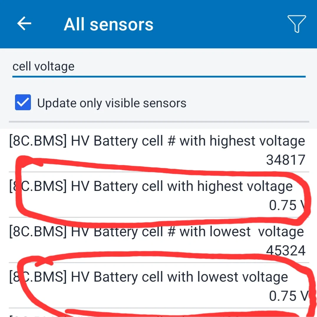

I have seen the battery cells rebalancing only on the top (95% in my case then leave unplugged 10hours). I have done this 3 times and I have seen it working using carscanner.
Here is an example, before rebalancing at 95%, the lowest cell voltage was 0.72v and my car would DCFC max out at 37kw
Electric Macan EV Battery cells reset/rebalancing after erratic SoC readings Screenshot_20260227_083150_Car Scanner

My min and max cell voltages were 0.7145 and 0.7179 at about 75% SOC. I'll check again once done to see if the delta is lowered. I never saw the slower DC charging as I almost never DC charge.

Last evening, I charged finally to 100% and left it overnight to balance. Got in the car this morning, and it's 99% and 334 miles.
CarScanner is telling me a few things:
HV Battery Energy: 90750 Wh - Max Energy: 93650 Wh
Lowest Cell Voltage: 0.7543
Highest Cell Voltage: 0.766
So something is still not quite right, as that's quite a large voltage difference.
Also, the battery temp this morning is 70F. It hasn't been this warm for months, typically in my garage it's between 58F and 65F, so the BMS balancing was generating some heat in addition to the charging heat.
I'll do this again to 100% today after a short drive today to let the BMS do it's thing again overnight.

1-2% voltage difference is not bad and don't expect it to be perfect. I have seen mine being 0.01V off after rebalancing but that does not affect the DCFC speed. I had read a Taycan document that said the BMS triggers rebalancing if the inballance is more than 2%.
I also prefer to stop the charge at 95% instead of 100%, I had seen that worked better.
