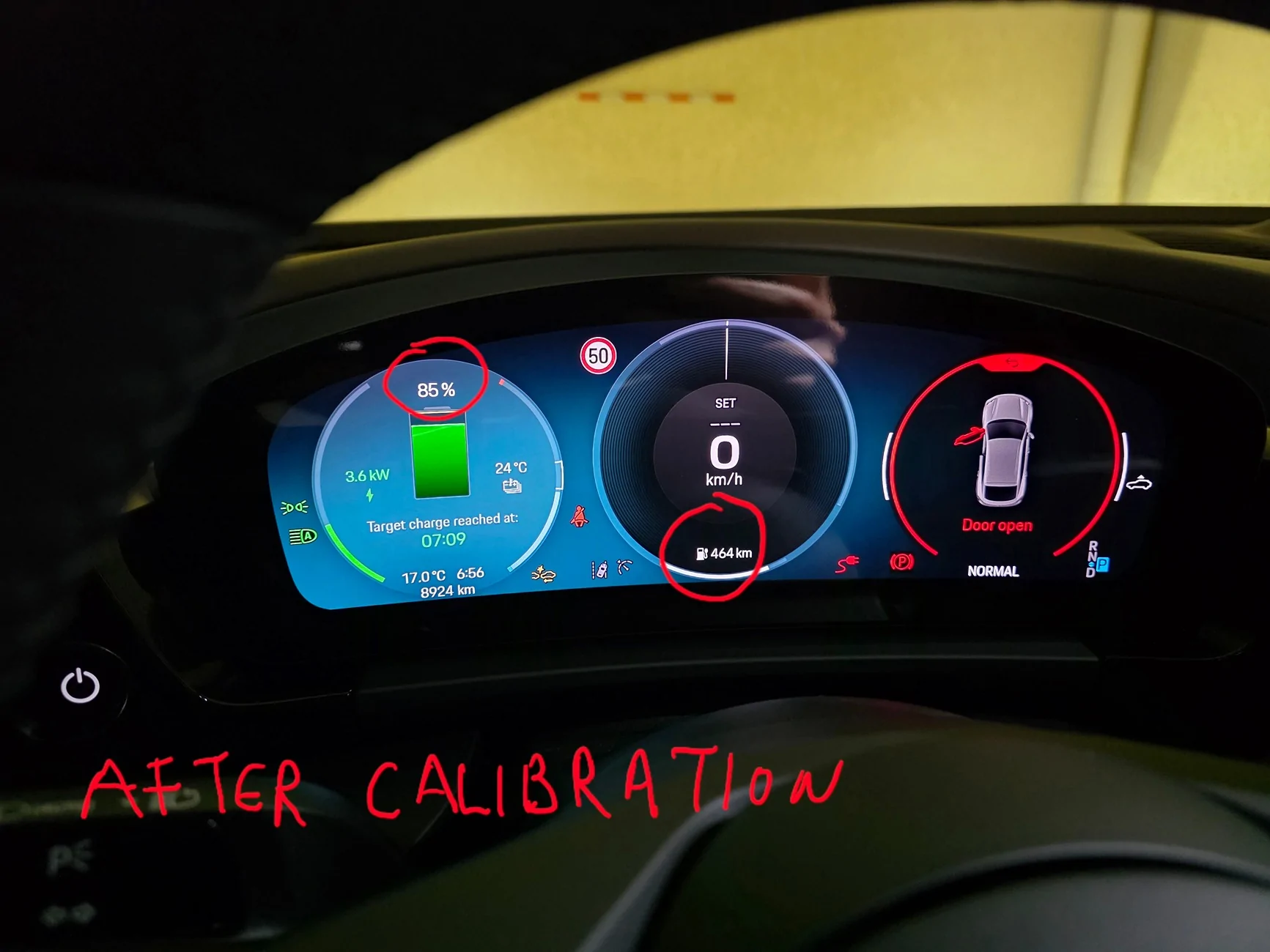

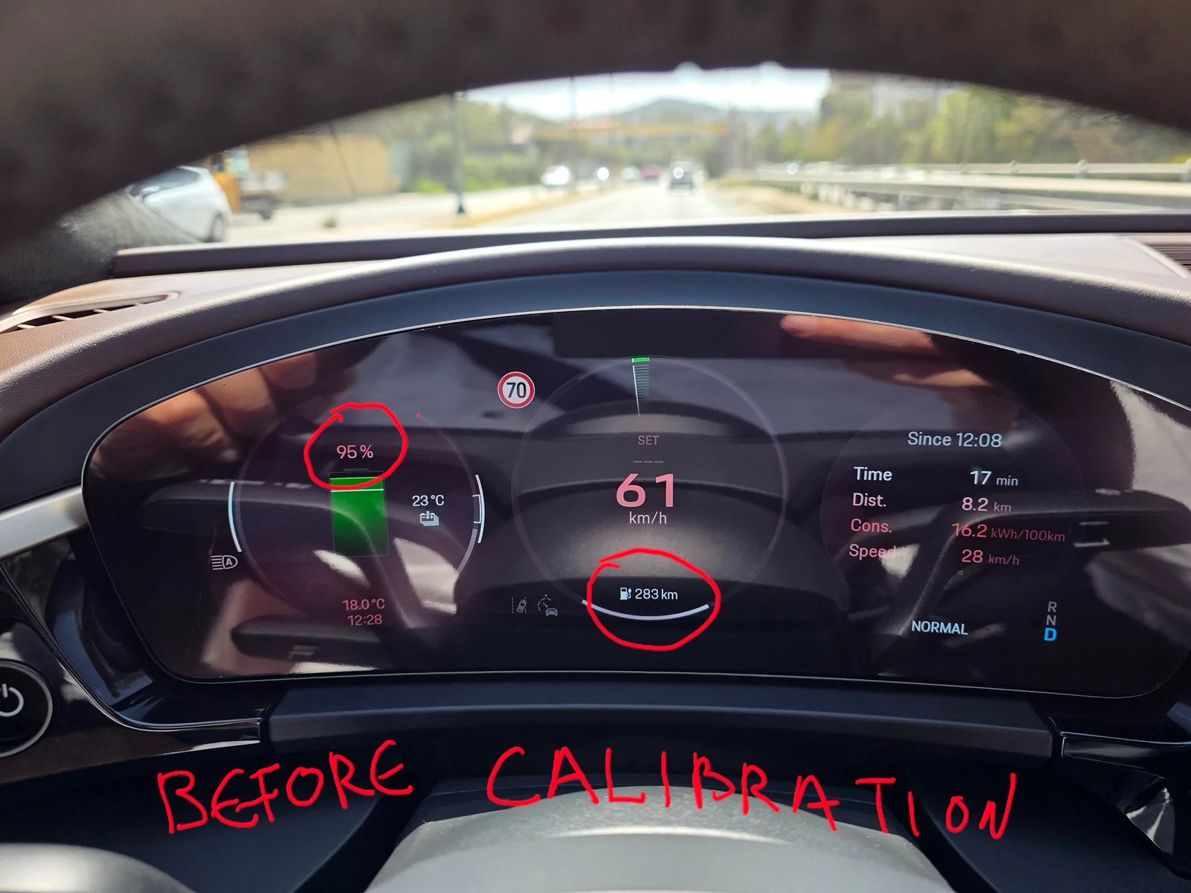

After one year and due to change of user in Porsche center I had to calibrate the battery.It worked well.
Before and After Calibration

Difficult to read everything here, I will make as simple as I can to explain my procedure.
1: dropped to 1%, after about 8 hours resting ,BOOM became 23%!
2: dropped to 4% after about 8 hours resting ,became 14%.
3: dropped to 4% after about 8 hours resting , became 6%.
4: Charged to 100% and keep it plugged for few hours. During charging the time of completion changed 3 times it self, and every time was adding more hours to reach the target of 100%. For example reached 90% and after a while became 73% again, finally 100% and unplugged.
5: After few minutes resting dropped again to 85% and the range became normal.
6: I added estimated due to loses: 3.6KWh x 22hours = 75.6 kWh + 8kwh was already on start= 83.6kwh + 15% missing from totally battery level of my car now, I am very near to the Total battery capacity.
Equivalent to ~540 km at 100% (Display range!)
I hope I helped.
(All numbers are based on rough estimations due to loses etc).

Note that the Battery Management System will rebalance the cells at both low (<20%) and high charge rates (100%). I'm surprised there isn't an official statement or at least a paragraph in the manual about this. You just have to be very careful with ambient temps when going the low route.
Mercedes for example recommends leaving the car at <20% every 6 months with ambient temps >= 10C, so that the BMS can rebalance the cells.

I never had problem so far until Porsche Center changed user to "guest"
They say that BMS will make the calibration as you mentioned, but I am not sure how effective is doing it with this software..I charged to 100% and the results was as per my photo above before calibration.
Later I found this procedure from Taycan forums and it worked at once..Range came back and actual amount of KWh near to the useable capacity as per specification enter the battery..
Before this...For first time, I was 95% and the navigation was saying arrival range 50% for 1.5km distance!!
Not planning to do this all the time..but now i am back on track as I was for a year now, but generally... PORSCHE NEEDS TO WORK SERIOUSLY IN THIS SOFTWARE AND MOREOVER TO TRAIN UNWILLING DEALERS TO DEAL WITH ISSUES AS THEY ARE OBLIGATED.

No bothering at all!
Yes correct, In all steps I let the car rest for almost 8 hrs,(somewhere in the net I saw 6,5 is enough but I let it 8), then I drain further until the last step 3.( Small % changed from the level left the car until next morning). So balanced achieved in low level.
(It looks like in lower levels it is balancing the cells and that is why u may see increased % after couple of hours.
Later I went all they way up to 100%, as the car this way learning the true capacity of the battery, the top end.
I kept it connected even after reaching the 100% for few hours, (Step 4) The high level calibration completed once I reached the Real 100%.. not only by the Soc readings but also by the actual kWh that I load in the battery.(Step 5).
