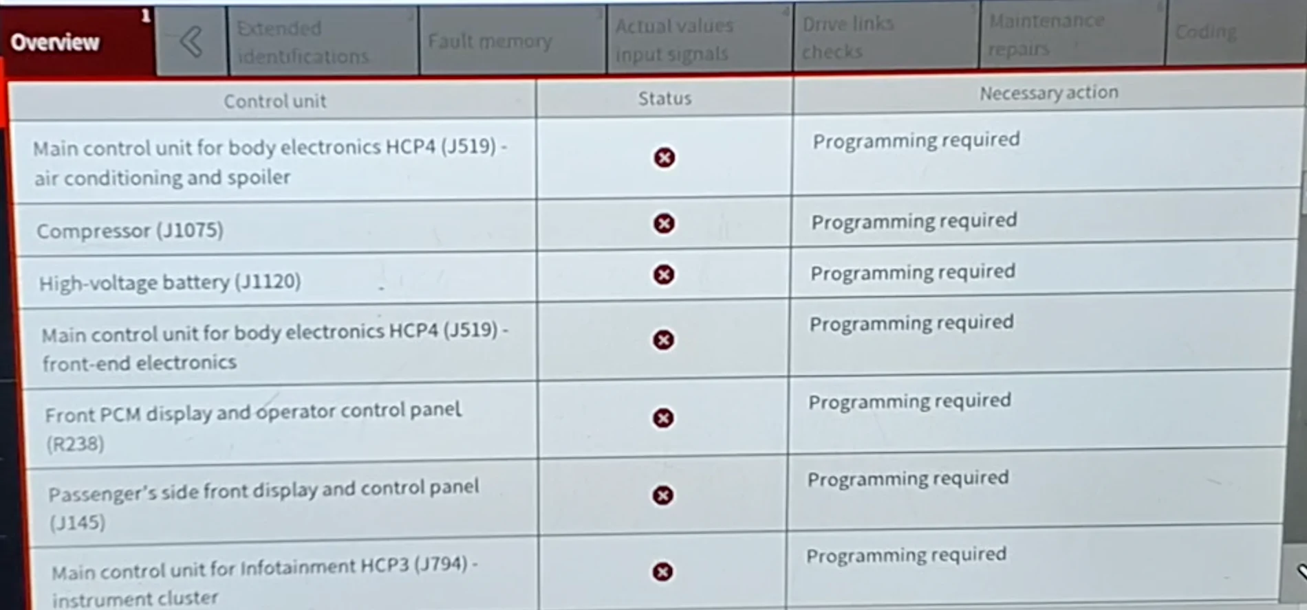

Dealer said they'd run some battery diagnostics but as soon as they plugged the car into their diagnostic tool it showed 7 software updates available including to the High voltage Battery. These are updates since the big 28.13 update in November. Note they said these updates don't show up in whatever system they normally check for available updates, only when the diagnostic tool is connected to the car.
They've installed these updates and given me the car back and want to see if it's made any difference to the SoC issue before investigating further which is fair enough. Car only came back yesterday evening so not been out in it yet.
I'm attaching a screenshot of the updates that have been applied.

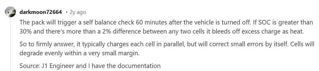

I posted it already in another thread. Issue with SoC loss is most likely this:
Electric Macan EV Battery cells reset/rebalancing after erratic SoC readings 1780169977067-k6
It fits all symptoms reported by multiple owners experiencing this perfectly. If Porsche tries to tell you BS that this is normal it is not. There is ongoing FB poll here: Is your Macan EV losing SoC (battery charge) while parked? Similar to poll on this forum there is 0% SoC drops being reported by very high majority of owners.
If you are experiencing this constantly it just means that there is most likely something wrong with either BMS or battery in your particular car with car trying to fix itself and failing over and over again. If service center is not willing to diagnose and says this is expected ask for official Porsche engineering statement on where exactly 0.95kWh/day (1% SoC) is being used when car is parked, why this behavior stops when car reaches 30% SoC and why was this not happening on your car before. Feel free to also ask why other owners are not experiencing this normal expected behavior. If service center is not willing to provide you with the answer call Porsche costumer support (number for your country is in the app under Account > Contact and help) and demand those answers there alongside with fix.

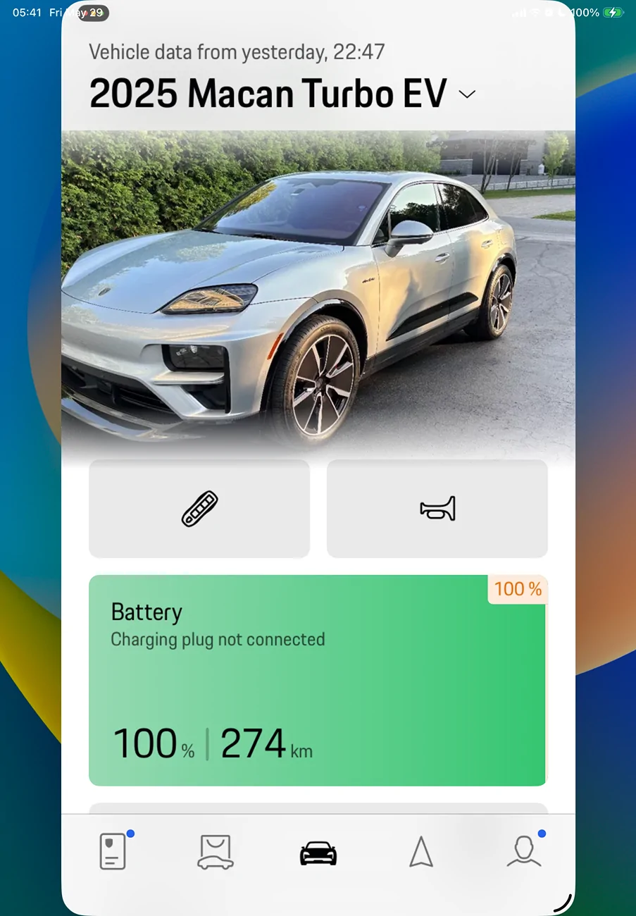

Have a look at my pictures. Does 274 km range @ 100 % look "as advertised" ?

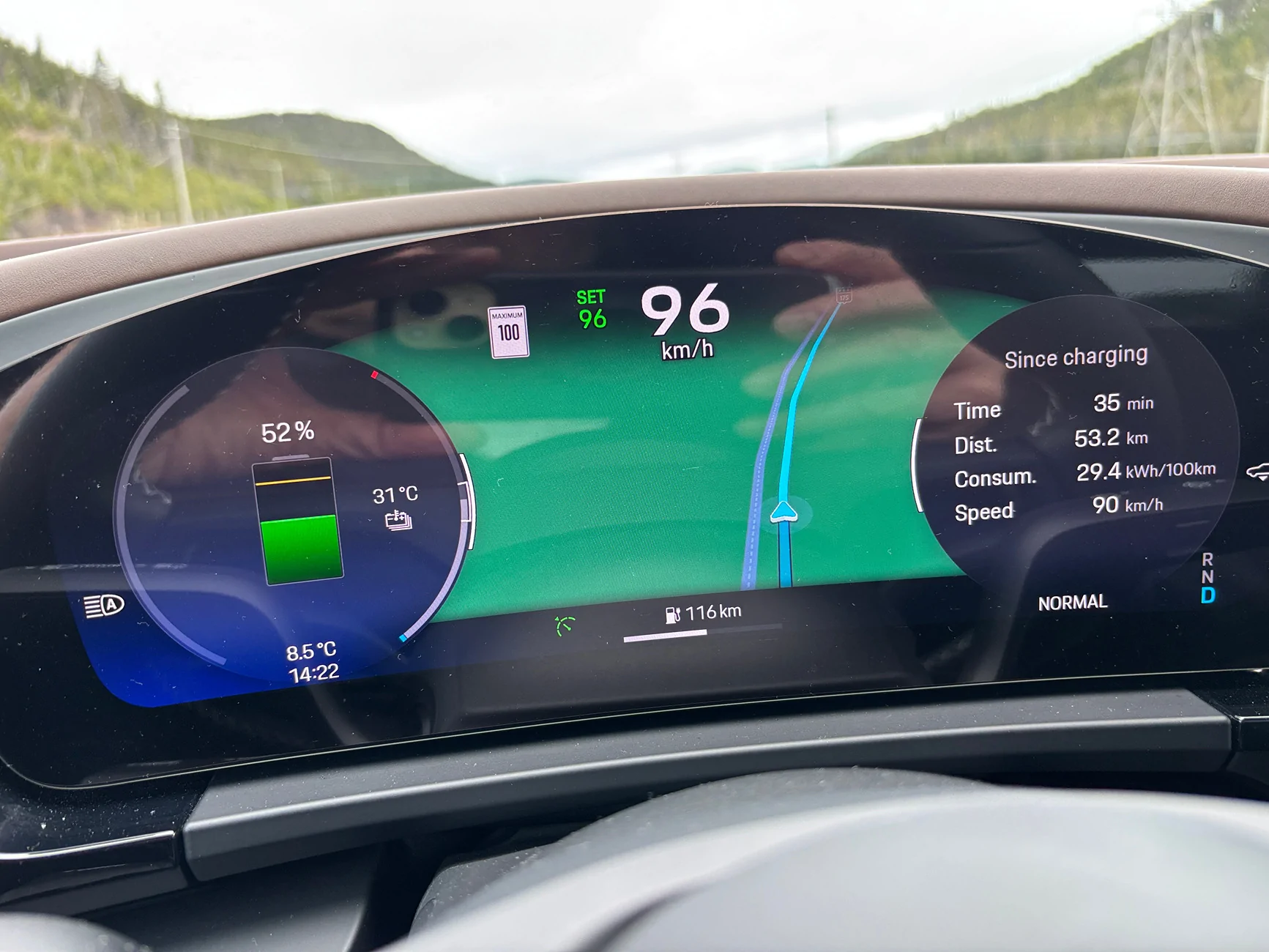

Second pictures shows 52% / 116km and a whopping consum. of 29.4 kWh/100km after 35 min with an average speed of 90 km/h (which is 86 km/h groundspeed). Nissan Leaf's were passing me on the highway!

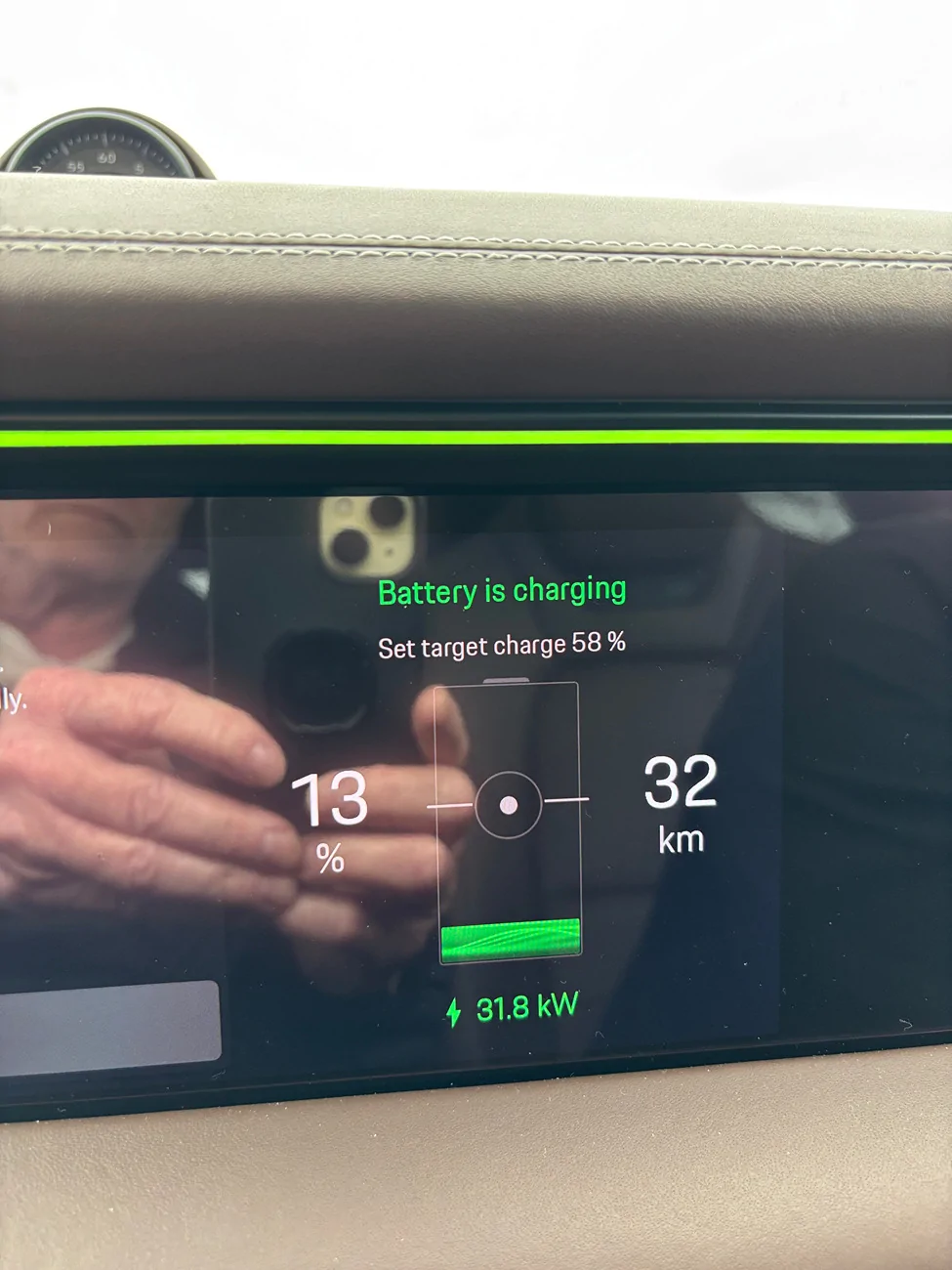

Third picture: check out the recharge rates. At this recharge session, I was plugged into a 180 kWh station with no one sharing. At 13%, I should have been sitting at 180 kWh.
