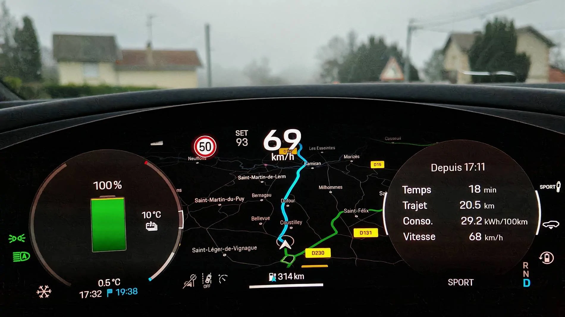

Share a new issue appears yesterday, Macan charged to 100% before a long trip. After 80 kilometers, the battery indicator stick at 100%. The battery's temperature also stick at 10 degrees. The consumption rate at 29kwh/100km told me that I should consume around 25%. I decided to stop the car, close it for 5 minutes and then the dashboard show me 76% left.
Seems to be a communication bug with the BMS, but no warning indicator told me something wrong. Here a picture of what I got after the first 20km.
Electric Macan EV Battery indicator stick at 100% IMG_20241231_173205
Did the remaining range change?

Yes, it was in between usual consumption and battery not going down. On the map also, final destination was estimated at 25% but after 80km it showed 40%. Mainly, I was afraid to be not able to charge at HPC if the car say 100%...
