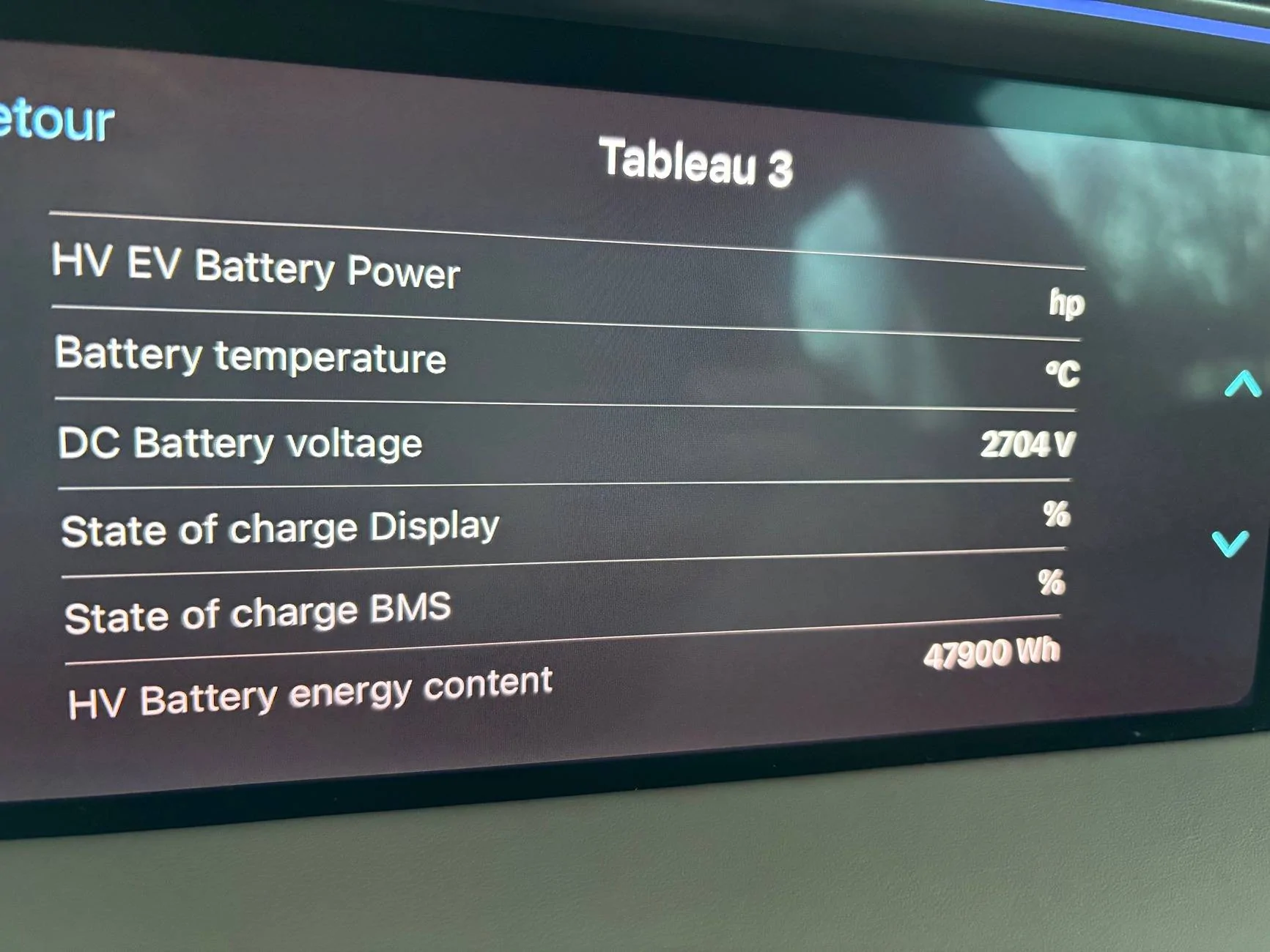

Teslabjorn from Norway recently tested Audi Q6 etron, and managed to connect Car Scanner (with connection vehicle profile VW MEB ID.4), maybe that will work in Macan EV?
If setting Carscanner connection with this VW profile, the information is very partial and disorganized, with transcription errors, particularly regarding the scales.
However, we can draw some values from it, for my Macan:
Maximum energy content of the traction battery: 94350 Wh
Maximum Energy Content of the Traction Battery (according to VW EV forums) is the rough estimation of the SOH and should be measured at 20-25 C.
My battery temp was 12 ° , and if nominal capacity is 95 , my SoH is 94.35/95 =99.3% ...... maybe
HV battery energy content : 47900 Wh SoC of my Macan , 55% on the PCM
DC battery voltage : 2704 v This value divided by 4 corresponds approximately to the voltage of a 700 - 800 v battery.

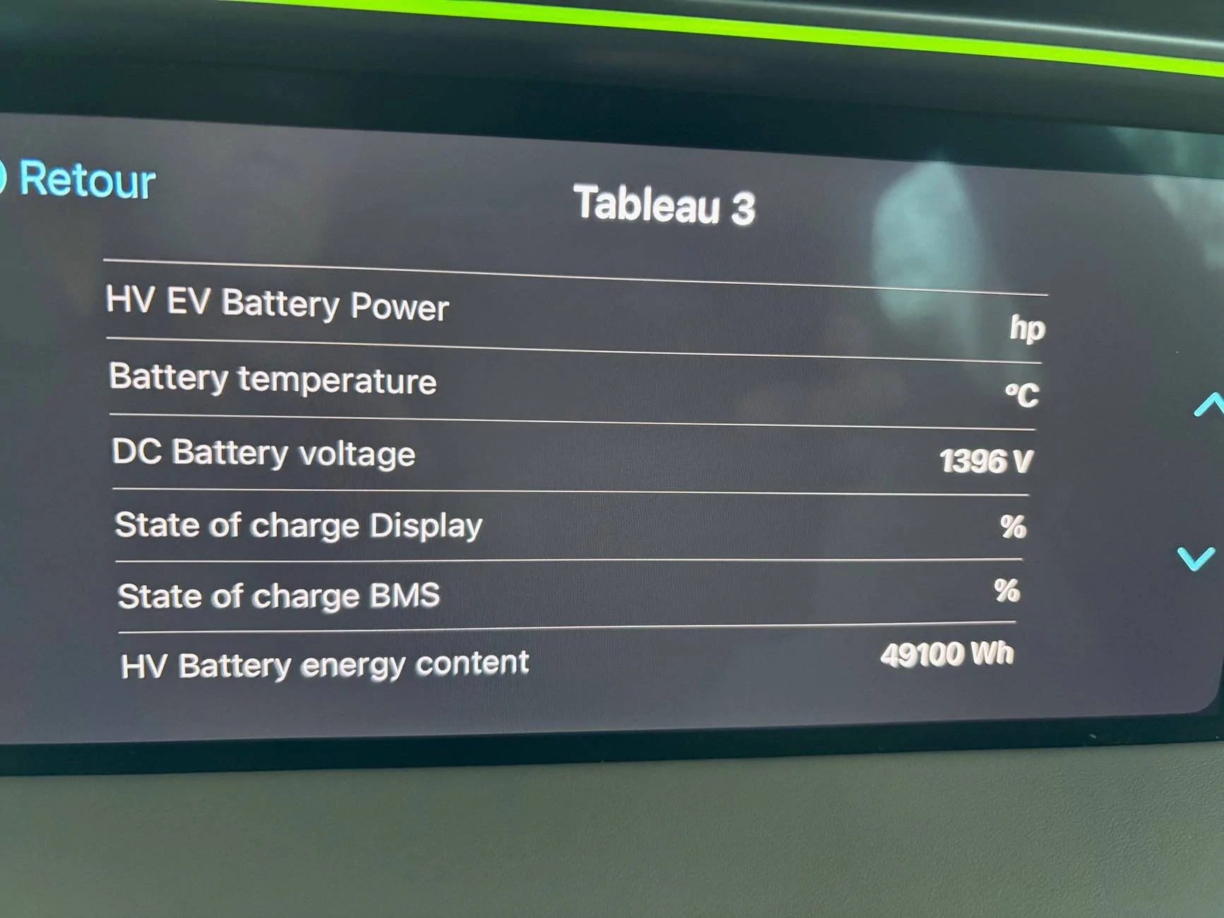

I tried charging at the Tesla supercharger not far from my house, this value went down to 1400 , because of the 800 to 400v split of the Macan ?
Some PCM Carplay view of Car Scanner:
Electric Macan EV OBD to track Battery SOH? IMG_8720
While charging in Tesla station

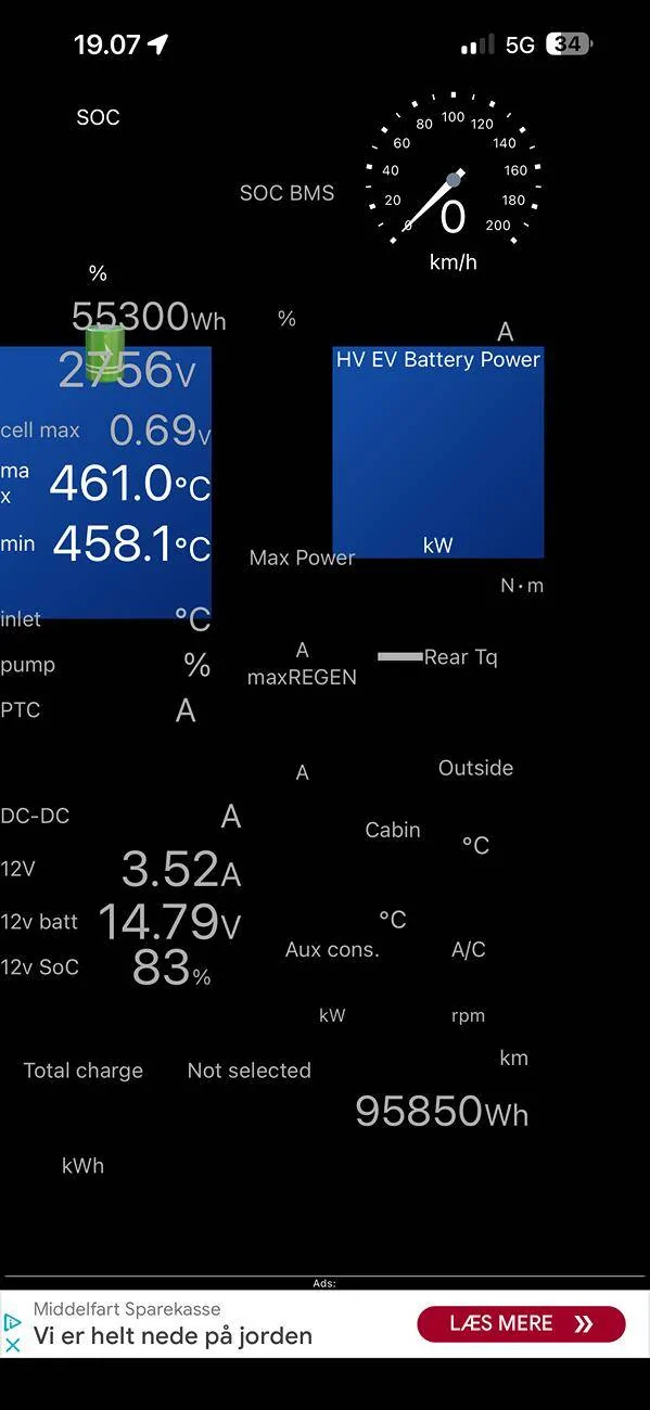

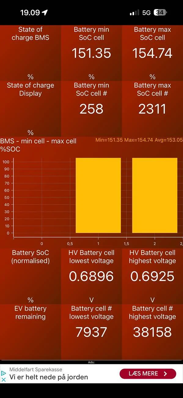

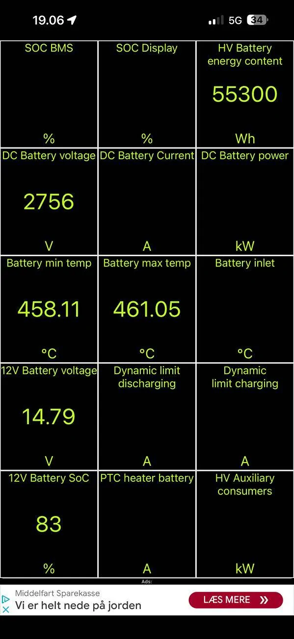

Thanks
I just tried it. My car was at 61% soc and I got the following:
All with car scanner, and the Macan name is under the WV

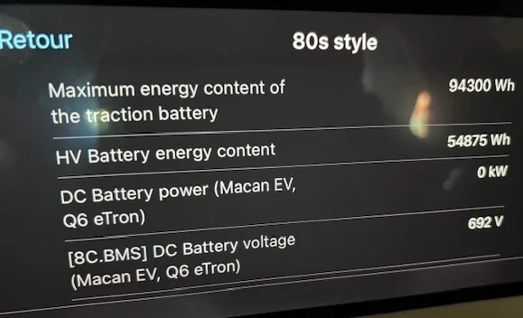

As @ThomasDK did, we can now select Macan EV in Car Scanner setting list.
Result is not awesome ....

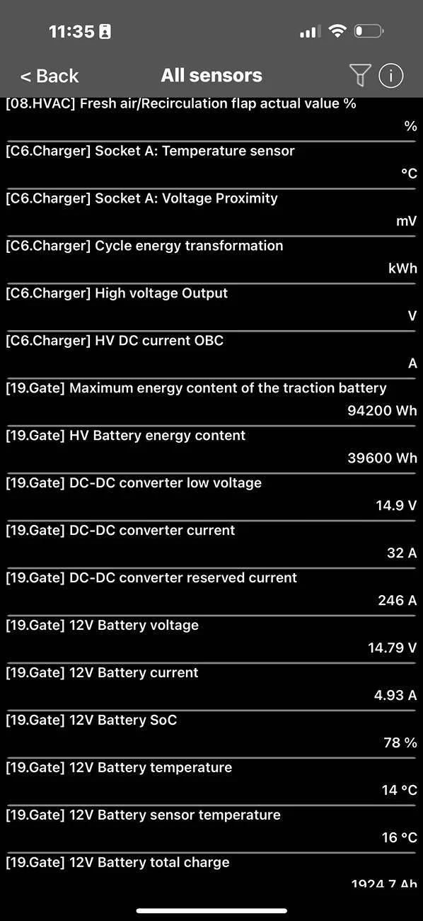

Any updates on this I found my OBD dongle, where is the port on the Macan located?
EDIT:
Found the port same as Audi …
Not great it reports 94200 battery capacity but if I calculate with actual energy content and percentage it’s more like 86kwh, granted 14C but still (46% percent of charge indicated)

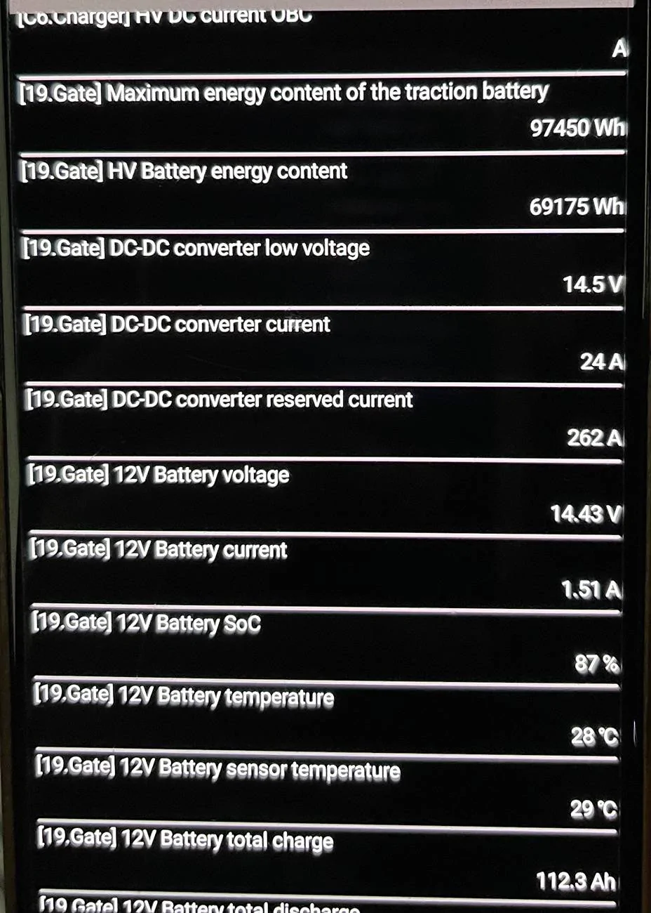

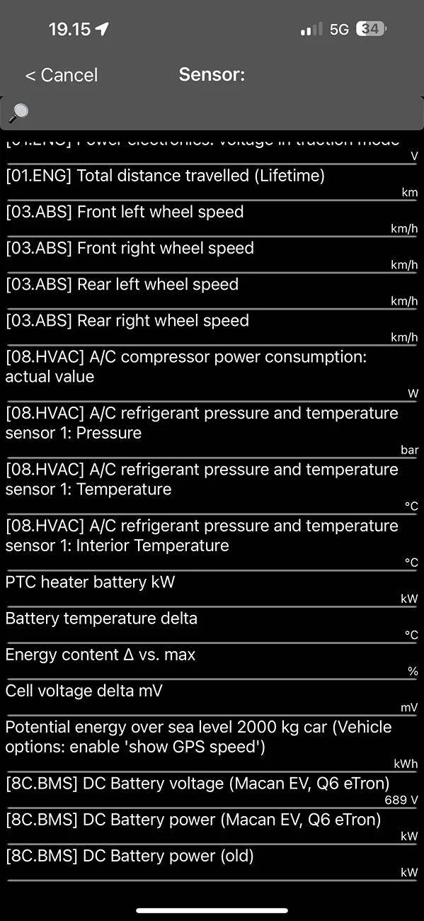

Hello, I was able to connect an OBD dongle to the port with Car scanner and got the same page as Yves.
but the readable information is so low! Is there any other app or way to read more?
brand new Macan 4S it is reporting 97.45kWh as max capacity.

Wow 97kwh max energy content that is cool!
lolli
Jun 8, 2025
Porsche Macan 4S, Tesla Model 3, Fiat 500e
yes! It’s interesting!
Actually next time I will charge it to 100% I will verify if the HV battery content is the same as the Maximum energy value.

3 weeks old Macan 4. Mileage = 1831km
Just gotten my OBD. Forgotten to capture a screenshot.
Maximum energy content of the traction battery = 94300Wh
HV battery energy content = 39875Wh
From the vehicle dashboard showing SOC = 46%.
If we calculate from this information, it means at 100% the energy content = 39875/0.46 = 86685Wh.
An if we take the Max = 94300Wh, it calculated that the SOH is only = 92%.
Does this mean that 3weeks, Mileage = 1831km, the SOH dropped 8%.
How to interpret the measurement?
683
509
@Mavshyn If you see my previous post I came to the same conclusion as you do …
