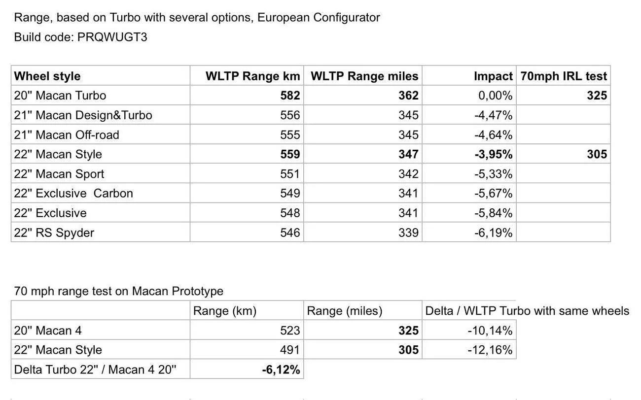

Would the difference be related to the 500 pound load and the 22inch wheels?
I thought I had read somewhere that the EPA numbers are standardized so likely based on one person and the "standard" included wheels which for the Turbo are the 21" Turbo Wheels?

It’s not the cost, it’s the real range to do roadtrips … during the week I need to charge ones at my wallbox, so not really an issue, but I planned to drive this 1000km in a day and stopping every 2 hours is a bit to much …
I would be happy if I could attain the range of other Turbo owners on 22 inch wheels …

Interesting numbers, maybe related to the larger wheels? I’ll monitor when I get my Macan.
Btw, how bad is the road noise and vibration on the 22s? I also chose 22” rims and I keep wondering whether it was the right decision based on some video reviews…
699
521
I have the 20’s and from a moise and comfort level they are at my personal limit … 21’s would be the max size I would consider on this car. But again, this is very personal …
