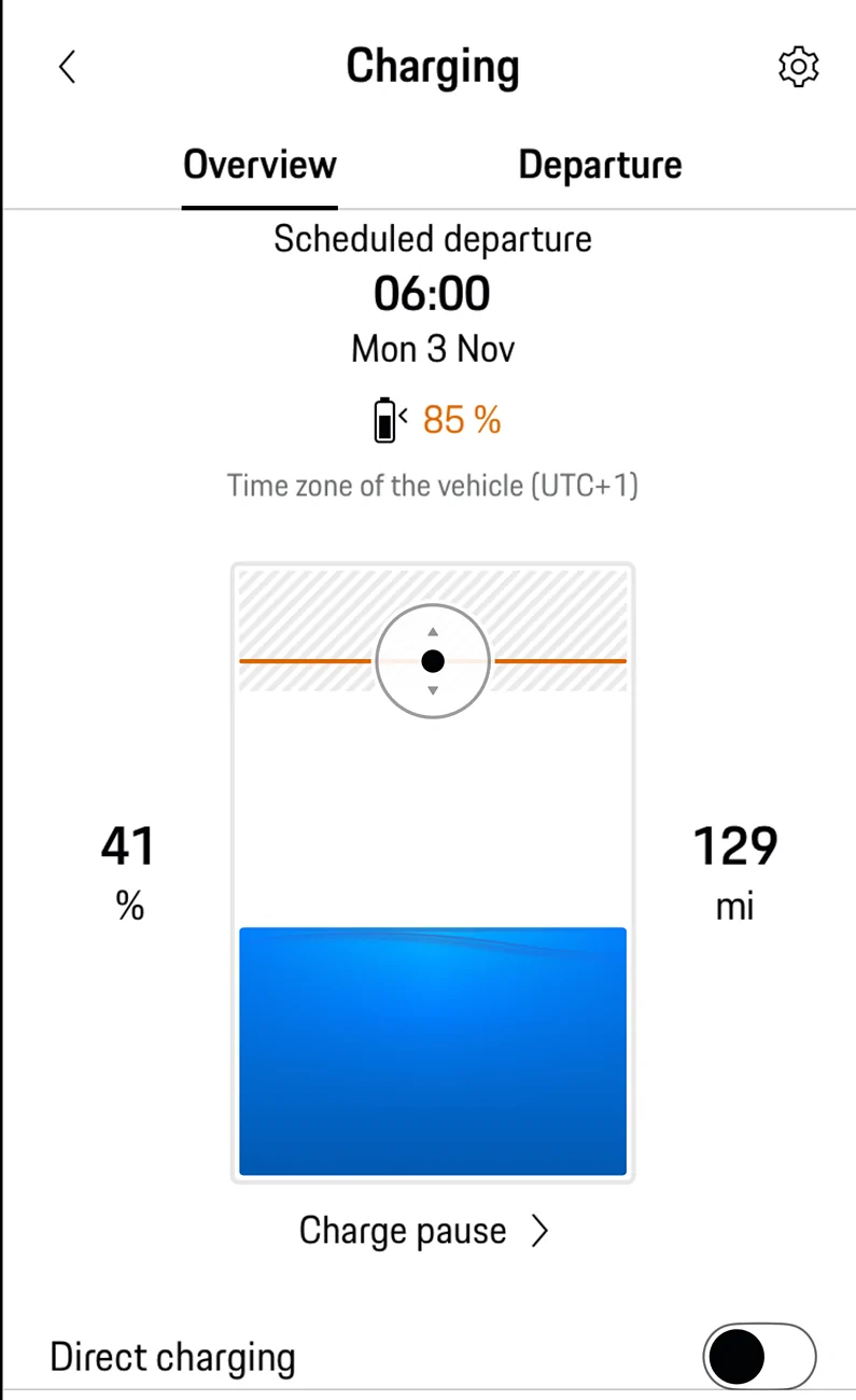

In the UK the times changed from Summer Tim last Sunday. Despite having ‘change time automatically’ selected the car didn’t change. I tried turning that off and then back on but still kept at UTC+1. The app charging had the optimised charging finish 1 hour later too. Changed that manually.
I’ve changed the time ‘manually’ in the car so it is correct but the app still reports the ‘Time zone in the vehicle as being UTC+1. This is messing with my EV tariff ceasing at 6:00am- I have changed it manually in the app.
I‘d appreciate it if somebody else had the same issue and resolved it !

Tried several times in different areas so I know it isn’t the signal. I think they haven’t recognised the 2 different time settings in the UK through the year. It really is irritating as it messes with my EV cheap charging tariff - if I have the correct time by setting manually the car still thinks its in UTC+1.
Graham does your App still say the time in the car is UTC+1. The time in the car is set manually to the correct time but …..l

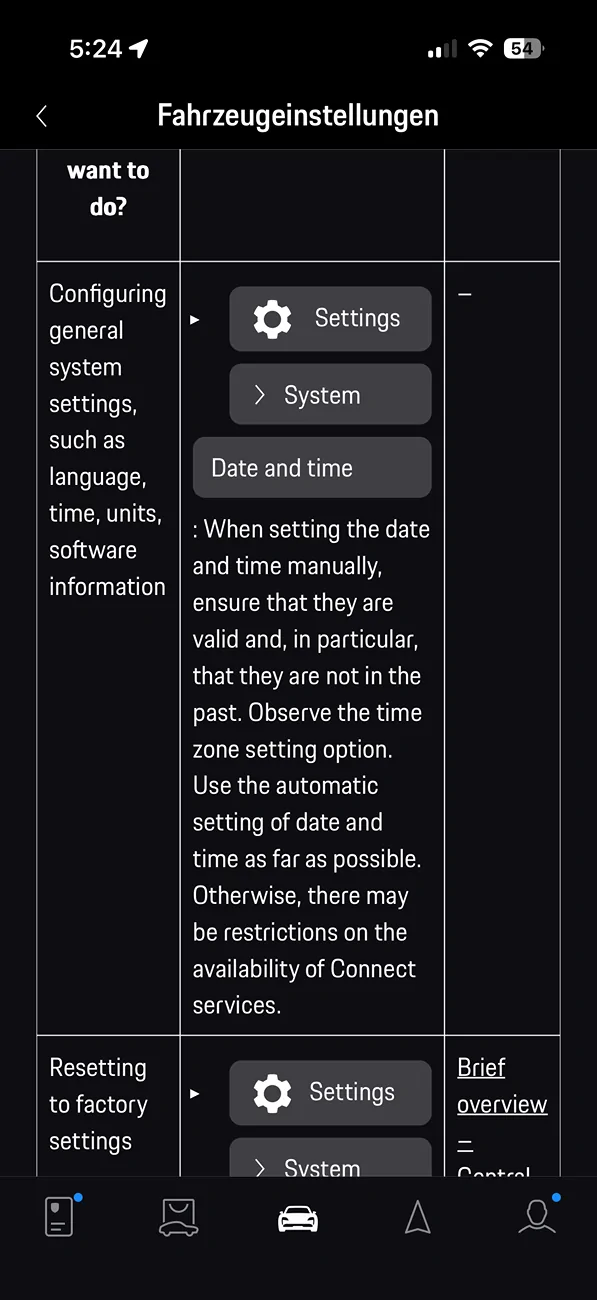

see manual: date & time

Petzi - thanks but that is where I have been changing it and the times are valid.
