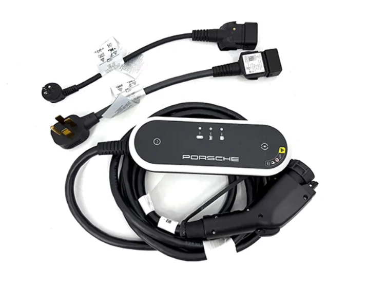

Thanks for the very helpful information, all! If the image below is the Porsche Universal Charger (PUC) that I can expect to be delivered with my new Macan, I agree there doesn't seem to be much need for the Tesla Mobile Connector (TMC), although, at a glance, the TMC appears to be less bulky, with lighter and more flexible cables. Not having seen either in person, though, I can't say for sure.

Thanks @CandianPorsche83 for the comparative photos of the TMC and PUC - the PUC is really not very space efficient and appears to be fully three or more times the size of the TMC by volume. On that basis alone, the TMC is appealing!
again think it through! when will you need it?
if you just leave the PUC at home it doesn’t matter!

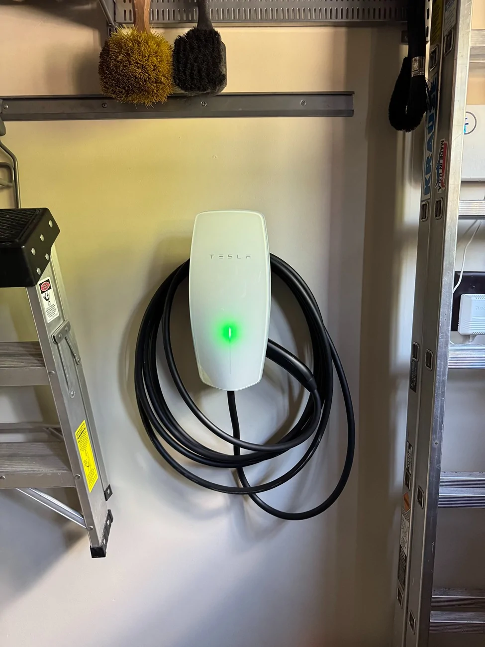

Thanks for your observations @dbsb3233 - I agree that it is best one have a wall mounted unit at home - which is why I installed a Tesla Universal Wall Connector (TUWC) on a 50-amp breaker with 6/2 electrical cable a couple of months ago. The interest in mobile units is solely for identifying the optimal equipment for out of town travel when staying with friends and family who live a good many miles away from any Level III charging stations.
