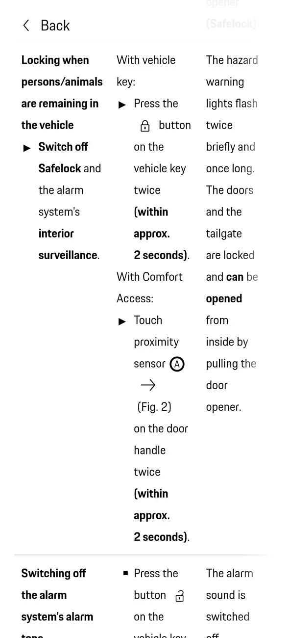

I specifically looked for this hazard warning light sequence after pushing twice. It didn’t appear so I assumed this is not working on the Macan
This is from the Macan EV owners manual.

Think I just found what I was doing wrong. The car must be already locked when you push the lock key twice. I was pushing it twice while it was unlocked. So it takes two separate operations with the key: 1) lock the car normally; 2) push the lock button twice.
