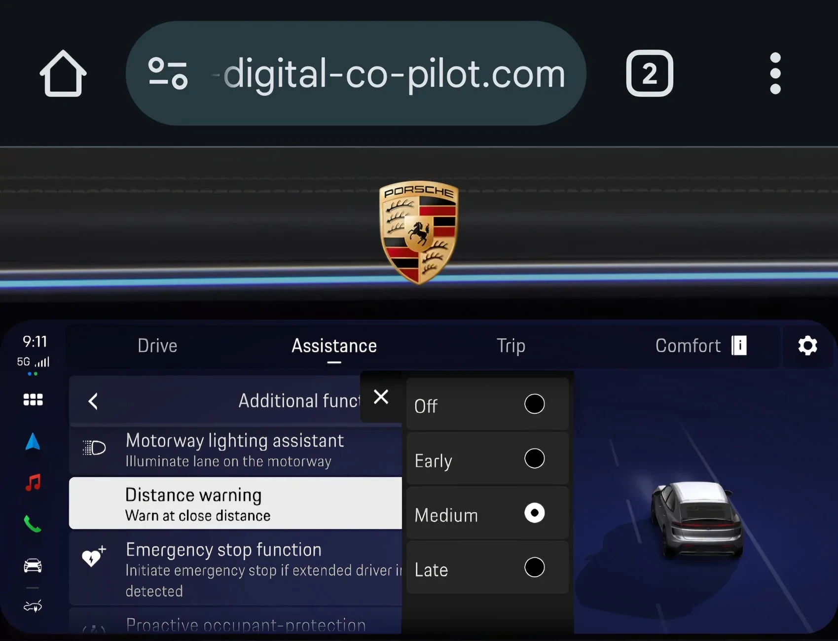

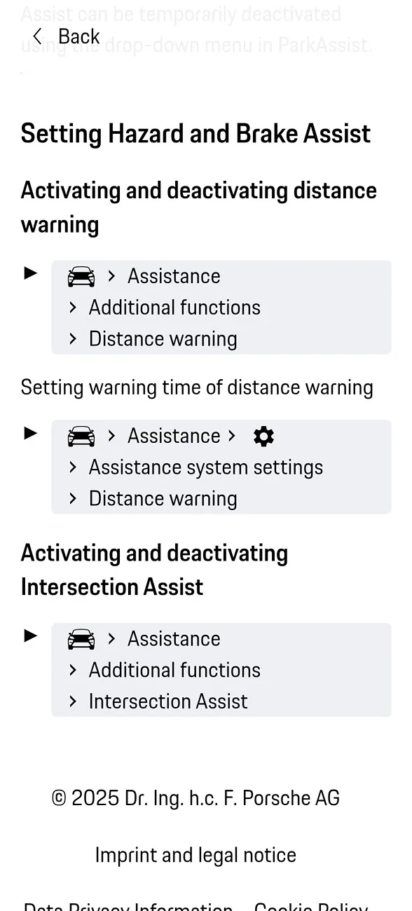

Aren't the settings here - controlled by distance - excerpt
from the manual (read the entire section as the setup is quite extensive).
Settings are Off,, Early, Medium and Late.

I think that is for the yellow exclamation mark triangle when following too close?
