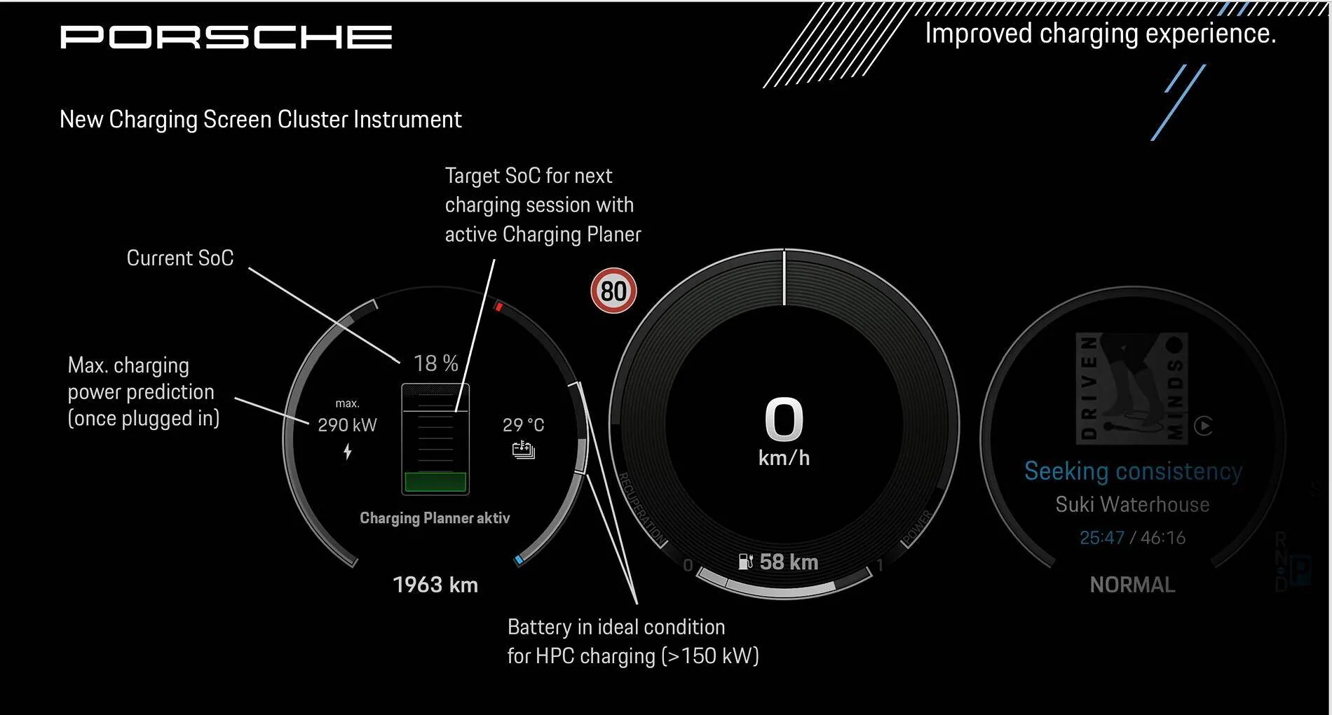

This is not uncommon. All you can do is precondition your Macan EV by making the charger the destination and watch battery temperature go up with a huge benefit of seeing what max charge rate possible in the battery view screen.
I do not have Macan EV or the new Taycan with this revised screen. Very jealous.
This is from 2025 Taycan launch presentation.
Electric Macan EV Electrify America max charge rate 1733519799019-wd

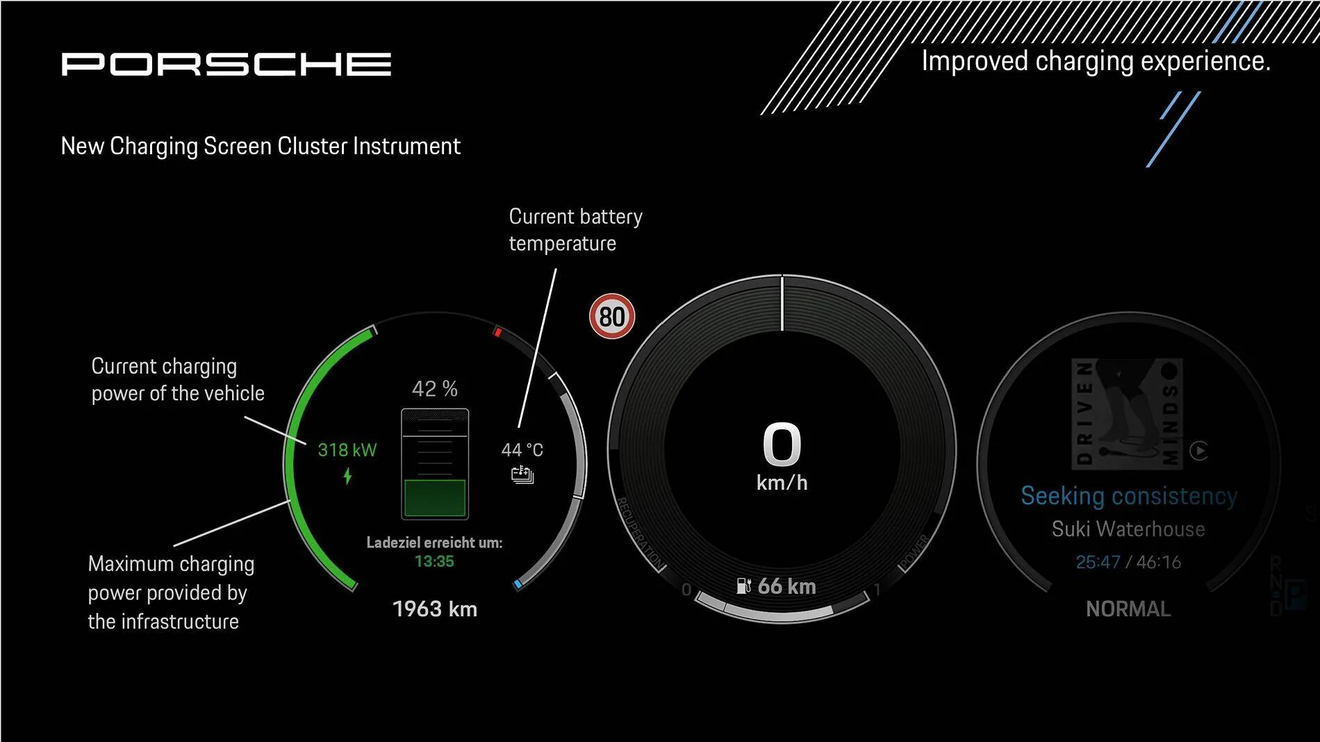

This one is pretty amazingly awesome to me.
Electric Macan EV Electrify America max charge rate 1733522538953-b
