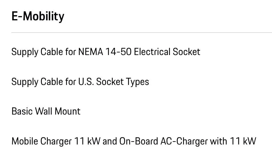

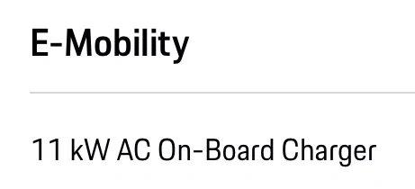

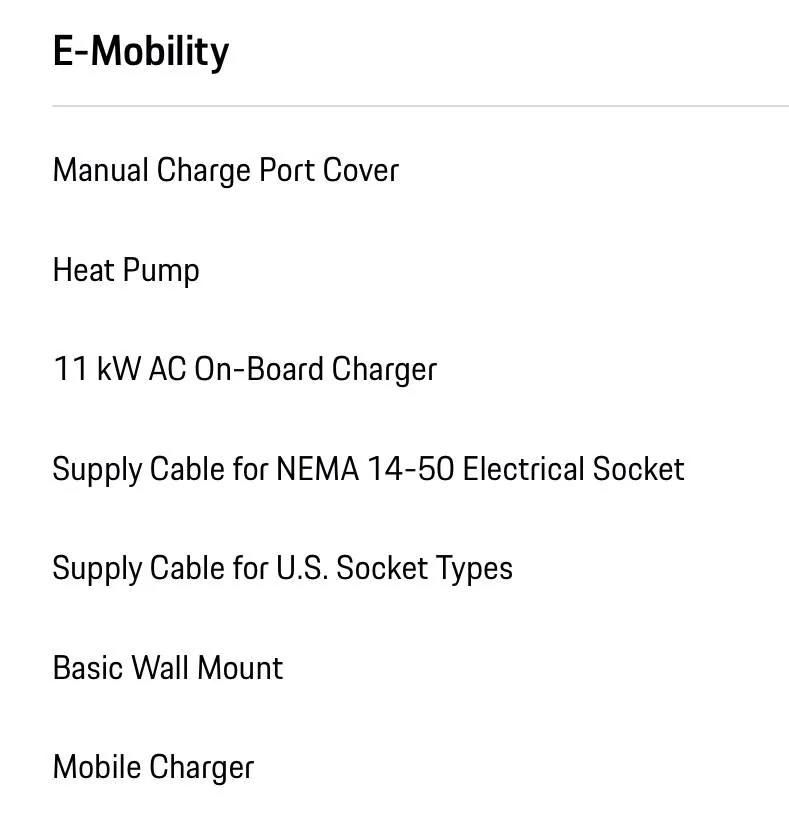

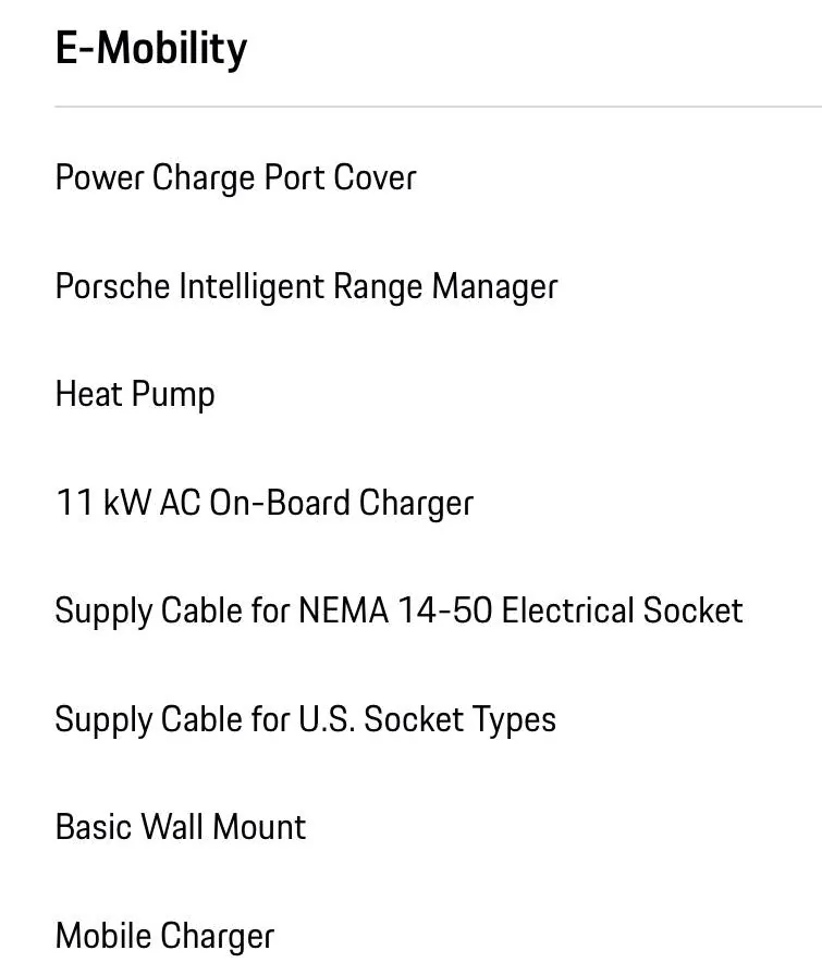

here is standard equipment list for Taycan in USA configurator right now…
Electric Macan EV [Poll] - Porsche charging specification lie?  Macan is not allowing 11 kW max charge rate - capped at 40 amps? 9.6 kW max rate. IMG_2445
here is Macan's standard equipment
Electric Macan EV [Poll] - Porsche charging specification lie?  Macan is not allowing 11 kW max charge rate - capped at 40 amps? 9.6 kW max rate. IMG_2446
and here is Cayenne Hybrid
Electric Macan EV [Poll] - Porsche charging specification lie?  Macan is not allowing 11 kW max charge rate - capped at 40 amps? 9.6 kW max rate. IMG_2447
Panamera eHybrid
Electric Macan EV [Poll] - Porsche charging specification lie?  Macan is not allowing 11 kW max charge rate - capped at 40 amps? 9.6 kW max rate. IMG_2448
NOTE: how the Cayenne lists the included charger at 11 kW - which is:
  1. Impossible for a mobile EVSE in North America
  2. the exact same EVSE included with Taycan & Macan
Porsche is deeply confused about all things charging in North America and has been for a quite a while - they can not get straght the difference between:
  • maximum charge rate of mobile EVSE's in north america (40 amp 9.6 kW)
  • maximum charge rate of the onboard vehicle charger (11 kW standard across the fleet)
  • maximum charge rate of any EVSE in North America (80 amps 19.2 kW)
even though they sell a Wall mounted hardwired EVSE that can provide 19.2 kW or any amount between 12 and 80 amps since it's adjustable…
it's been confirmed with actual North American Porsche products that:
  • the Taycan can actually charge at 11 kW factory stock
  • the 2024 Cayenne can actually charge at 11 kW factory stock
  • the 2024 Panamera can actually charge at 11 kW factory stock
  • the 2024 Macan EV is capped at 9.6 kW
I'm thinking software configuration error in the vehicle's "settings/codes" - and changing this setting would "unlock" the 11 kW charge rate - this is no different than Matrix LED headlights being neutered in North America as Porsche does not yet ship them with the Euro-partial high beam functionality - and changing the "coding" in the ECU "unlocks" the headlights in North America...
wanna bet there is a setting in the Macan ECU/vehicle-codes for max charge rate to match on board hardware? and someone insideof Porsche got confused by the 9.6 kW _MOBILE_ EVSE limit of 9.6 kW?

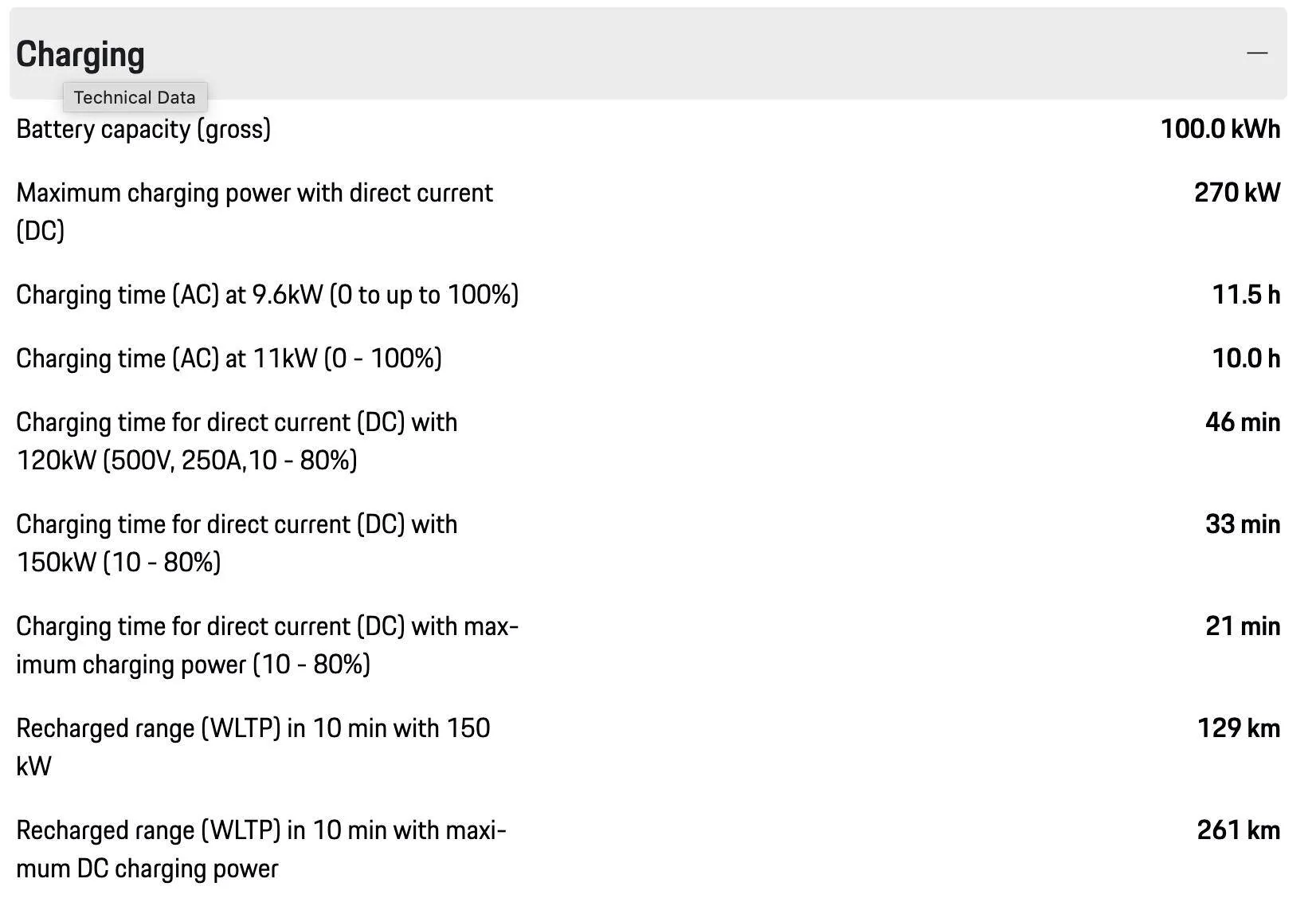

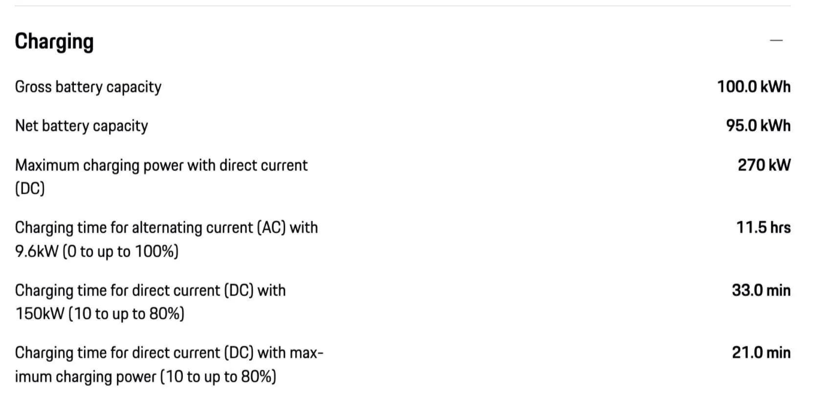

That's the Standard Equipment list but in the Technical Data section (Macan EV) for the USA it states:
Electric Macan EV [Poll] - Porsche charging specification lie?  Macan is not allowing 11 kW max charge rate - capped at 40 amps? 9.6 kW max rate. 1734283501829-1v
But for the UK Configurator it states:
Electric Macan EV [Poll] - Porsche charging specification lie?  Macan is not allowing 11 kW max charge rate - capped at 40 amps? 9.6 kW max rate. 1734283614257-ci
There are similar differences for the Taycan.
Why has Porsche removed the 11KW charge rate timing from the USA specs?
