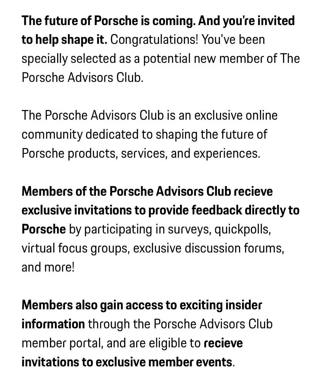

what is this Porsche advisors club? is this something that you need to be invited to?
485
510
I guess you need to be invited to join. Not sure whether it’s a random selection or whether everyone is eventually invited…
