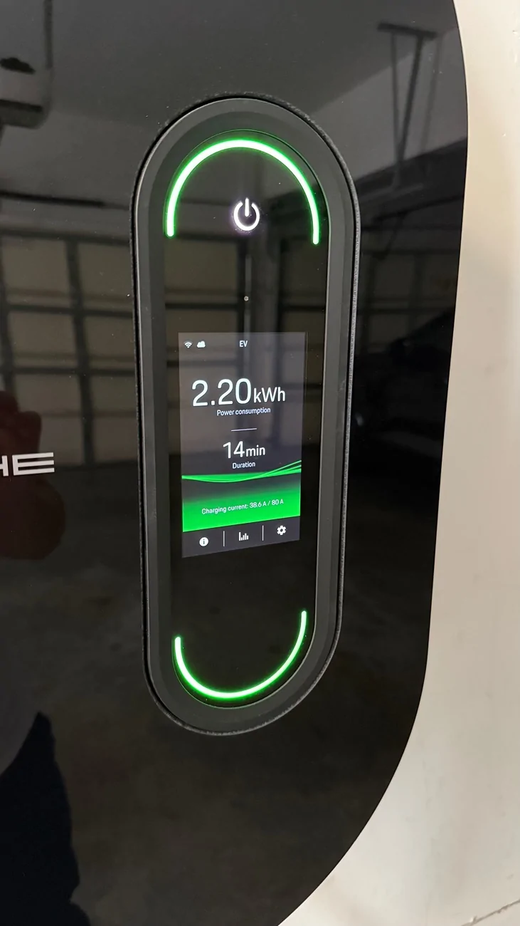

I have a brand new 2025 Taycan and have never been able to get higher than 40A charging. I've tried it on multiple 48A capable chargers: Porsche Wall Charger capable of 80A and two separate 48A Tesla Universal Wall Connectors. Porsche Service center has told me the 9.5kW I'm getting is normal. Porsche customer service has been a little inconsistent, at first they said I should be getting 11kW but then said that my charging rate is expected. At this point I'm asking Porsche customer service to reimburse me for the cost of adding a hardwired charger since I already had a NEMA 14-50 capable of 40A and the mobile charger that came with the car would have been sufficient. We will see what they say but I figure asking them to pay out for their misleading/changing specs is the only way to really get their attention. In the case of the Taycan I'm hoping they can revert the software change that slowed down the speed.

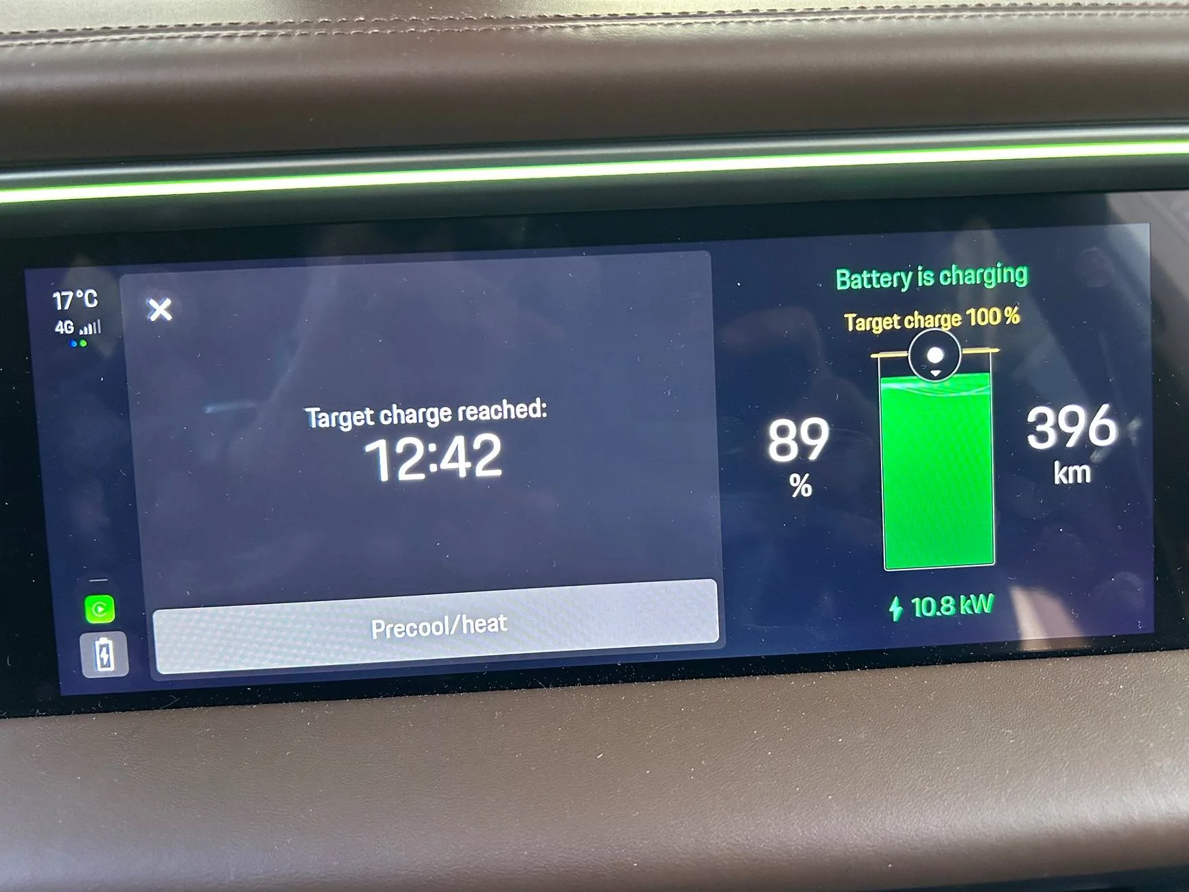

if you're getting more than 9.6 - please update this thread with your Macan model, your region, and the EV Charger (EVSE) you're using - thanks!
and a screen shot from inside the car showing more than 9.6 kW :)
thank you thank you thank you!!! this is extremely useful!!! it proves the that some Macan 's can exceeed 9.5 kW!!
also it indicates the Macan reports close to "raw" input power - not the charge rate after losses (like the Taycan).
sooo useful - thank you for taking the time.
I’m getting the same results for my Macan 4 from a public L2 charger in France (11Kw)

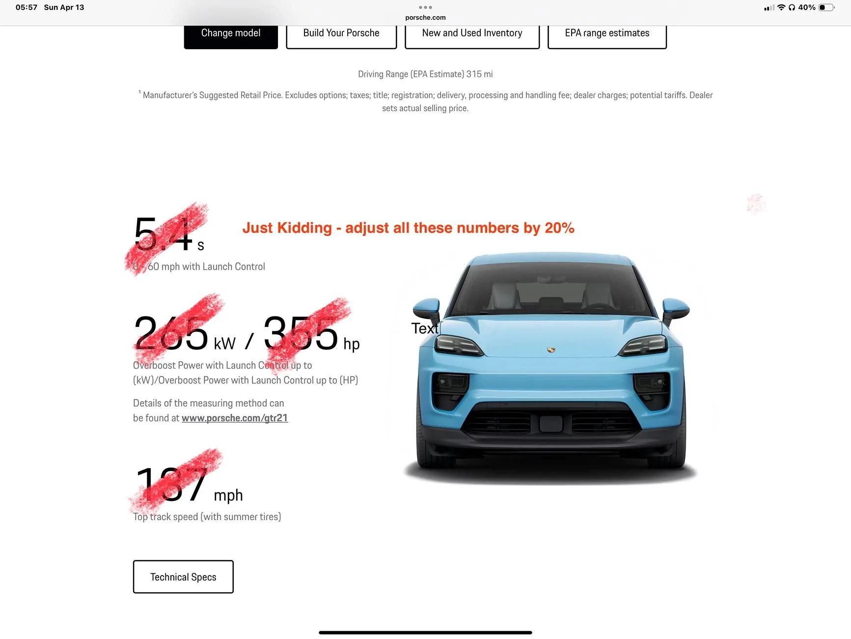

it's a difference of 20% - 48 amps (promised) 40 amps (Delivered)
off peak EV charging window for california residents is only 7 hours…(midnight to 7 am) - after that power is more expensive to charge at home…
7 hours @ 11 kW = 77 kWh
7 hours @ 9.6 kW = 67.2 kWh
time to charge is important - and some people paid more money for their home EVSE install (sometimes a lot more money) to get a 60 amps install (48 amp charge rates) vs. a 50 amp install (40 amp charge rate) based on the published Macan EV specification…
what other specifications are you willing to have Porsche lie/misrepresent by 20% as a key characteristics of your vehicle. Range? Wheelbase? Cargo Capacity? 0-60? top Speed? Passengers? Weight? Towing capacity?
Charger rate (AC and DC) is a key specification of any EV and Porsche can't be bothered to get it right - and they have limited it in only one Region of the world for no technical or obvious reason.
Macan Turbo 0-60 in 3.1 seconds - but only in Europe…in North America it's 3.72 seconds…cause we couldnt' be bothered to understand our product so we limited it in that region only for no obvious reason.
