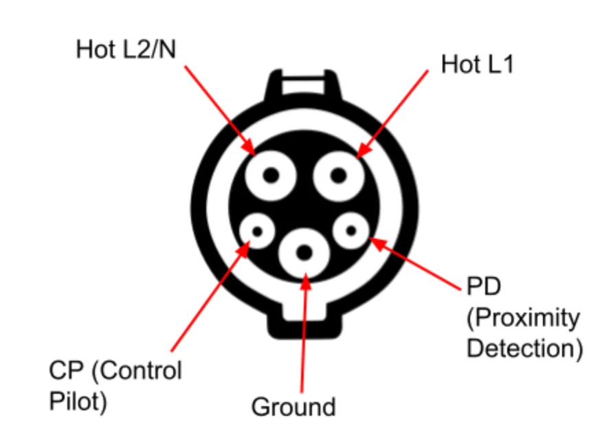

Now on the American market car side you have a J1772 connector (or 2 if you have 2 charging ports like on the Macan)
Electric Macan EV [Poll] - Porsche charging specification lie?  Macan is not allowing 11 kW max charge rate - capped at 40 amps? 9.6 kW max rate. 1757082366340-l3
As you can see from the image above it only has 2 lines L1 and L2/N
This gives you 3 choices:
1) Level 1 charging (120V), L1 + N
2) Level 2 charging (240V), L1 + L2
3) Level 2 charging (208V) (commercial Wye system), L1 + L2 from different phases

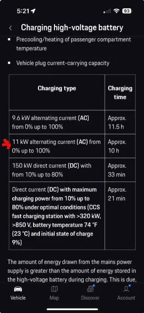

BTW, without naming names, someone claimed that PCNA never "advertised" an 11kW charging time in the US. This is false. I don't blame anyone for not reading through this entire thread, but you can look here. Below is a screenshot of the owners manual I downloaded for my car (a US Macan 4). Do people truly want to continue to claim that Porsche did not miscommunicate on this subject? (I assume if people are simply tired of this subject, they could choose to stop talking about it rather than continue the argument). And also, BTW, in my case, my cable run to my garage is over 150 feet. The difference in cost for a code-compliant 150 foot cable run to support 48 amps continuous vs 40 amps continuous is a bit more than $50. Just saying.

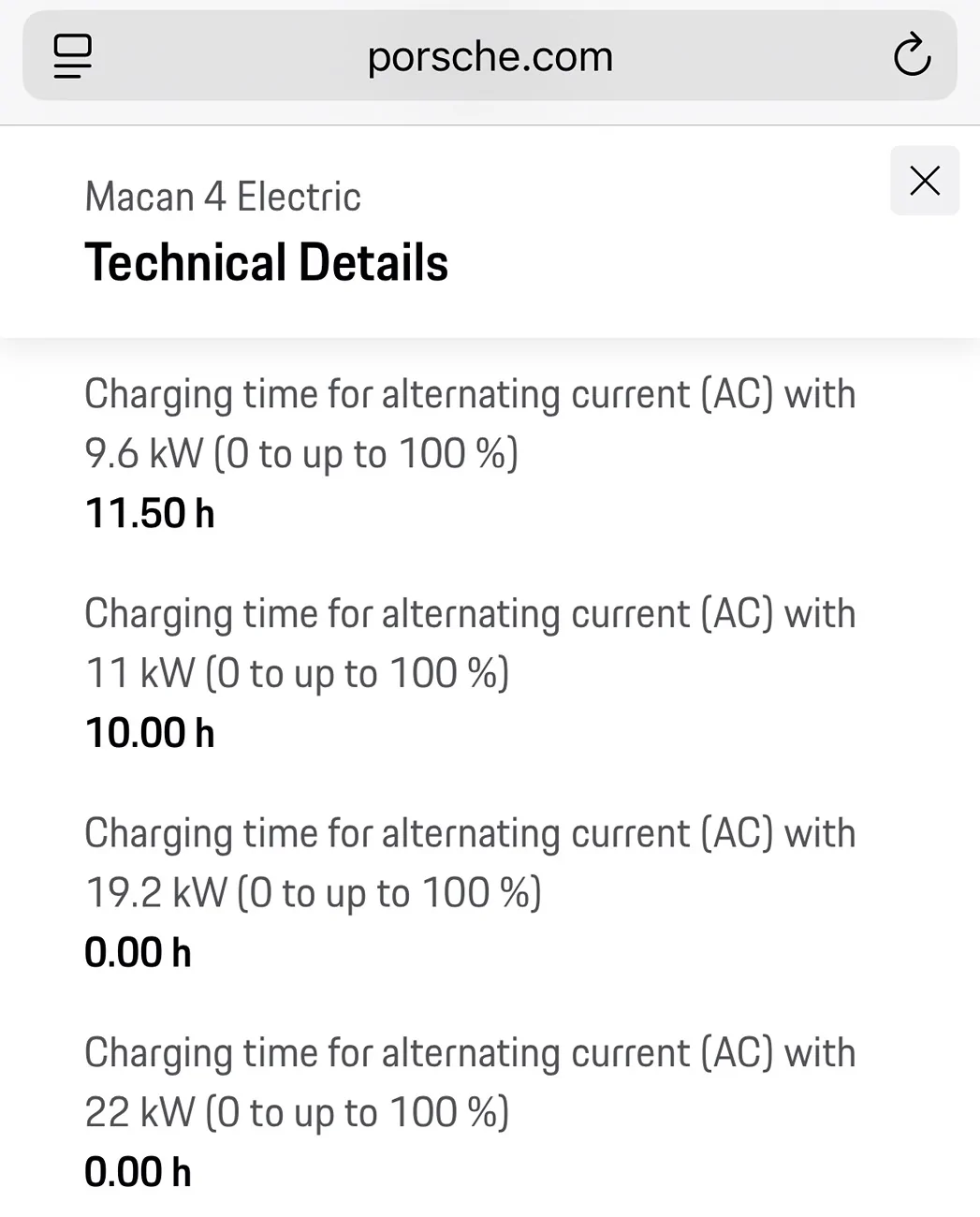

That screenshot is the same in every manual and every Porsche website for all markets. To be 100% clear that is what I see in my European manual for my European Macan.
It simply means 9.6 kW where applicable and 11 kW where applicable and so on and so forth.
Electric Macan EV [Poll] - Porsche charging specification lie?  Macan is not allowing 11 kW max charge rate - capped at 40 amps? 9.6 kW max rate. IMG_1445
It’s a miracle we don’t have folk claiming to have installed a 19.2 kW (NA) or 22 kW (Europe/Uk/etc.) EVSE expecting a full charge in 0.00 h as stated in Porsche Macan website above. J/k

Actually, I give up. I just downloaded the most recent manual, which still shows the 11kW info. It also says "Only charge the high-voltage battery at domestic electrical outlets if no other charging option is available." Above that, it recommends using "industrial sockets." Below that it says, "the excessive use of fast-charging stations (DC) will increase charging times in the long term. Charge in the home environment with alternating current (AC)".
Yes, I could twist and turn to make sense of that word salad, but I choose to surrender.
