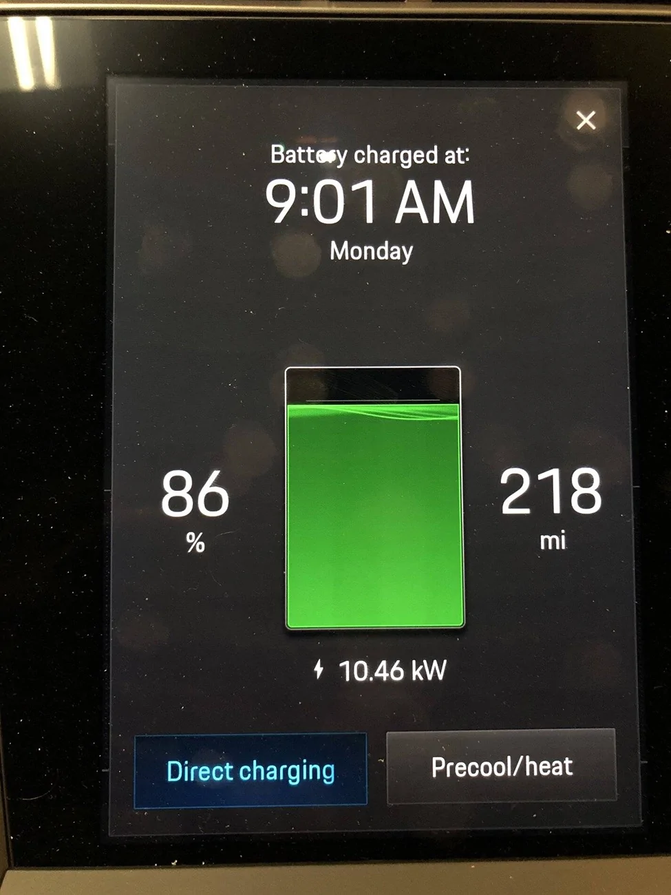

August of 2020 the Taycan charge at over 10 kW as reported in the vehicle - with provided with 9.6 kW charger (40 amps) Taycan reports 8.68 kW charge rate - at that time we all learned Taycan reports power being delivered to the battery post loss - not the raw "input" power…
if the car "reports" it's charging at more than 9.6 kW then it's more than 40 amp charger - 9.6 kW _IS_ maximum power for 40 amp circuit - and if the OBC was limited to 9.6 kW it would never charge at 10.48 kW which only makes sense when the EVSE is supplying 48 amp @ 240 volt - or an 11 kW raw AC power rate…
EVES's that show the raw AC power delivery have always shown Taycan taking raw 9.6 and 11 kW loads depending on circuit size/configurations…

here is my 2020 Taycan charing from a 40 amp EVSE (50 amp breaker) - it reports 8.6 kW which is about right for 9.6 kW raw AC power rate once you account for charging loss's
Electric Macan EV [Poll] - Porsche charging specification lie?  Macan is not allowing 11 kW max charge rate - capped at 40 amps? 9.6 kW max rate. IMG_1926
here is my 2020 Taycan charging from a 19.2 kW EVSE (80 amp charge rate, 100 amp breaker)_10.46 kW which is about appropriate for charging losses…
Electric Macan EV [Poll] - Porsche charging specification lie?  Macan is not allowing 11 kW max charge rate - capped at 40 amps? 9.6 kW max rate. IMG_1927
same car, same OBC, different EVSE's - one configured for 40/50 amps, and one configured for 80/100 amps - I got the same 10.48 kW charge rate on a 48/60 amp EVSE with my standard Taycan (the 19.2 kW option was not available for 2020 MY).
