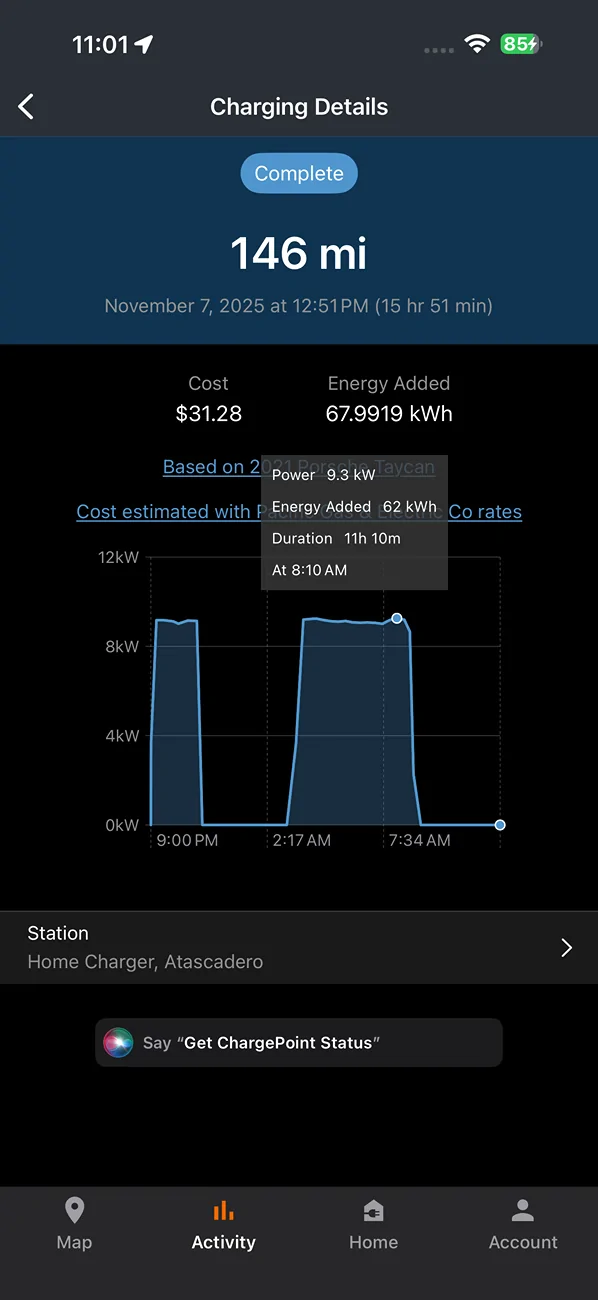

Well I too, who has a build going for a 2026 Macan EV saw clearly the 11kW OBC but also saw lots of inconsistencies also showing a 9.6kW OBC. I wrote to the Porsche North America spokesperson, shortly after the online configurator was cleaned up showing only a 9.6 kW OBC.
Earlier posts speak of the Taycan, I had a 2020 Taycan 4S and a ChargePoint home flex hardwired and configured as 48A. Below you can see the Taycan taking 11kW and a Macan EV loaner pulling 9.3kW. My house voltage runs around 235VAC. The Taycan only shows 10.5kW but that is to the battery after losses.
Taycan:
Electric Macan EV [Poll] - Porsche charging specification lie?  Macan is not allowing 11 kW max charge rate - capped at 40 amps? 9.6 kW max rate. IMG_9954
2025 Macan Loaner:
Electric Macan EV [Poll] - Porsche charging specification lie?  Macan is not allowing 11 kW max charge rate - capped at 40 amps? 9.6 kW max rate. IMG_9955
I don’t want to make a huge deal of this, but I am disappointed that Porsche was unable to provide an 11 kW on board charger for a vehicle in this price range. Note that the new 2026 Chevy Bolt EV coming out at under $30,000 has a 11 kW on board charger for the USA market.
