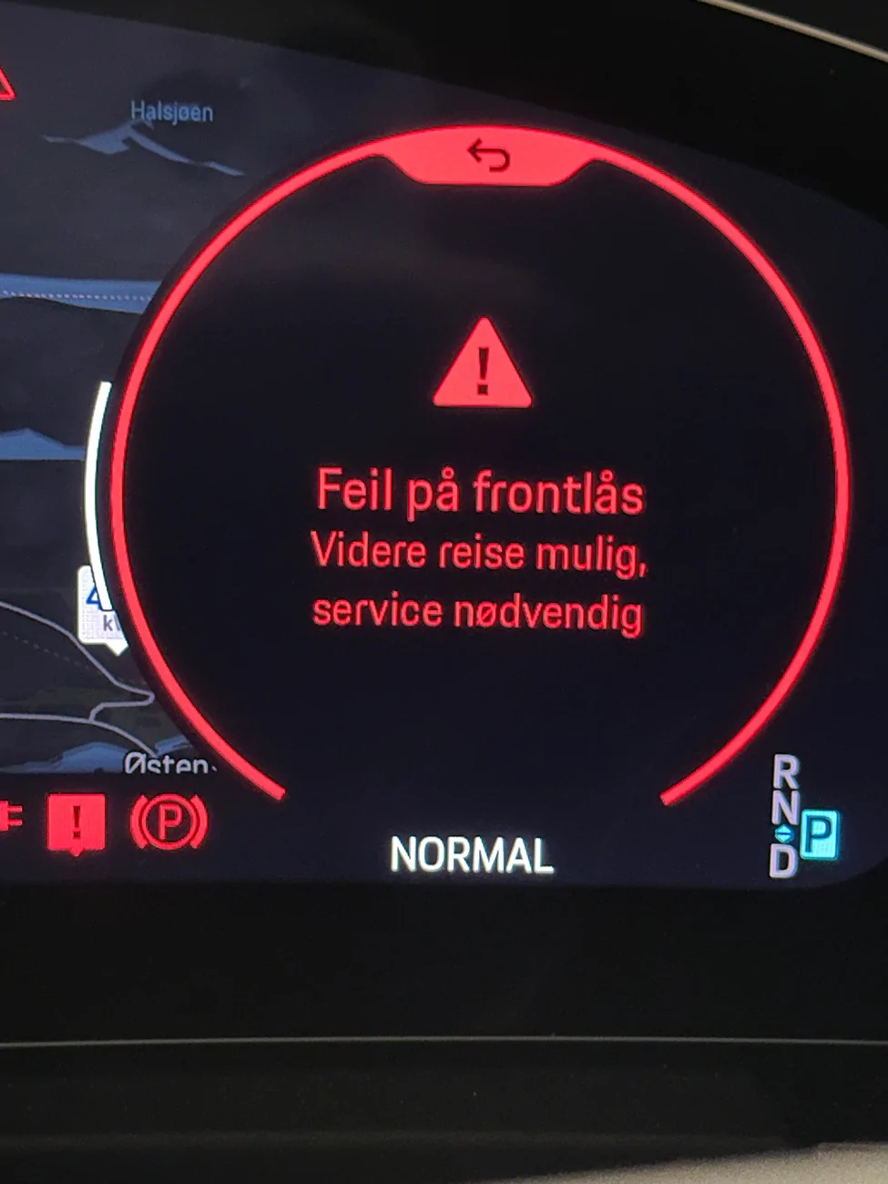

Hi. I have a 2025 Macan 4S and just returned from a mountain trip here in Norway. Want to unload the car and hear the electronic sound from the lock, but hood won’t open. I get an alarm and a red warning lights up in the dash (picture says in Norwegian: fault on front lock, OK to drive, service needed). Anyone had same problem, and is there an mechanical back-up?

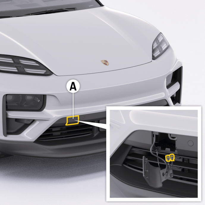

Performing emergency release of the front hood
If the starter battery is discharged, the front hood can only be released with the help of an external battery with 12 V nominal voltage.
See chapter “On-board battery
Electric Macan EV Front hood lock jammed img12ac02178e24f47d8d24c0b37cb41857_1_PNG300
Fig. 1 Performing emergency release of the front hood
  • Battery with 12 V nominal voltage present
  1. Press plastic cover A (Fig. 1) on the upper edge of the bumper until it releases.
  2. Pull the plastic cover out of the bumper. The electric cables of the emergency power supply are fastened to the lid.
  3. Remove protective covers from the negative terminal - and positive terminal +.
  4. First connect the negative cable - and then the positive cable + of the external battery to the corresponding terminals of the emergency power supply.
  5. Press and hold the button
    on the vehicle key for about two seconds.
    – or –
  6. Hold the mobile device with the Porsche Digital Key or Digital Key Card to the door handle of the driver’s door (NFC function).
    The front hood is unlocked and opens slightly.
  7. Disconnect the negative cable - and then the positive cable + for the external battery.
  8. Slide protective covers on positive terminal + and negative terminal -.
  9. Push plastic cover A (Fig. 1) back into the bumper until it clicks into place.

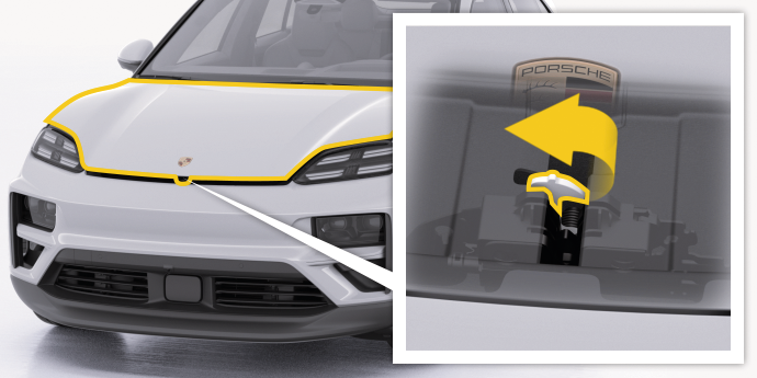

  10. Swivel the securing hook away to the left using a suitable tool and lift the front hood.
    Electric Macan EV Front hood lock jammed imgfbd5673065daae568d24c0b35eef002c_2_PNG300
    Fig. 2 Push securing hook to the left
NOTE: You should be able to jump straight to the final step (#10).

This is if the 12V battery is discharged. Mine is fine and I can hear the electric lock working as normal. But the hood is not moving (and is not possible to open manually). But thanks for a informative reply.

If you can hear the solenoid moving but the frunk is not opening then the safety lock is probably not retracting (see step #10).

The hood is not moving at all, so I can’t reach the safety lock as described in step #10. It has to be a mechanical failure to the main lock/solnoid. The sound is right, but nothing happens.
Electric Macan EV Front hood lock jammed {filename}
I had exactly the same, frunk did not open, not with keyfob, pcm or pushbutton in the door. Also the same message in the display. Had it serviced 2 weeks ago and it was a faulty mechanical part which they replaced. That fixed the problem.
