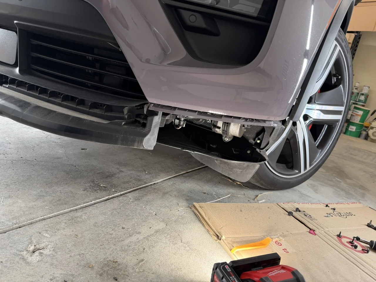

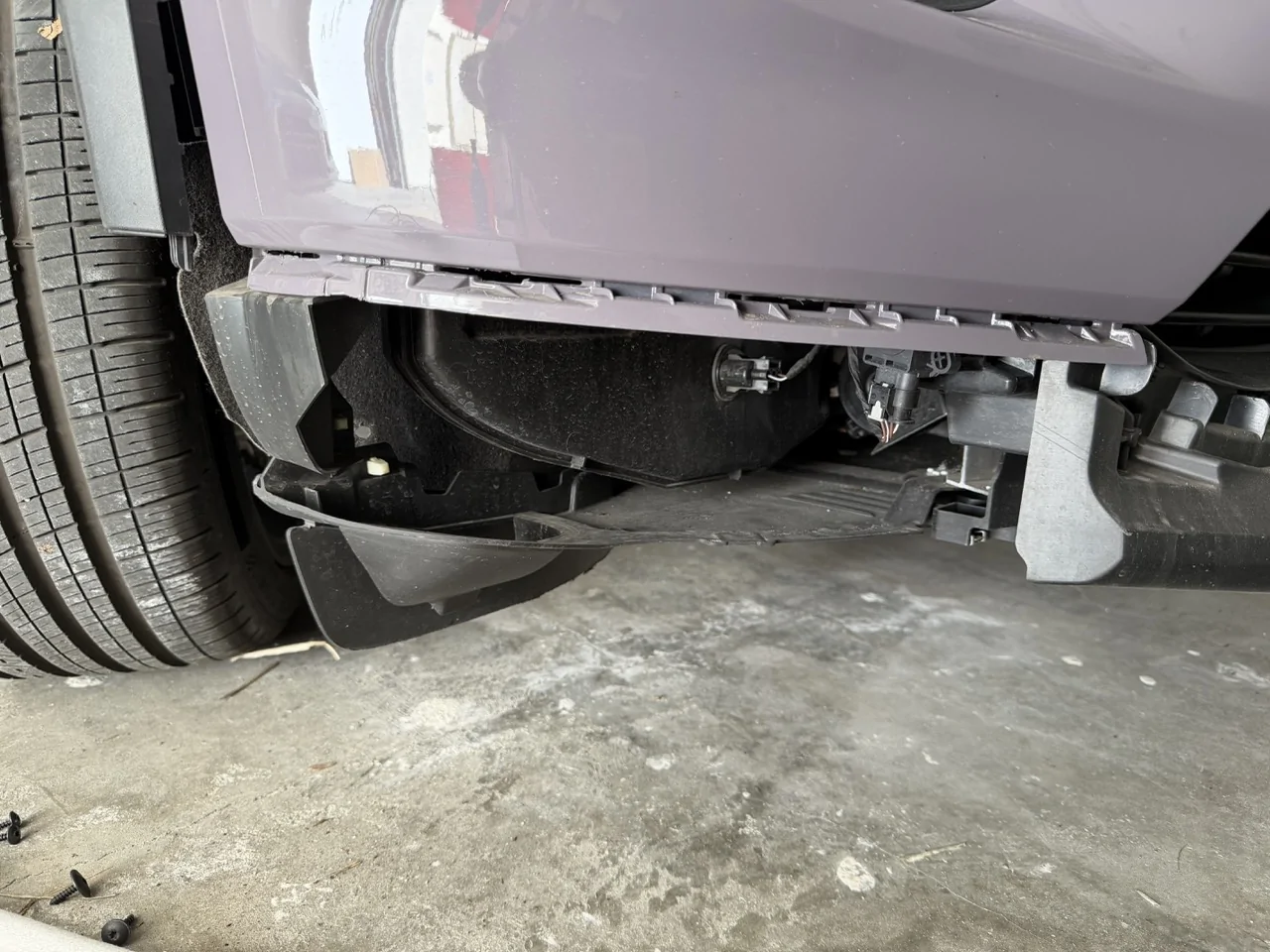

I did it!
This time I pulled much harder than I did before as I was a lot more careful the first time. I got my gloves on and pulled it really hard and it came off.
Fitting the new one in was also much harder than I thought. There was a lot of pulling and pushing to make it fit right. It was a pain to align the tabs because it was a stretch fit. I had to take it off again because the middle tabs weren't latching properly, but after it came off once it was actually much easier to release the tabs, due to the slots loosening or a bit broken in.

so you didn't take the belly pan off to release them from the inside?
No, you can pull it out when pulled hard enough. If I had to do it again I can probably do it under an hour.
