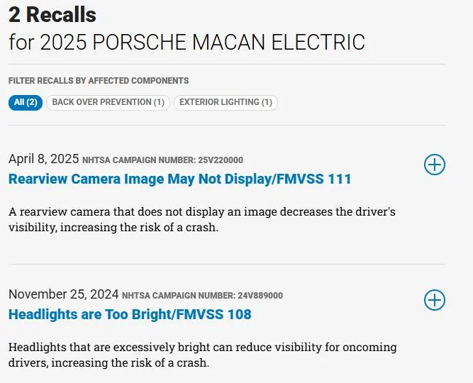

Had a similar occurrence yesterday when I was about a mile from the Porsche dealer and so I stopped in. They told me of a new recall which came out that morning which my SA believes will take care of it. It's a big fix though so she said it'd take several days.
Anyway, you might want to see if your vehicle is affected as well, but I got the impression that it was most of them.
It was something to do with a whole network upgrade for the car.

a new recall campaign specific to the cluster? Maybe your SA was lumping it in with the software update that is being applied for the rear cameras...?
only seeing the two

No, she listed the camera campaign as a second recall I needed addressed.
the cluster malfunction (which is why I stopped in) was definitely different.
humorously, when I went to leave the dealer (they couldn’t do the updates for a few days as it turns out), everything was working again.
