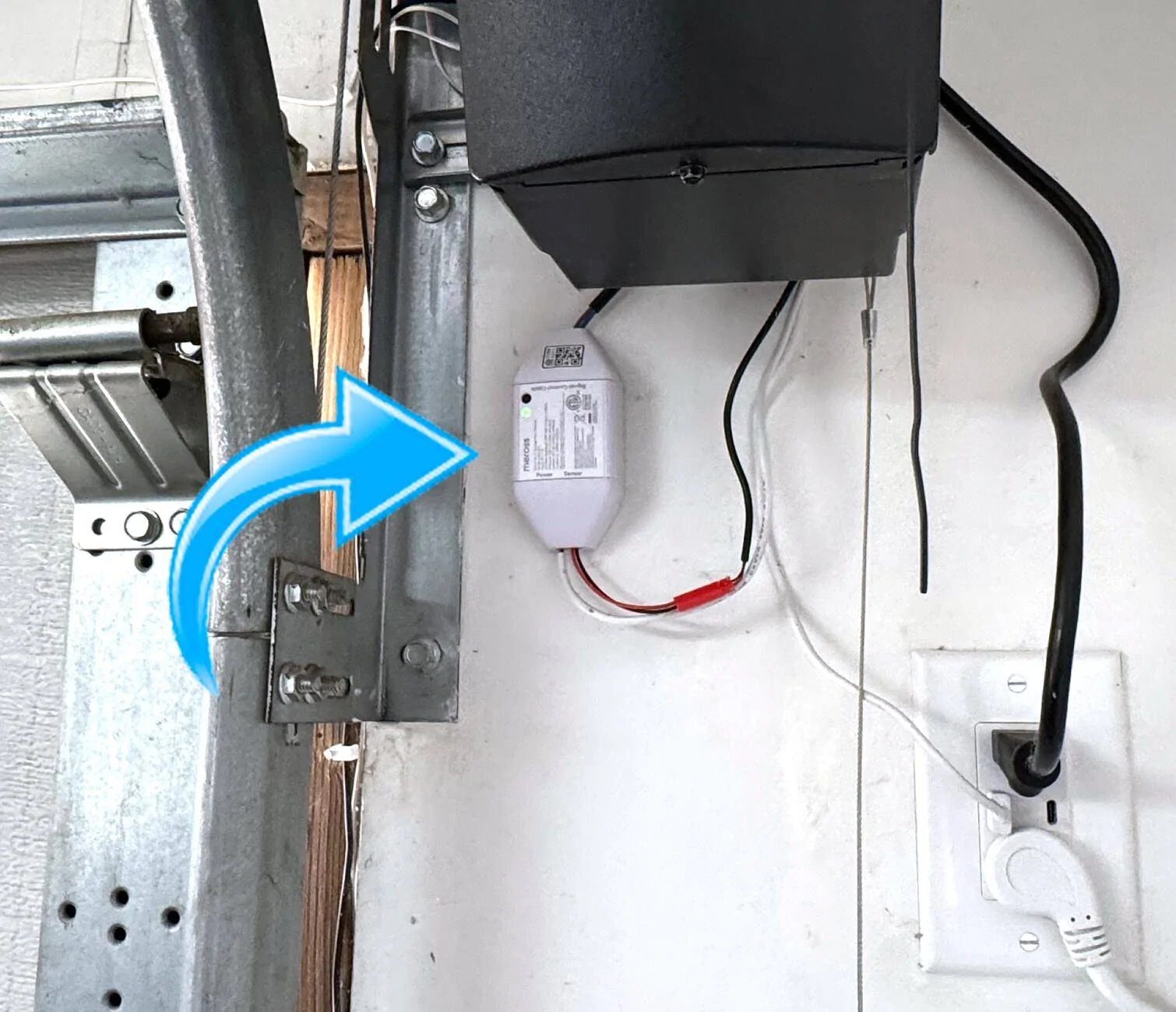

Only used homelink a bit before I installed a Meross device - (Amazon description)
"Smart Garage Door Opener Remote, Compatible with Apple HomeKit, Amazon Alexa, Google Assistant, SmartThings, Multiple Notification Modes, No Hub Needed" It is an interface between the garage door opener circuit and your smart devices.
Works great and shows up on the CarPlay Home Screen as a status widget ('Garage Door Closed') as well as my iPhone. I can open the garage from anywhere - I usually open it when I am about a minute out; have it set up so a series of overhead lights and a workbench light turn on / off with the door opening /closing. Runs about $50 on Amazon.
