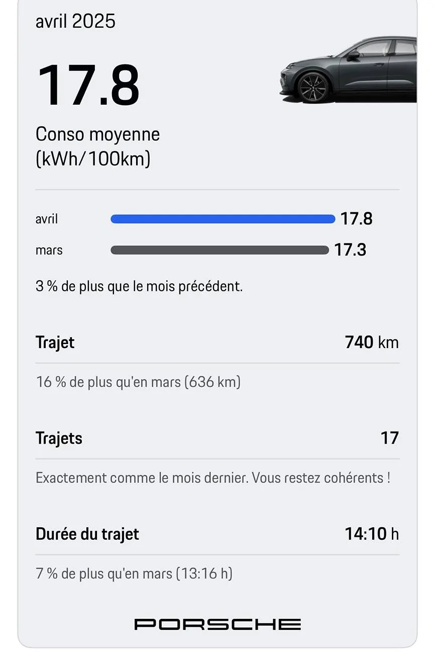

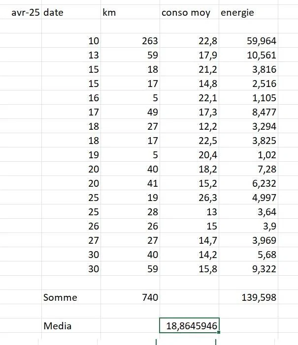

Same for me : April 17.8 app 18.9 PCM data +6% (@PaoloPix + 15%)
But: March 17.3 app and 17.18 recalculated PCM data ???

with my Taycan, the total consumption (continuous odometer) was very false (optimistic); perhaps same thing with the Macan ...
Please note: if actual energy consumption becomes negative during a trip, for example, in the mountains during a long descent at the start of the trip, this negative value is not displayed, and the trip consumption ignores this regeneration energy.
Only the "consumption from charging" value takes regeneration energy into account.
I've often observed this during a round trip to a ski resort.

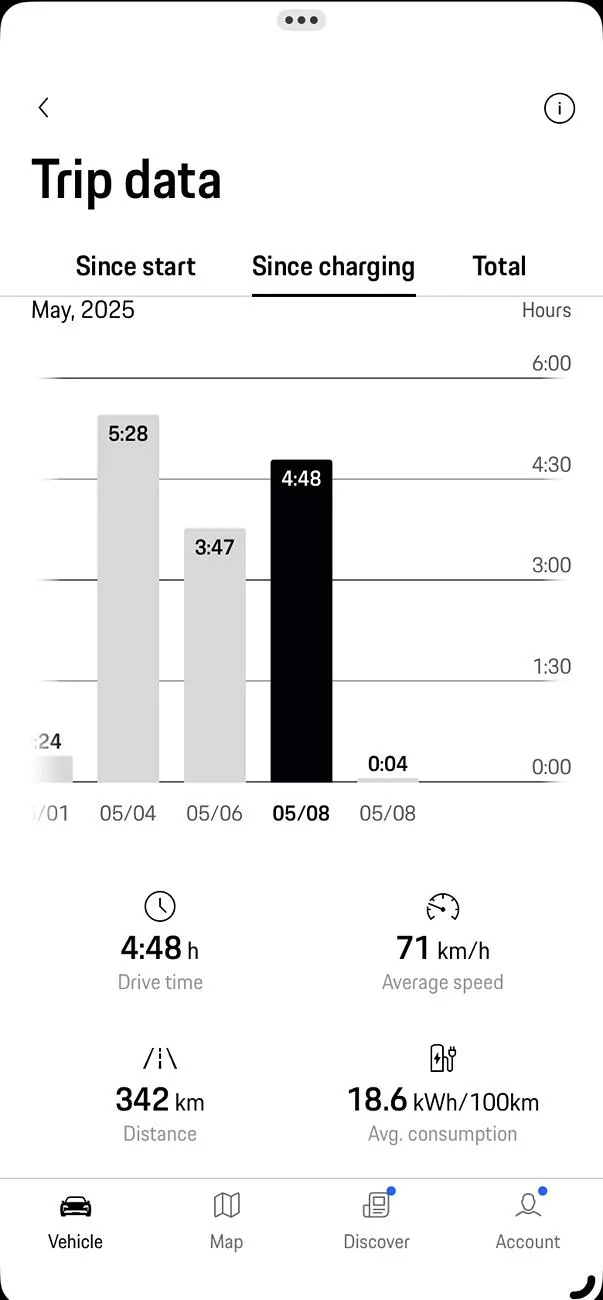

So today I did a trip Antwerp - Amsterdam - Antwerp
-Departed with 100%, 9C slight headwind, average speed 85km/h 20.2kwh/100km consumption, spend 36% so had 64% left.
- Returned with 64% at start, 20C, slight wind in the back, average speed 61km/h (traffic jams), 17kwh/100km, spend 32% so had still 32% when back home …
Whenever I could, I drove 125km/h in BE and 105 in NL … anyway if I calculate and did no mistakes, the total usable battery is around :
18.6*3.42/68*100 = 93.5kwh … not bad as there is like a 3% heat loss in the battery …
It also means the real range in ok conditions of a 20 inch Potenza tire Turbo is for this kind of driving around 500km’s … so if you go 130km/h 350km should be in the cards (10% buffer ?)
PS at the start it showed 540km range but that was with warmer conditions GOM and no head wind I guess so actually pretty close …

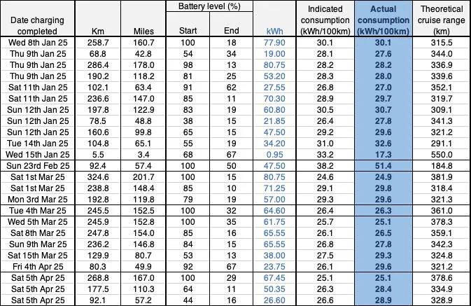

I'm a nerd when it comes to driving data. These are the figures after every charge. There are some outliers where I've only driven for a short distance between charges, but the indicated consumption can be anywhere between exactly correct to nowhere near.

very nice & neat. but is it not obvious that the “indicated” consumption is near always the same (or within statistical error) as the “actual” when the distance is bigger than 50 miles?
i do not see any proof that your calculations are more accurate than the ones the car computer is doing. there are a lot of variables that are not accounted for like is the odometer correct ? is the charger correct? where is the data in the “battery level” column coming from? most significant why is a computer supposedly sometimes right und other times wrong and you are always right? my experience with computers is that you can trust that they repeat the same calculations always in the same way.
anyway i really do not care and i am to lazy to calculate the sum of the two columns. but i bet that difference is not significant for operating this vehicle.
