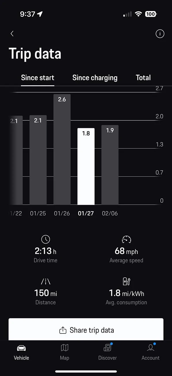

I’m reading all of these posts and starting to think something is wrong with my car. I’m in the Northeast US and it has been under or near freezing but lately I only get 150 miles with a 95% charge and I have to slow down in the last 30 miles. It’s a Turbo with 22” and winter tires. For European folks the last 2 trips were about 35kWh/100km. Not sure what I’m doing wrong but it’s not going to work for me. Any advice most welcome!
You seem to be going pretty fast, that will eat at the battery like crazy.
If the average is 68mph, how fast are you actually driving? 80? 85? 90?
Anything over 65-70 and the range will take a severe nose dive.

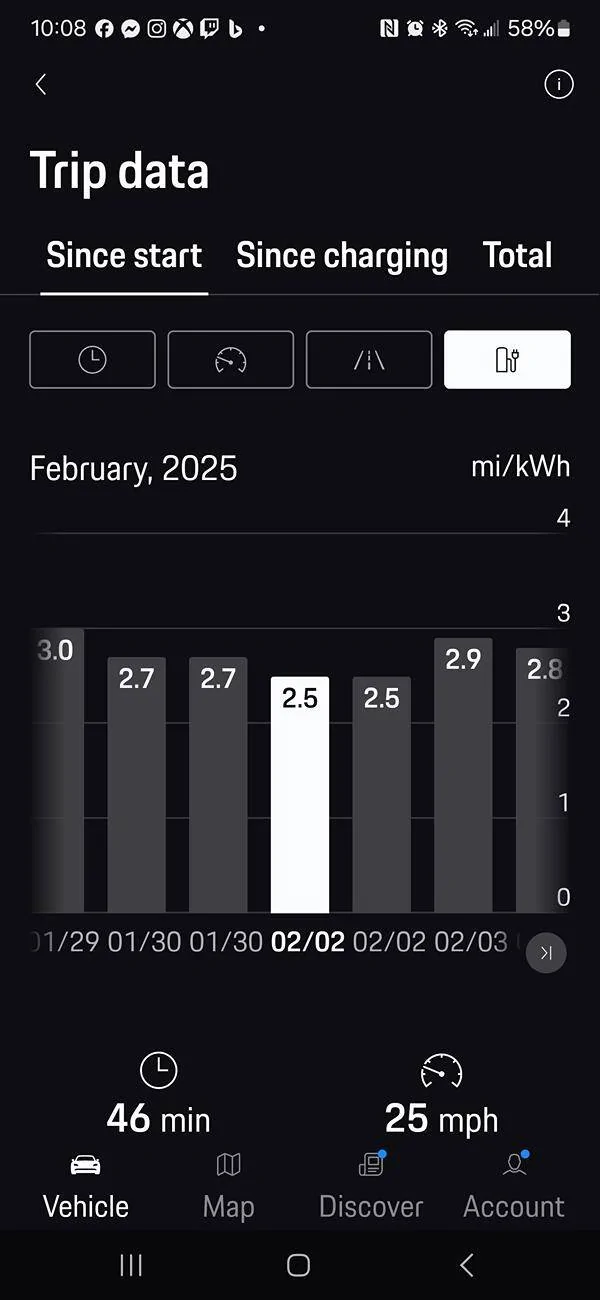

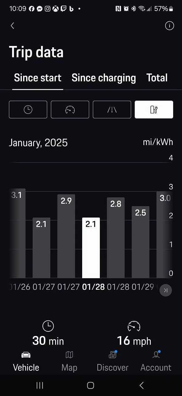

you also have the worst set up for range... turbo, 22's and cold...
I'm also in the North east with the cold, but i'm not driving as fast and i'm only on 20's (for now)

Thank you, this is useful - I know I have a pretty bad setup for range and I do drive fast, but never thought it would basically cut the advertised range in half. I replaced my ICE Macan S (best car I ever owned) with this thing for winter driving to my Maine shack exactly 150 miles away until it’s time for the 911 to come out of winter hibernation. Have to say it’s an extremely cool car but if I have to drive slow for the commute, maybe I should get a Prius. Idk - definitely not what I expected.
