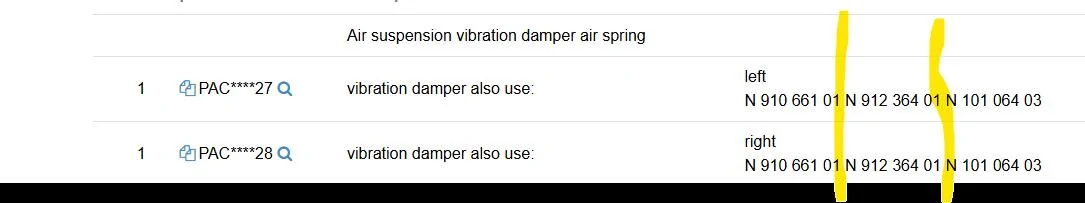

hmmm maybe there's different dampers for the rear...
when i check the part listing for suspension. there's only 1 strut listed for the front, spring or air...
but for the rear, it appears there are 3 different version for each L/R side
Electric Macan EV Macan 4 dampers vs Turbo dampers 1747698979816-n
