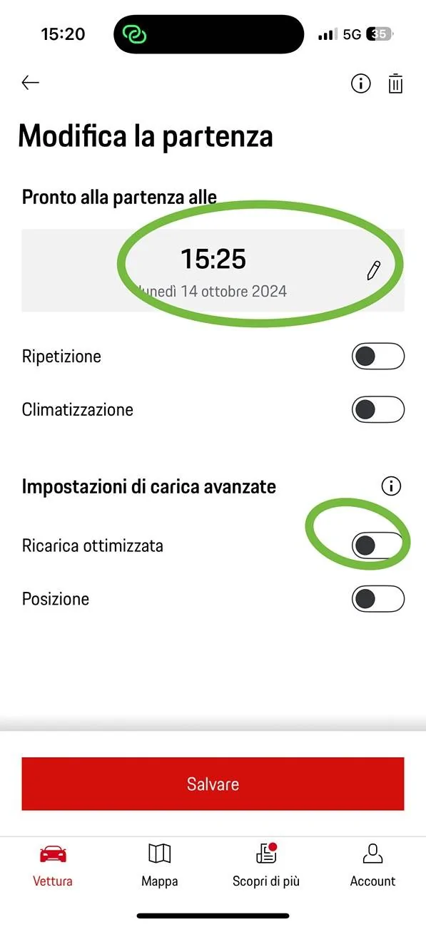

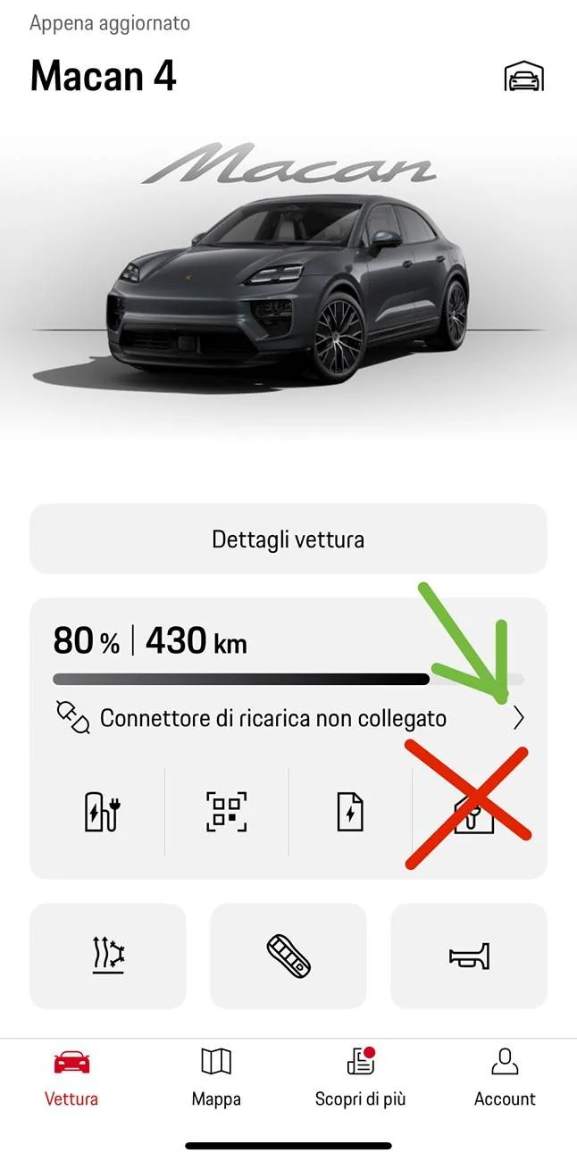

Thanks for your review. We just got ours and are having a nightmare trying to remote charge it from any app. We have a BP pulse mark 1 7kw charger so there’s no app for that where we can set the charger to come on at night. We can’t use Octopus intelligent go because the Macan isn’t on there yet so that doesn’t work. And we can’t seem to use the Porsche app to set the timer as we’ve been told it won’t connect to anything other than a Porsche charger. So it’s on to charge when we want but we can’t seem to set a timer anywhere ? I’m sure it’s user error and there must be a way. Anyone know please ? Thanks

To plan a charge you have to use the charging planner (green arrow) and NOT the charging station section (Red Cross).

Plan a charge setting up the day and hour and if you have lower rate at night you can select the advanced option (“avanzate” and "Ricarica ottimizzata" in the pic) and set the start and finish hours).
Electric Macan EV Macan 4 EV Detailed Review: 3 Days After Delivery IMG_5266
Electric Macan EV Macan 4 EV Detailed Review: 3 Days After Delivery IMG_5267
Save and send it to the car.
