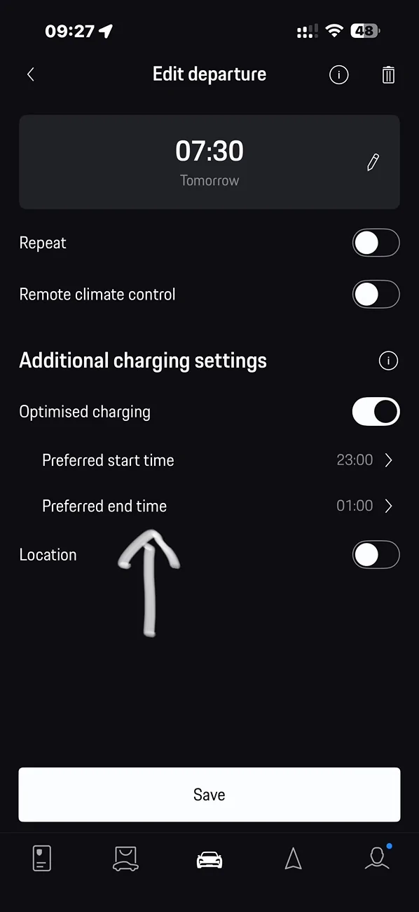

To set the timer from the car to charge from 11:30 - 5:30 just set a departure timer and select Optimised Charging (manual) to set the above time. Should then charge within that time period provided that is sufficient to get the car to desired percentage by the set time.

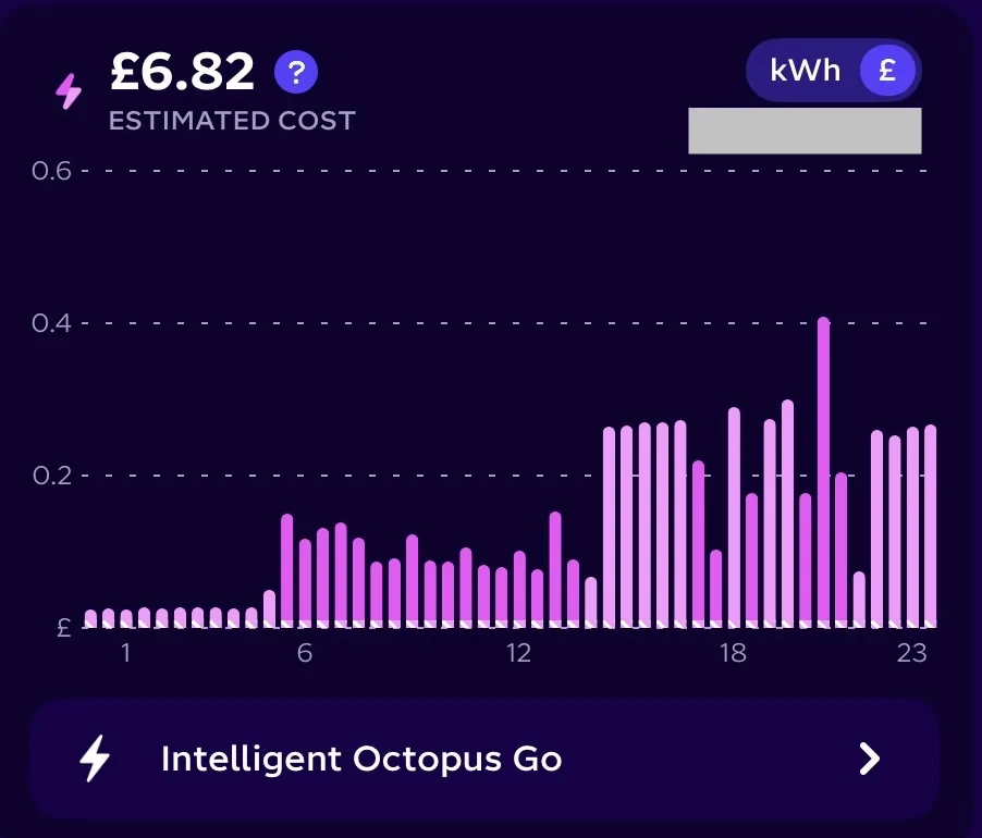

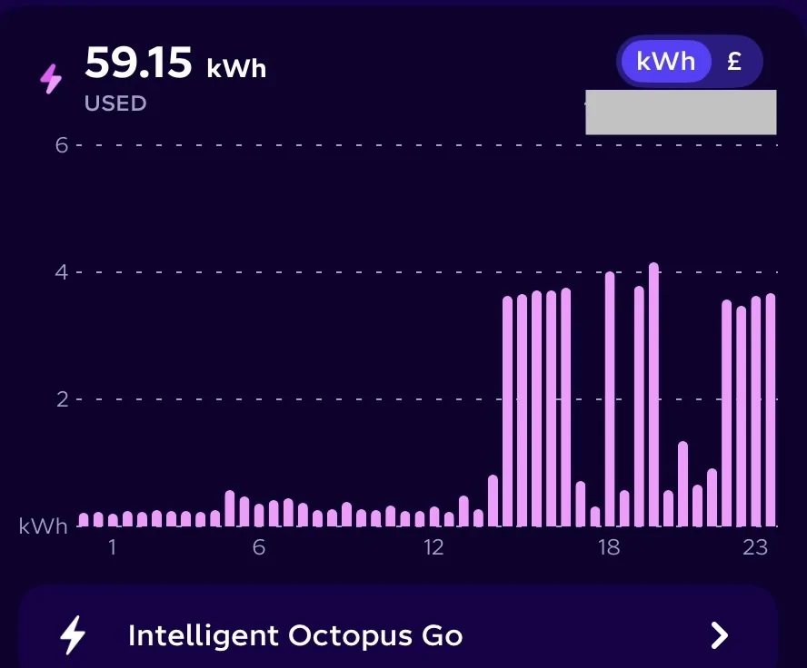

I had that issue on my 4S when I first tried to connect up in April. I just used the alternative, which is to let Octopus decide when to charge and have the car set to charge whenever it can. I has worked very well and I have never wanted to change the car to be the boss. I can usually get 70Kw or more in if I plug in at lunchtime-ish by the next morning as even in winter, it will charge at odd times way before the official 2330 start. See the attached picture for all the charging i got done back in January.

just to add that I have just plugged in on 25% and told Octopus I want it charged by tomorrow 11am (the latest you can set). I said 11am so i get the best chance of filling to 100%. You will see I am already getting a short charge, and that has changed since I originally plugged in about 30 mins ago. All of this is at 7p.
On sunny days in the summer I have known to be fully charged by midnight.
